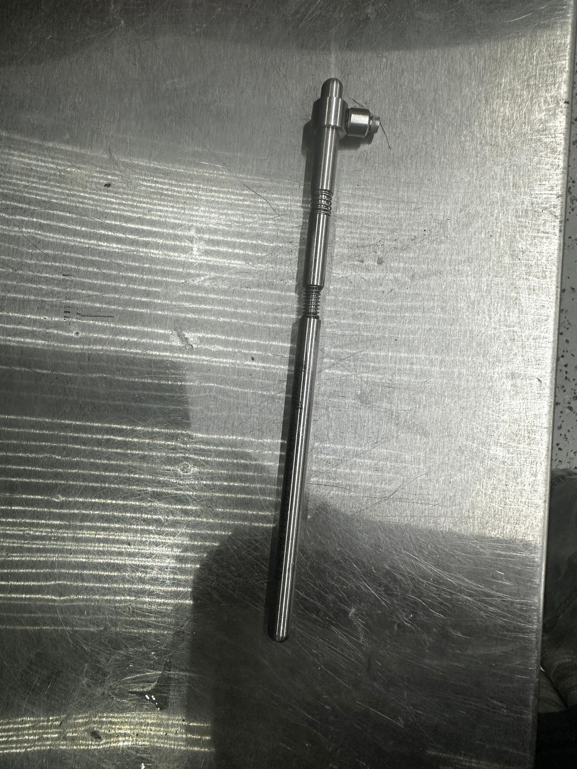

Pushrod length with 2116LSR ,LS7: did heads, lifters and new pushrods over a year ago. 505hp to the wheels . Stock cam, headers, no cats. I measured my pushrods at the time and ordered/installed. Been running great. It’s a sewing machine like a typical LS. I assumed maybe I had too short pushrods and maybe I could tighten them up a little bit. I had the transmission out, waiting on parts so I decided I would re-measure but this time I used a spring loaded checker with a set screw to get it as accurate as possible. The 2116lsr preload is +.045 on a cold motor. With the new checker I’m getting +.069. Is 2 hundredths of an inch too long really something worth getting new pushrods for? That’s about the thickness of 4 sheets of paper. I can’t see that as a problem but what do I know?
