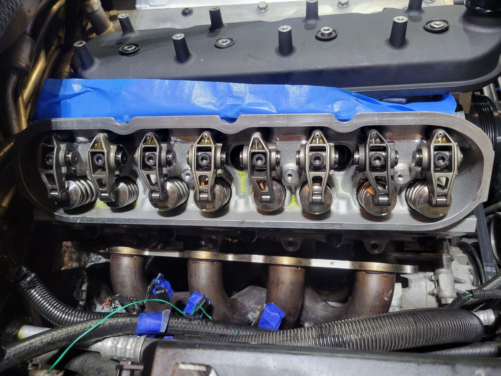

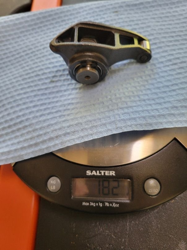

The BTR site says keep the spring pressure below 430 pounds open on the OEM rocker arms. I have the TSP rocker arms and they weigh about 9 more grams over the nose than the OEM part of that is the little wheel. Here is the pattern I got from the roller tips they look pretty good. The TSP rocker arm is about 30 grams heavier than OEM but about 15 of that is the all solid shaft vs the partial solid shaft of my old ones which were OEM with bearing upgrade. So TSP is about 15 grams overall heavier of which 8 or 9 grams are over the valve. Tony Mamo recommends the roller rocker on the LS7 due to side load and higher spring pressures waring out valve guides quicker. If you run 500 pounds a roller rocker should be used. Also OEM has a .660 max lift but you don't want to be at max so maybe like 630-640 as a safety margin. The valve noise also seems to have been reduced. I was running 470 pounds on my Brodix BR7 heads. One would say the OEM pedestals flex at higher spring pressure the Brodix do not as they are a blob of aluminum with a cut out. I also did not have to change pushrods as the preload ie 1/2 turn stayed the same (with 1/16 of a turn). I run a .660 lift hydraulic roller 246/258 at .050 but have titanium valves and hollow exhausts so my valve weight is 85 grams - so another 8 or 9 grams is not as much of an impact. I run a PAC 1207. Here are some photos.
