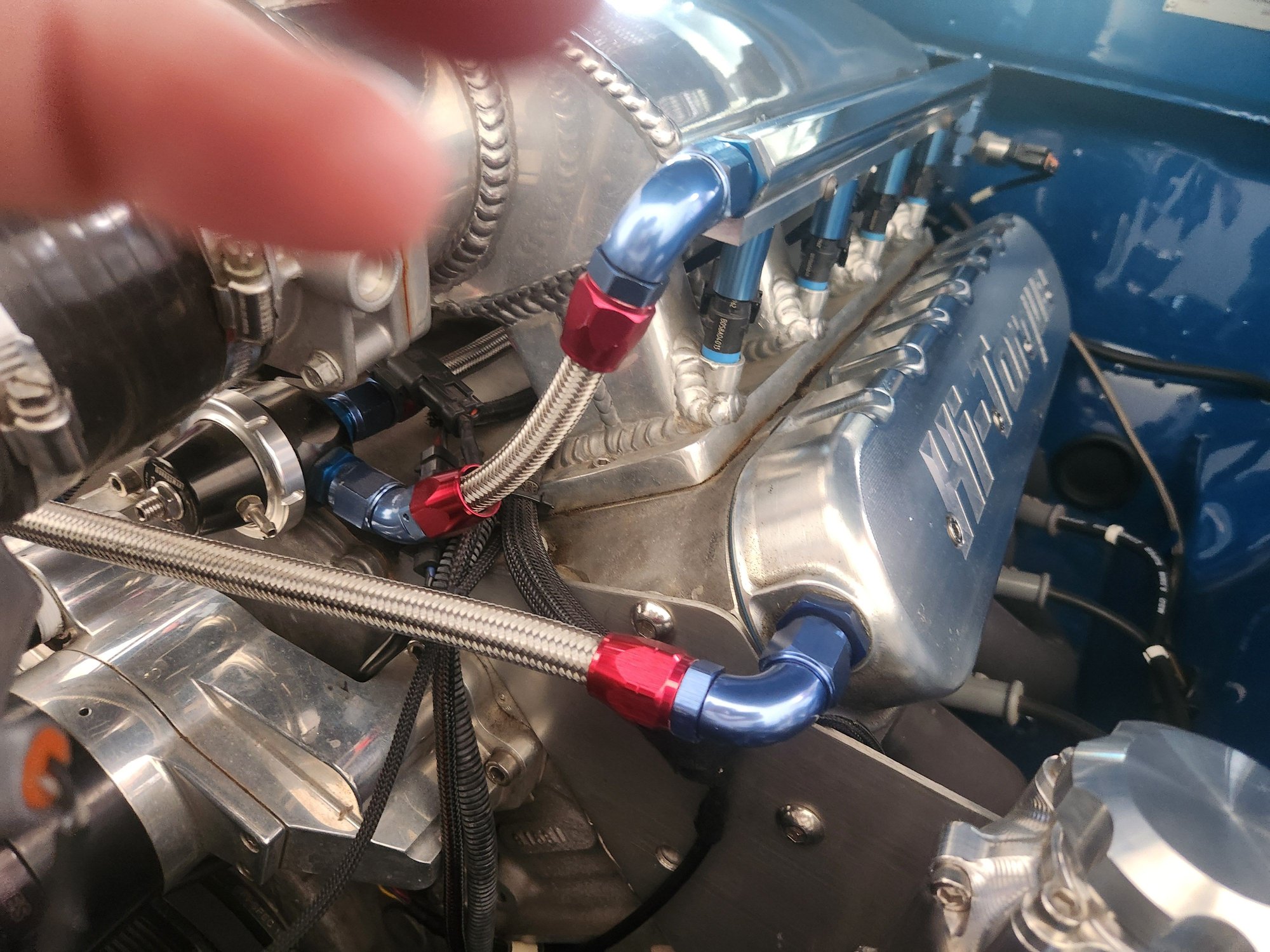

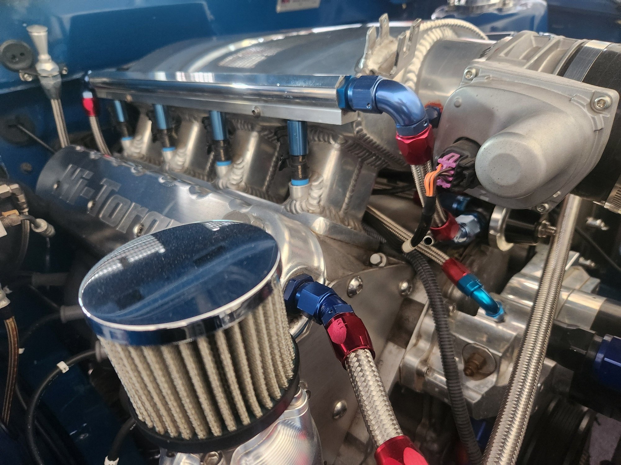

Id like to pose a question and see what you guys think if possible, im from Australia and have a 6.0 with 235/243 camshaft, Ls3 cnc ported heads th400 with a 5500 stall converter and 4.11 diff gears and a very short runner intake from my measurements the runners are 3.5 inches long at best. The car makes 430whp at 7250rpm and a current best of 7.1 sec 1/8 mile 98mph and 11.0 124mph 1/4 mile with 1.6 60ft. My question is do you think and ls3 manifold would yield any better results at the drag strip? considering it should have a much better average power until at least 6000rpm.

Post more info on the whole car/combo. That intake is not doing you any favors with those heads/cam. Stock intake would be better for sure, but how much hood height do you have? Might consider a LSXRT, too.

Thanks for the reply mate, the car weighs 3150 lbs when I race it with 235/60/15 et streets. The manifold is an original hand made sheetmetal from shauns custom alloy so I don't have the specs. I don't have the room for much of manifold an ls3 oem would fit and from my measurements one of those new summit efi low manifolds would possibly fit.

As DualQuadDave mentioned, this intake (or any other that looks remotely like it) is losing a lot of low and midrange power.
The LS3 stock intake would gain power with your setup. And you did say it would fit. I would switch back to it.

Yes, def go with a stocker. Call GPI, they have ported stock LS3 stock intakes ready to go. That is your best bang for the buck. That cam you have isn't great either, but one change at a time. I would crank up the compression, too. What is it at now?

The ls3 intake will make better overall power, but with a 5500 stall under WOT your gonna blow right passed any advantage the LS3 intake would give.
What RPM are you shifting at? Those short runner intakes generally pick up power passed 6500 over the stock LS3

FAST LS3 with BOTH Standard & Mid-Length Runners.
Standard for the street, Mids for the track.
Mids will work much better at the track given your stall & cam,
Standard much better on the street.
Easy quick swap.
