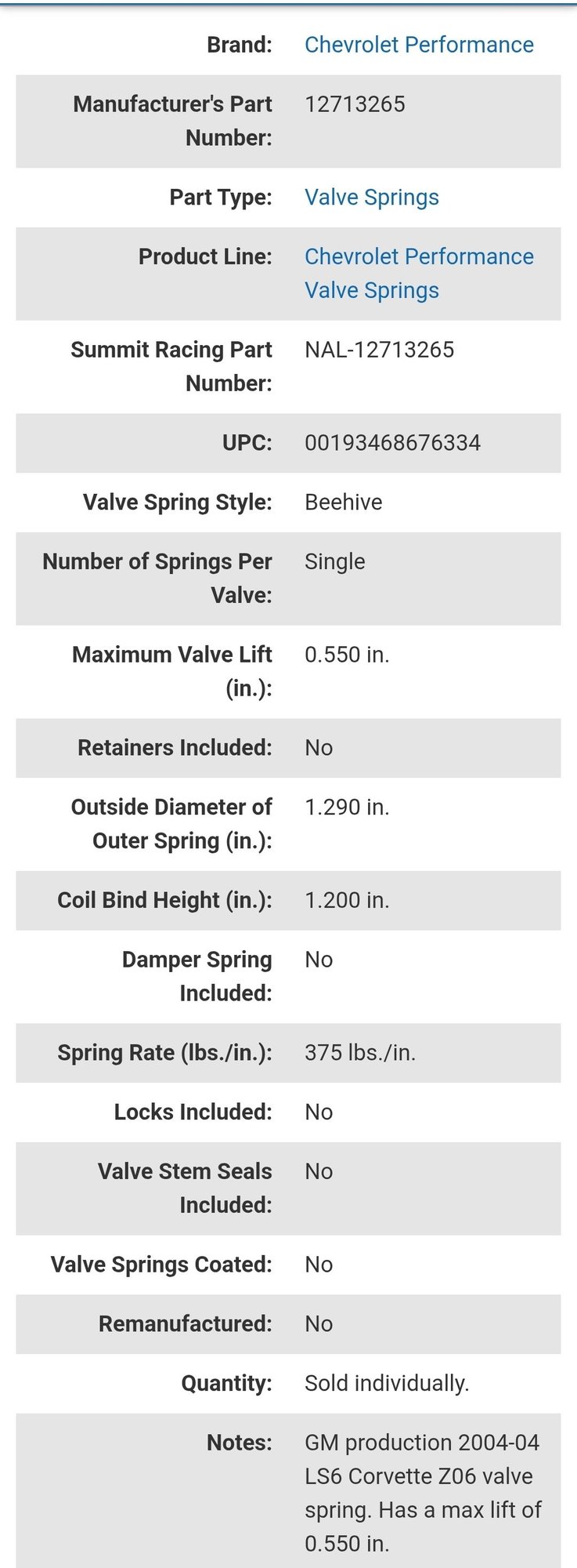

you are actually correct. I looked up the OE GM springs on rockauto for 04 gto, which also uses the cam you mentioned. They are listed as L97 and L92 springs when I look at that part number on summit, they say good to .520 lift. These would likely would still work for .525 lift cams.
if I look up the OE gm springs for 05 GTO, which uses ls2/3/6 springs, and find that part number on summit, they are described as ls6 springs good to .550 lift.
