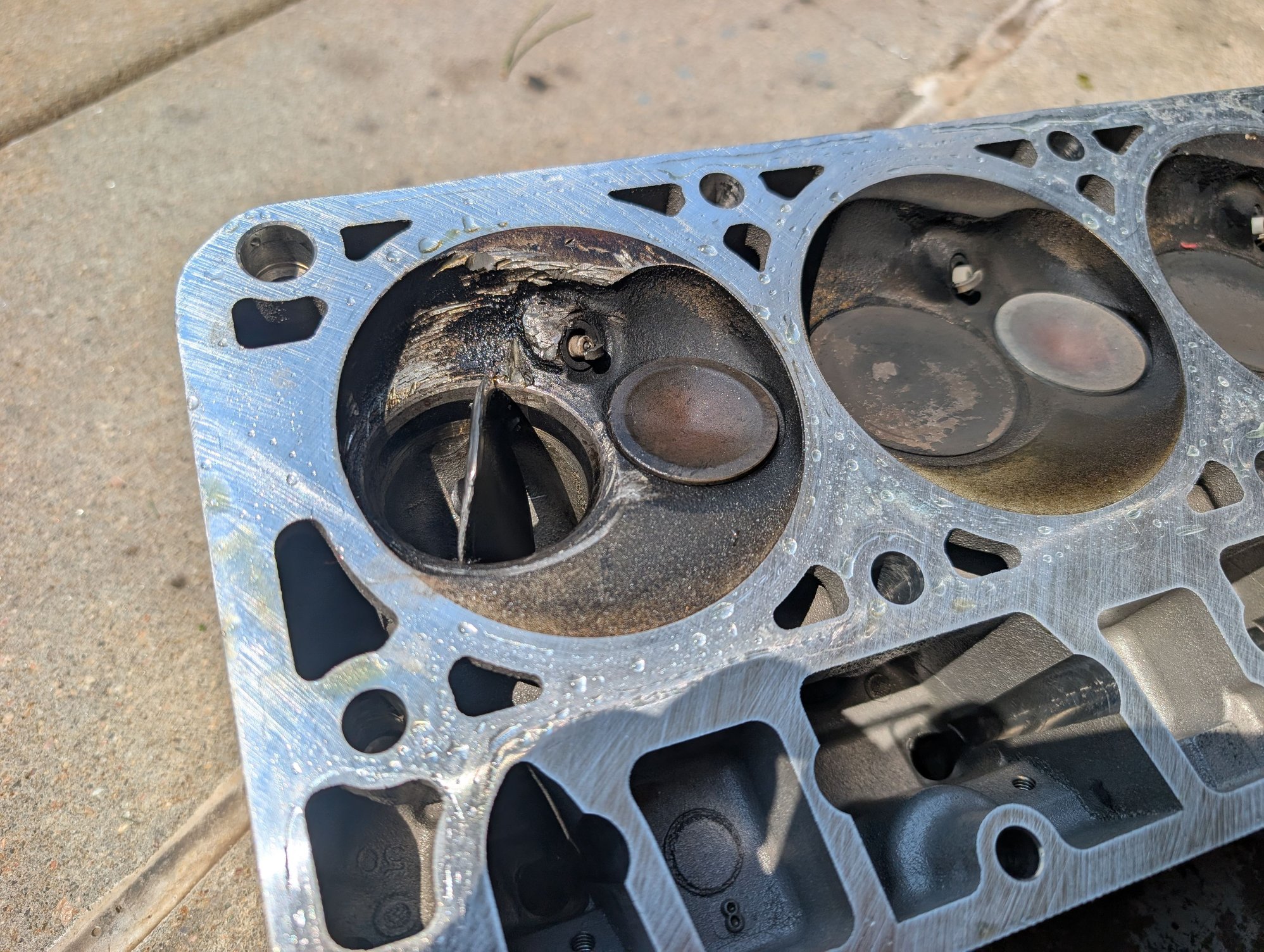

Unfortunately I'm at this juncture due to a 1218 or 1219, don't remember which for certain, that broke and dropped a valve. Found the stem in the intake port, so I'm guessing the head is trashed too. Praying the piston and block are good.
I did buy 1218X springs before starting teardown, but if I'm buying heads I kind of like the added security of doubles after this debacle. Brand new forged short block, heads/springs only had 7k miles on them prior to being reinstalled and failing after about 200 miles....Still breaking in- Never made it over 3k rpm with the new short block.

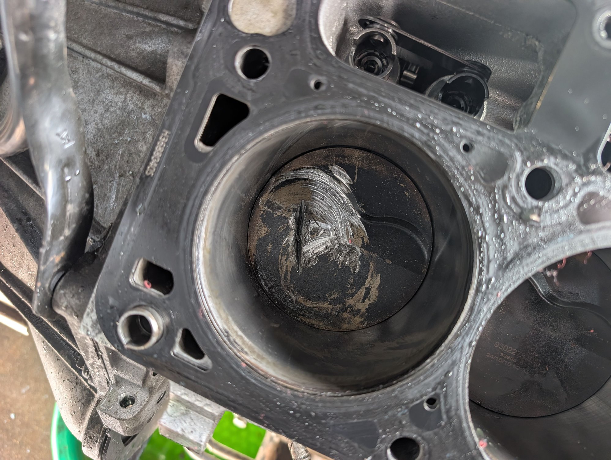

Definitely replacing heads. And a piston..... Just pulled the cylinder head. Mahle 4032 forged took it like a champ I guess.
