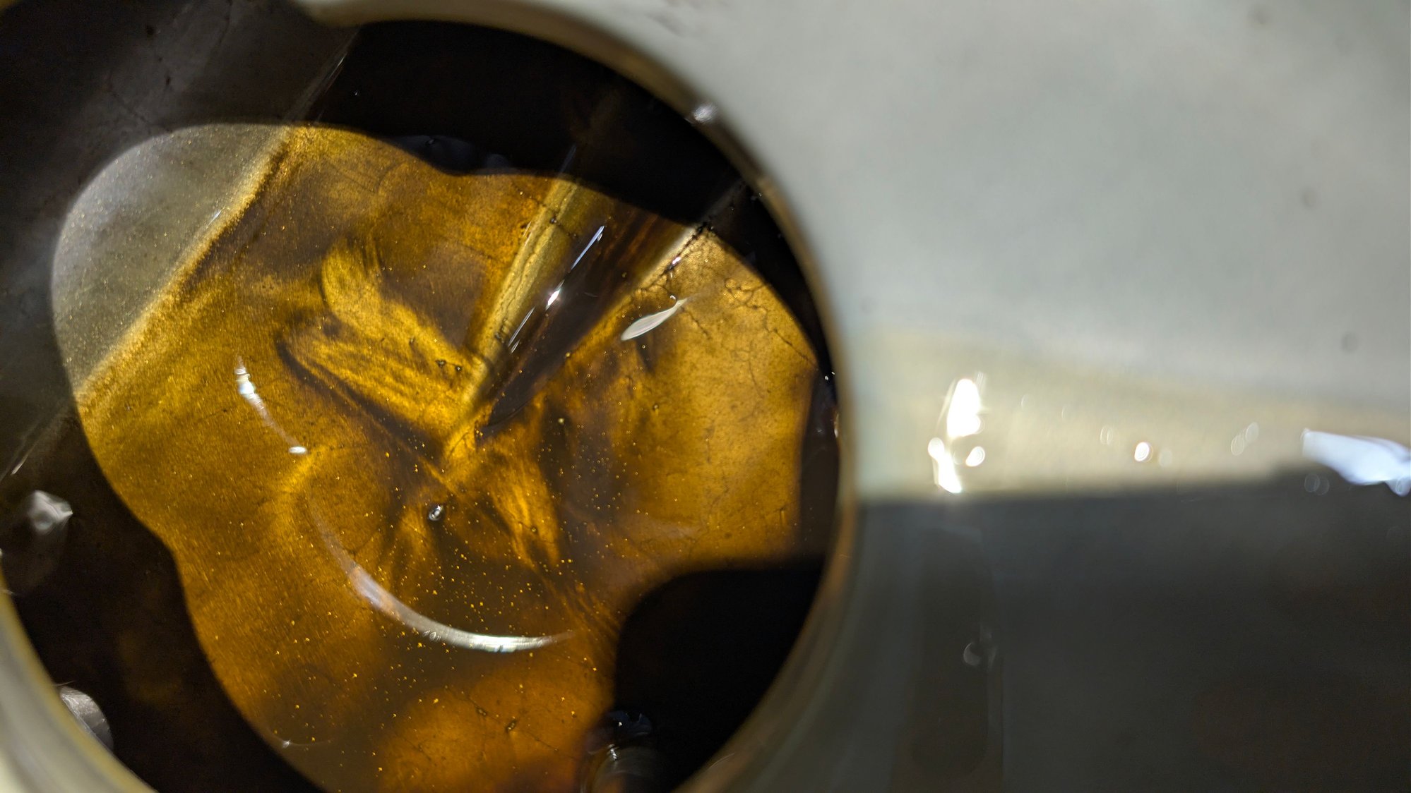

Finally got to tearing the engine apart; I found a worn cam lobe and some ferrous metal specs in the pan. I cut open the oil filter but didn't see any metal. Do you guys think I should still leave main and rod bearings alone?

That glitter is more gold than silver. If it were just cam damage I would expect more silver specs.
Personally, I wouldnt want to find out later IF it needs to come apart. I would do it now.

I thought they were gold/bronze too but they're silver, I can pick them up with a magnet. Nothing in oil pickup screen and nothing in oil filter pleats either which is odd.

If you are bit nervous I would pull a couple of rod caps and main caps to see if is not good. Now is the time since the engine is out and you have easy acess.

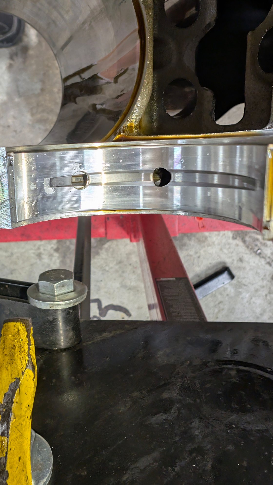

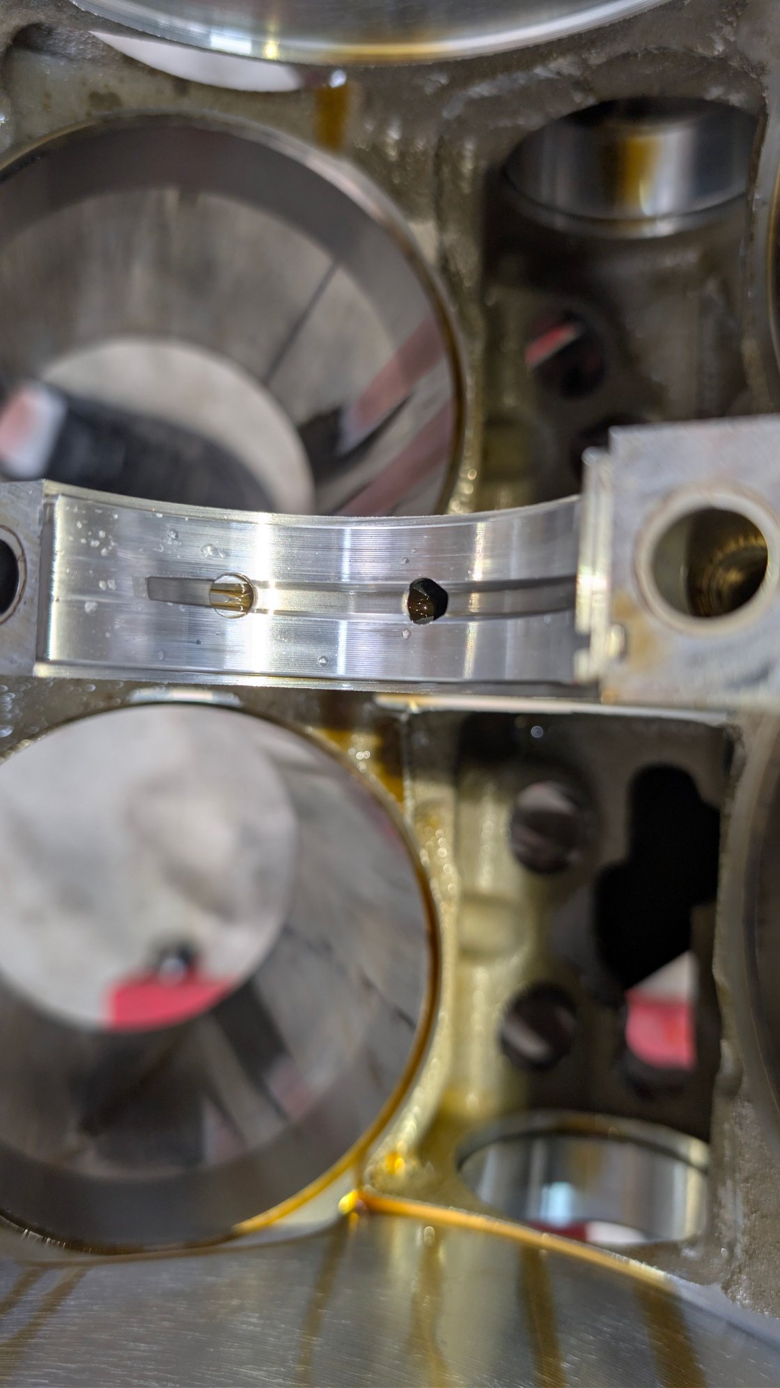

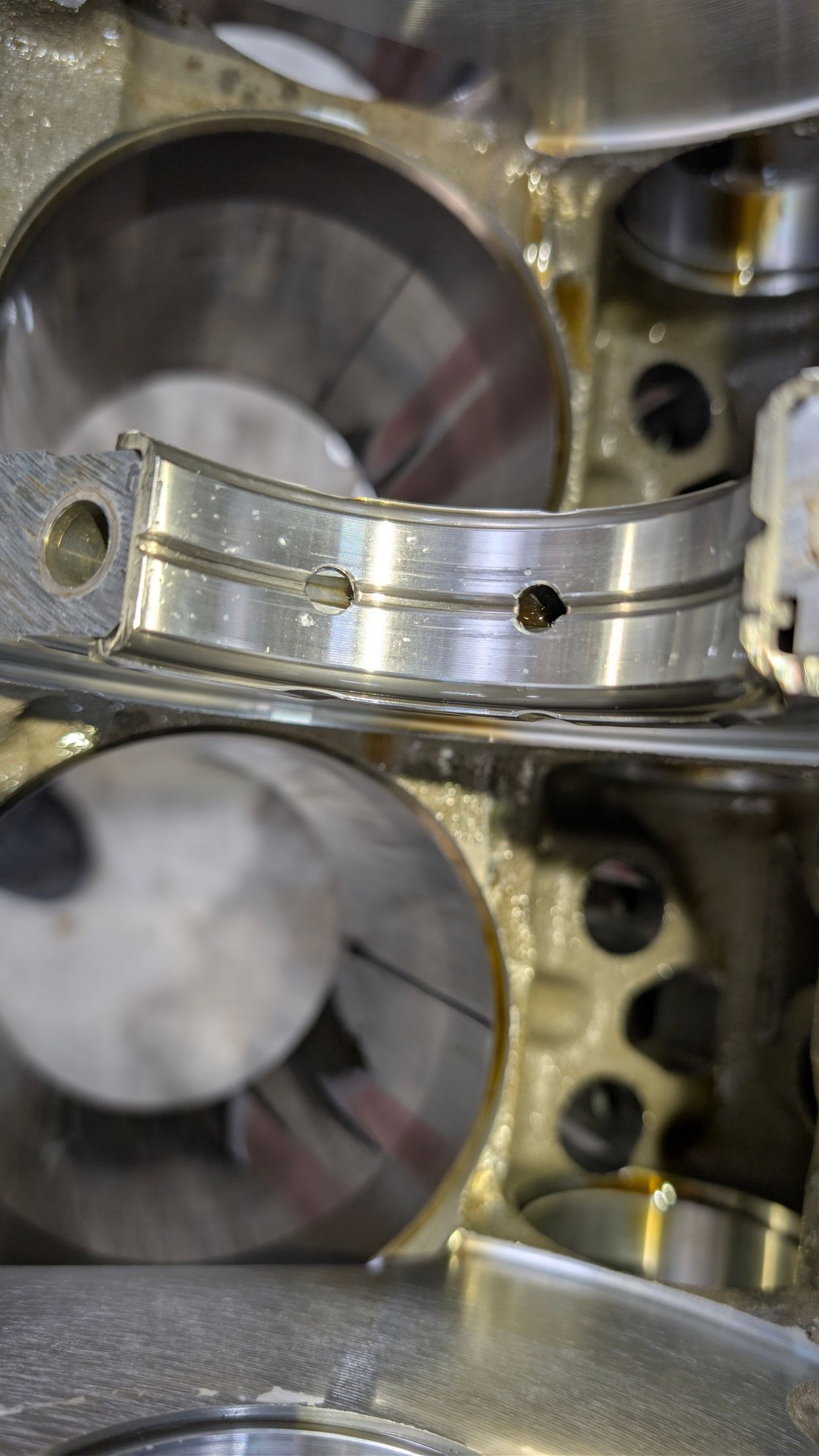

I pulled rods and crank; rod bearings look almost new but the mains have spots where coating is coming off? I'm really leaning towards putting some Mahle P-series bearings in it...
