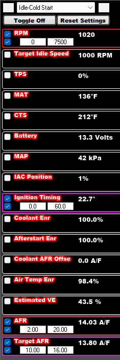

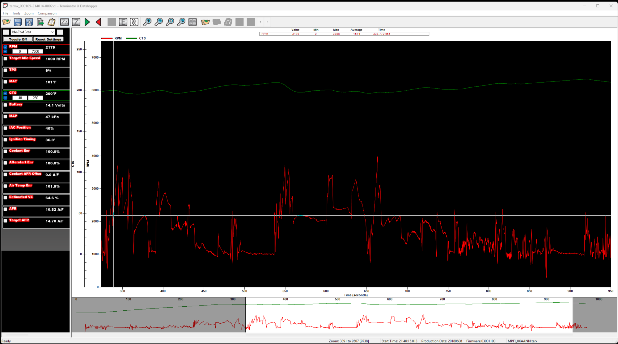

Hi, looking for some help, I recently finally made the swap from my 96 Lt1 swap to a LS based setup, and I'm running into an issue where at idle the temp continues to drift indefinitely 220+, however if I rev the car to 2k or so RPM it drops back down to fan temps (which is 195)
The block is a 6.0l Iron, heads are AFR LS3, LSXR Intake, SS2 cam, all 4 steam ports are hooked up, I started with a BBC radiator but switched to an LS Swap radiator with a shroud and a 16" spal that comes on at 195 1.25/1.5 inlet/outlet, the thermostat is 187, the accessory kit and water pump are from procharger (head unit not installed yet); Water pump is is a prw 97-10 high flow pump 1434607, I have a vintage air Sure fit system for 1st gen Camaro, it is plumed but I have not finished wiring it yet. Trans is t56 6 bolt
Best I can tell everything is bled, radiator is cap is the highest point and used a filler extension and also ran it a few times let it cool down completely and kept topping it off over the course of several days. I also have an overflow it can pull from, I tried bumping the idle spark to 20; Note the car is not tuned I've only ran the wizard on the terminator x so far. I am mostly testing it idling in the garage while finishing the wiring etc, I did take a quick < 10 mile lap around the block and found anything under 2k RPM temps are going up indefinitely even when moving but a quick blip of the throttle will drop it down. I've tested the thermostat and it does open. Previously with the last two motors I've ran electric water pumps, but I don't think that's an option with the procharger kit (they are checking);

what does the log say for actual idle timing? Setting it to 20 doesn't mean that's what it's seeing. It could be pulling timing to get to the target idle speed. Mine engine likes about 24 degrees to where it stabilizes around 180 degrees at idle.

Hmm, watching it in real time it's bouncing around 18-20, I'll log it tomorrow, update the post, and try 24 as well. I know when I rev it to 2k it will jump up to 36 and stays there with no movement.

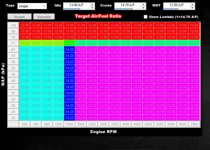

What's your target AFR at idle? Idle speed?

I haven't adjusted the target AFR yet, it's at the default, the idle speed was at 850 (and would like to return to 850), but I bumped it to 1000 to see if that helps at all.

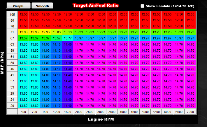

Try leaning out the idle to that ~14.7 range. That pump also may not flow too well at ~850rpm and that's why the temp starts to drop when you rev it up. That and possibly the added timing.

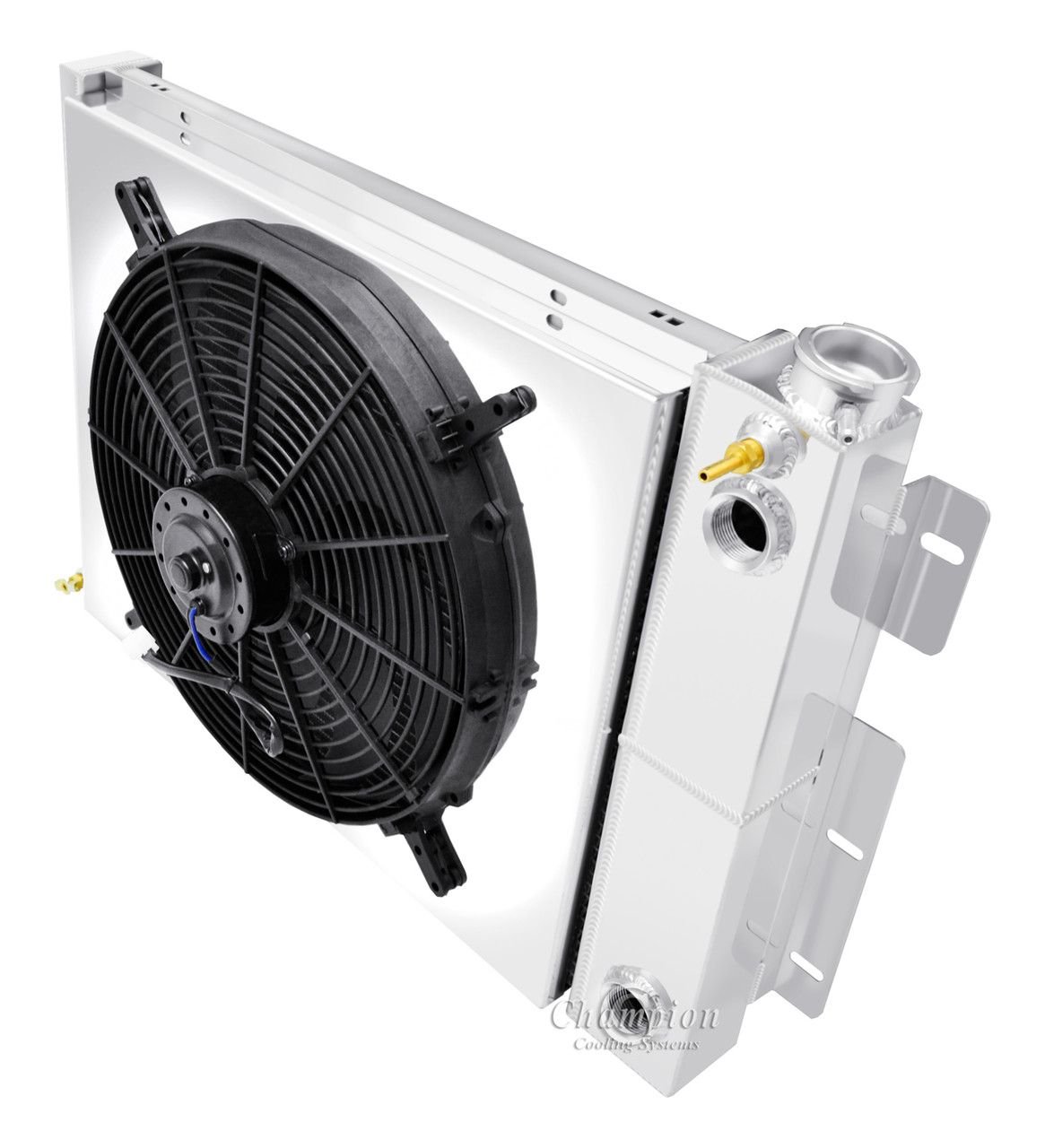

Do you have a photo of this fan. Which 16-inch fan is this. Is this the new 16 inch brushless fan or an older low profile unit. Maybe a photo might help. The fan on a 1967-1969 Camaro is pretty small so a good fan is a must.

You probably need more fan. I would try some other stuff suggested first. A nice double or the new brushless single would be good. If that is your set up above you need some flaps for when you are at speed to blow off excess pressure. Here are some examples. My fan core is 26 x 17 on my 1965 Chevelle and 24.5 x 17.5 on my C6 Corvette. The black shroud is a cut to fit shroud Spal / Dewitts sells - cut range is 22.5 inches to 27.5 inches and is 18 inches tall. Your GEN 1 Camaro is similar size. The issue arises not the CFM these fans are rated at but how much they flow with stuff in front of them. With h AC condenser radiator and an intercooler all in front you need a fan with some Big Block torque.

Thanks, I'll look into the flaps, in terms of temps, I'm not sure the fan is the issue, if I rev the motor it moves water which also in turn fires the motor more; which in theory then would overwhelm the fan if the fan was the issue instead the opposite happens and it cools down. If the fan (or lack of) was the problem I would think it would be go down at idle, and up above 2k rpm vs the opposite; all while not moving and pushing air through the radiator

As mentioned 13.8 idle is too fat.
Thanks we did adjust the target AFR as following, it seemed like it got better but it didn't resolve the issue.
