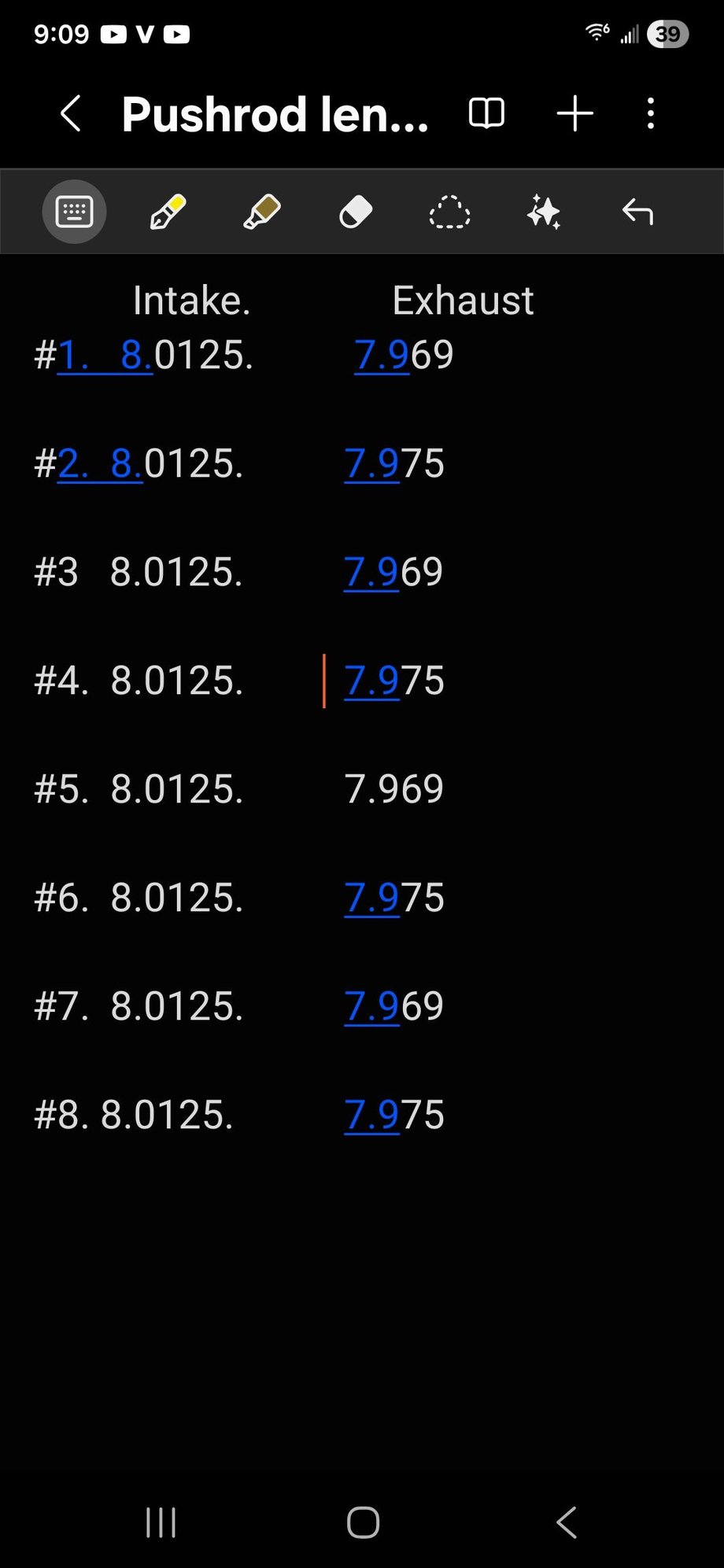

So with the new canted valve heads bolted on and new johnson 2116lsr lifters these are the measurements im getting. So just to clarify i need to add .035 give or take to the lengths?
Im thinking intake length of. 8.050
exhaust pushrod length of. 8.000

Yes, Johnson 2116 lifters require .035 preload plus or minus .010. Those lengths should work.

I add .045 for the 2116 lifters. Set them deep….allow for thermal growth.

im not sure how much thermal growth ill get, the car hardly gets over 160 degrees.

Hell just shoot for middle ground @ 0.040 preload, it's not going to hurt a damn thing. What diameter PR's are you planning to use?

An aluminum block will grow .010-.011 at 170. Closer to .015” at 210. Heads grow a bit also. A steel pushrod will grow .006” to help chase the difference.
Your oil temps will be much higher than water, so the block is going to grow consistently, irregardless of water temps. Add .045 preload. It will help quiet the lifters at temp.
I was just planning on running a Manley 3/8 .080 wall since they have 8.00 and 8.050 in stock at summit. But now with the discussion of thermo growth my preload of .030 and .037 with only end up with .020 and .027 preload. Im also worried about ordering too long of a pushrod and hanging the valves open.

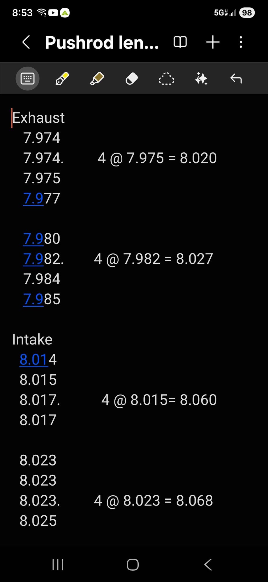

Used a different method to measure the pushrods and remeasured 3 times after that. Came up with these.
Looks about right. It’s bizarre how manufacturing tolerances play such a diverse range, but it is what it is. Order them! Manton turns them around FAST. Don’t forget etching!!!

It is not uncommon on LS motor for the pushrod on intake being different than exhaust. On the LS7 I think the lash cap on the titanium intakes can cause the delta. I have the medium travel lifters which have a preload of .025 to .045. My pushrods on my BR7 head motor are 7.940, 7.950. and 7.960. The intakes taking the longer pushrod. I have a single test pushrod of 7.900 which gets me close to zero lash (torque rocker arm bolt to 22 foot pounds) and use a feeler gauge to fine tune from there and then add the .040 preload. I stick with Manton for consistency. Che70velle has the right idea he builds a lot of these. What I have found is that last 1/8 turn or so final 22 ft. pound tweak does nothing for the preload.

I spoke with Johnson lifters today and they said preload will be fine anywhere from .025 to .045 and to get with Manton. I then spoke with Matt at Manton and he suggested just using my measured length plus .035. New pushrods will be here Wednesday.
