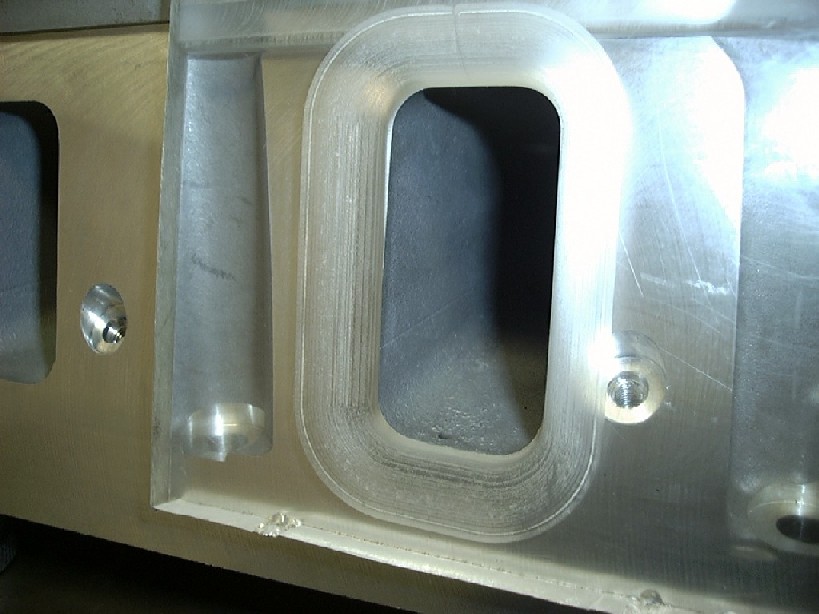

A while back I made a radius flow plate for testing the intake ports on the L92 heads. I was asked about this in a previous post and felt a picture would help demonstrate. I'm attaching the plate to the head with spring clamps because the mounting bolt holes intersect the radius. The plate is 1/2" thick and the radius is.450".
I could probably make a few more if anyone is interested.
Richard

sorry but i'm slow...what is the purpose of a radius flow plate? i can't really tell from the pic what's going on.

The constant radius leading into the port runner entrance allows smooth consistent airflow to enter the port when testing the port without an intake. Without any radius leading into the port we'd see a large drop in flow due to a chocking effect at the port entrance.

ahh, ok i gotcha now.
