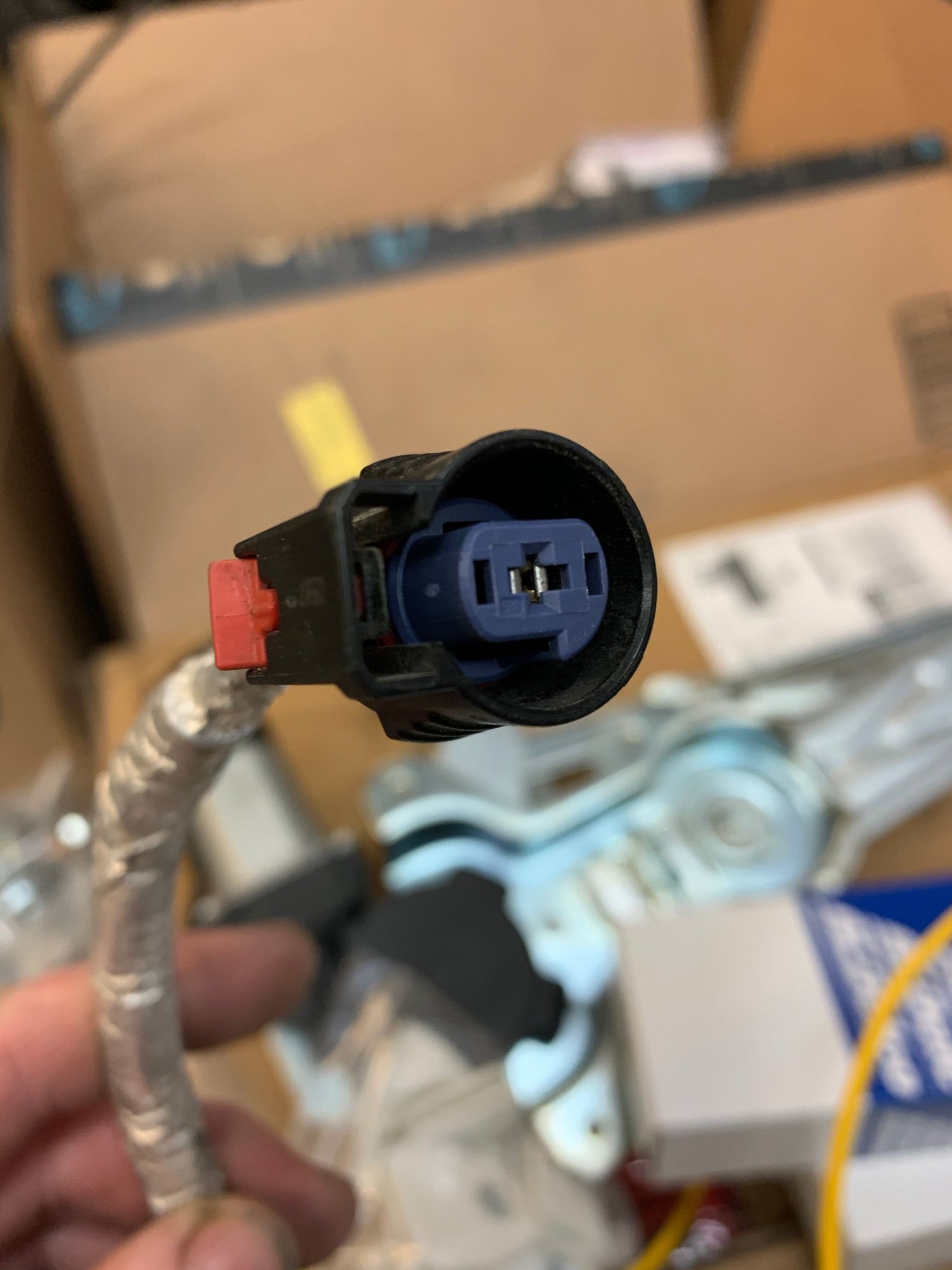

I've been trying to find the connector and terminals for my L83 starter solenoid and all I can find is a pigtail but I am doing a complete harness so I'd rather not have a splice in a new harness. Does anyone know what plug this is. I tried a weatherpack but it doesn't seem to fit and doesn't have the outer tube.

I finally found a connector, gotta figure out which terminals fit. Would be nice if they were Weatherpack terminals since I have about 600 of them haha. Anyone know?

Isn't one of these AMP 1-968859-3 or AMP 1-968857-3 first one is 14-16 awg other one is 11-13 awg.

Thanks, that's perfect. It led me to a new connector for about $5 as well. That part number is:2098198-5.
I was just about to order the other one, thanks again.
