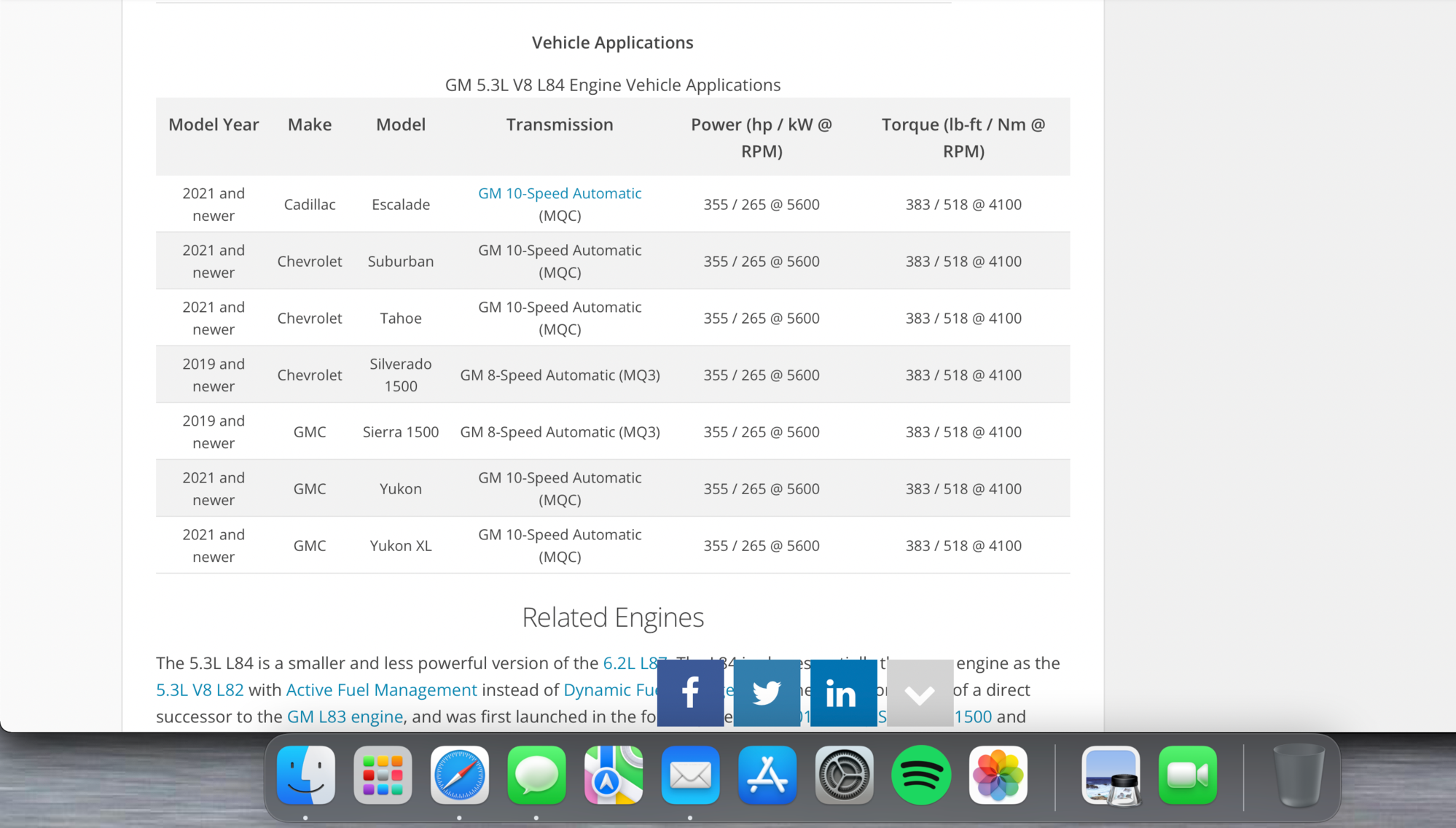

True, but if Lakewood specifically marketing it for all LT swaps it should fit without the need for clearancing. What manual was this in? GM authority lists the vehicles it came on, and they're all automatics?

Wasn't: this was a weird crate engine I found on eBay:

so when you said "the L84 is machined for a manual" what did you mean? (sorry if misinterpreted)

The crankshaft will accept a pilot bearing. Some cranks are auto only.
