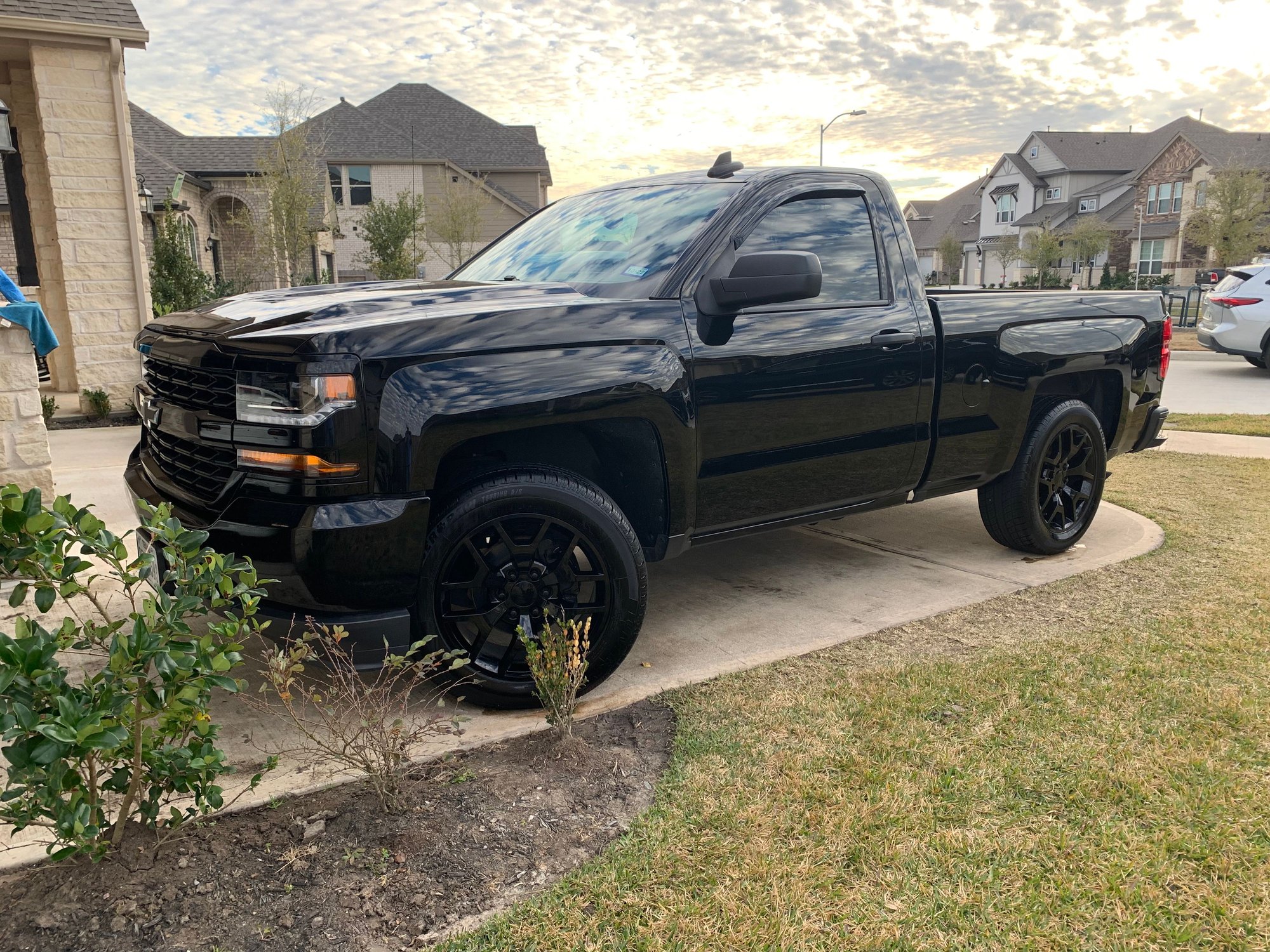

Hey. I just picked up an L86 6.2 long block. It was a warranty take out for a collapsed lifter. A guy from the dealership had it hid in corner and the guy that I got it from had it hid in a corner for years. When I got it, we took the heads off and took the oil pan off. It looks really good. I see why they were hiding it. It's from a 2018 Silverado. It did not come with the high pressure fuel pump, injectors, or fuel rails. This is what scared off the other two guys. So, here is what I have so far on my 2017 5.3 RCBS. Ported 6.2 intake and throttle body, TSP longtube headers with hi-flow catted y-pipe, K&N CAI, custom tune, and 4.10 gears. What I want to do the 6.2 is, fuel system, TSP Stage 2 or so cam kit, DOD delete, ported heads, LT2 intake, and a matching converter. My truck has the 6 speed transmission, so it will need some upgrades. I want to find an exhaust shop to cut the end off of my y-pipe and make a true duel after that. From what I have added up so far, I am around $6,000 more to invest before I get it installed and tuned. Before anyone suggest it, I don't want a turbo or supercharger. So, here are my questions:

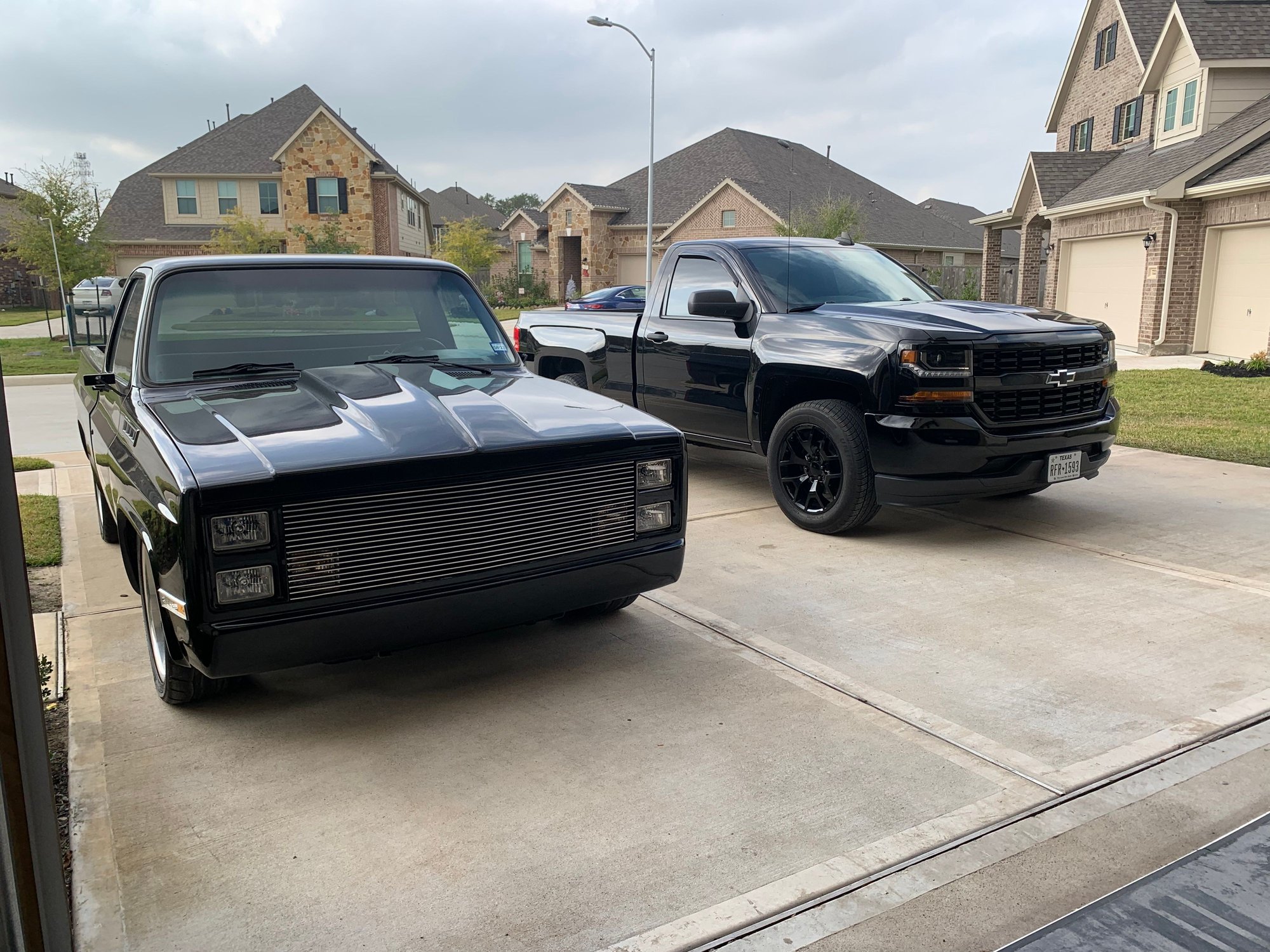

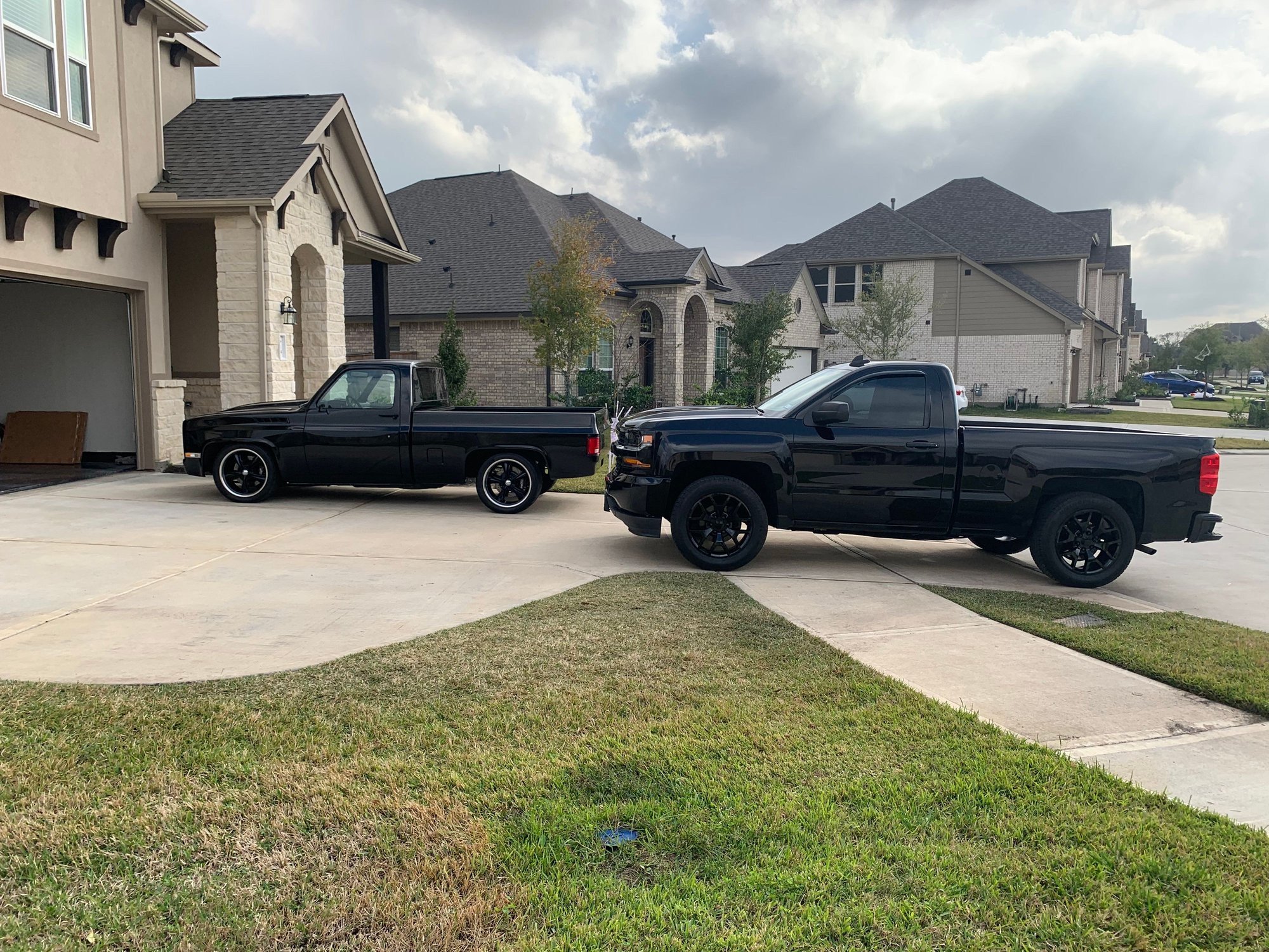

I don't really know anything about the newer LT-series engines, but that's a nice looking truck! Thanks for sharing your knowledge. 👏

Thank you very much. I love these trucks. It matches my 1986. Cheers.

I thought it was a typo...🙊
Regardless, both beautiful trucks! 👍👍
