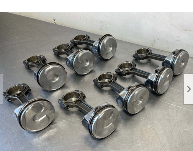

I'd like to do the same to build a much higher comp gen4 engine cheap. I'm not sure if the new pistons clear the counter weights on the gen4 crank though. And if they don't Can I simply run gen V pistons on a gen4 rod? I'm shooting for a budget 13:1+ on e85

So the valves are reversed in the Gen 5’s. If your looking at using a Gen 4 head, the Gen 5 pistons won’t physically work, because the valve pockets are reversed, for the Gen 5 heads.

Would that not depend on the cam and lift you ran?
Or maybe even flipping the piston 180*? They are centered rods, are they not?
appreciate the input!
Old Oct 24, 2023 | 03:36 PM
Posts: 7,865
Likes: 5,224
No sir. Cam has nothing to do with it. You can’t flip the piston 180…it just will not work physically. That valve pocket on those domes in the pic…that is the exhaust valve pocket, or relief. In a Gen5 engine the exhaust valve is on the left. In a Gen4 engine, it’s on the right. You have to run a Gen5 head with those pistons.

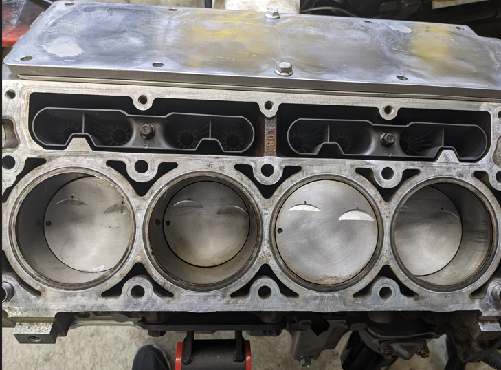

Is there enough meat it the piston top to fly cut it for the reversed valves?

Will do. I've cut as much as .170 on the factory flat top gen4 pistons. I'm sure a L83 could be cut the same, but likely that much will not be needed.
I just cut .100 off a 706 head and fly cut the pistons as needed for over 13:1 on an SBE 5.3.
I needed to cut very little for proper PTV on my 13.4:1 SBE 5.3 after milling the heads .100.

I have Diamond pistons and they have two fly cuts. They have a pic on their website.
I think my cam is 590/620 lift, and putting the heads on, I forgot the locator "pin" and cranked the engine over by hand and the valve hit the piston. Cost me a head gasket for forgetting that. The L83 heads have a different valve angle too. If you have the equipment, give it a try.
