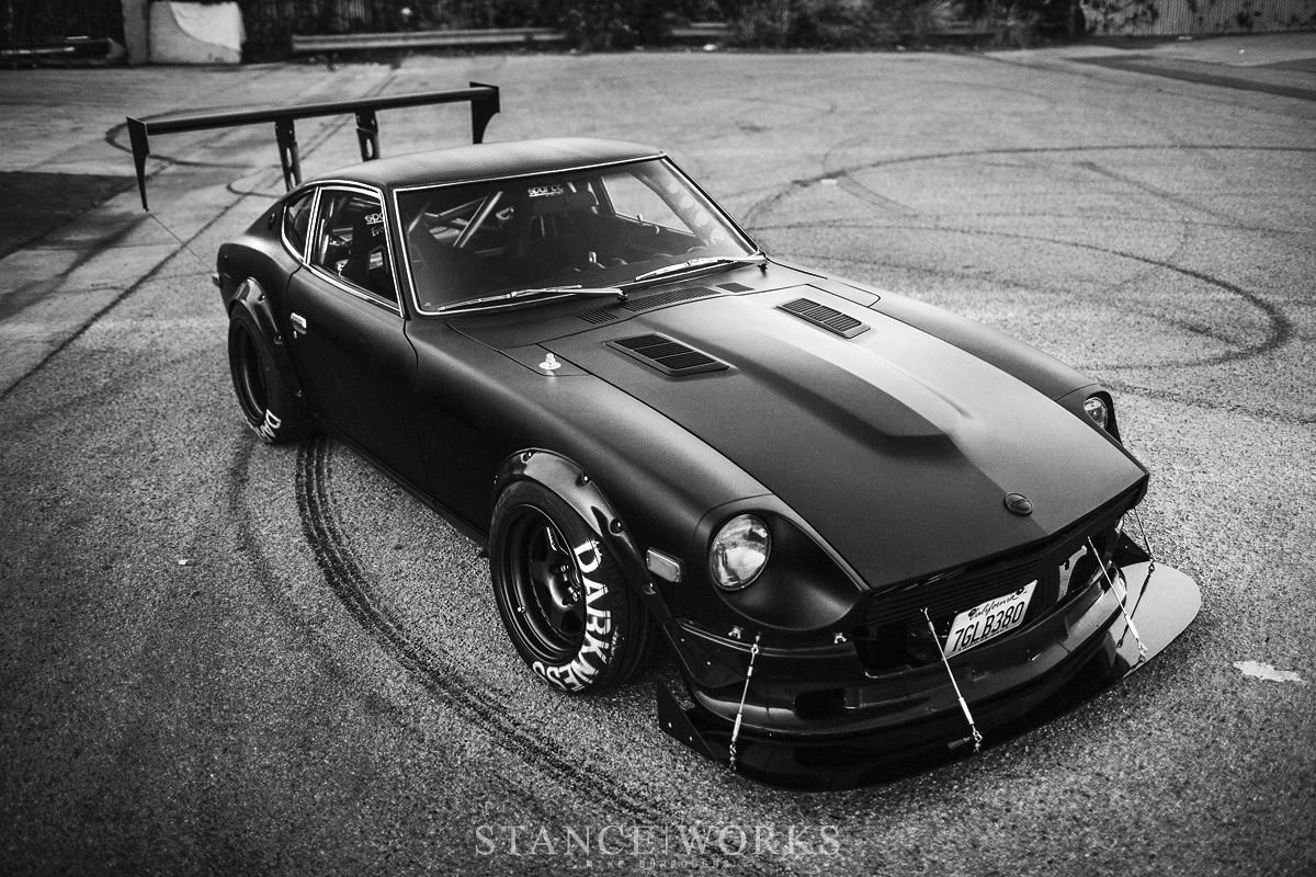

- Either Ariata Speed Works FG fender flares or similar full metal flares similar to this setup
- Front Air Dam and possible splitter similar to this one (not a huge fan of the ricer wing though)
- Rear spoiler (undecided on style at this point)
- Nismo Comp style hood vent (still working on exact design concept, thinking of using steel to slightly widen and then raise the existing hood contours with some vents cut like the competition hood vent and then boxing in/sealing the ITBs to the opening for cold air intake)
- Hood vents (same style as 260 pictured above)
