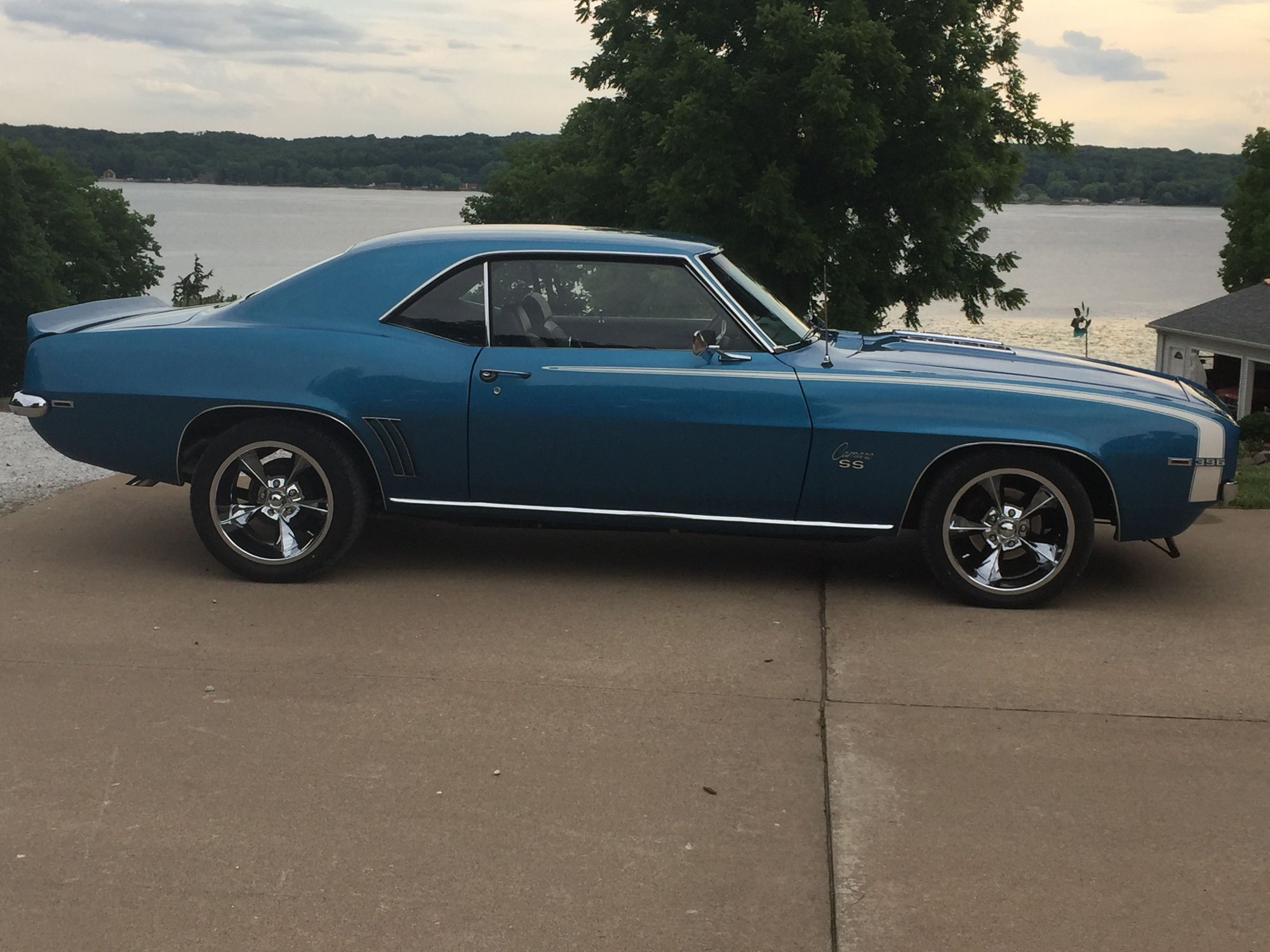

Hi everyone. I’m yet another new guy that’s interested in making my car better. It’s a 69 Camaro big block with a Tremec 5 speed that’s very fun but always looks to improve. Is an LS swap such an upgrade? Which version? Thanks for your input.
