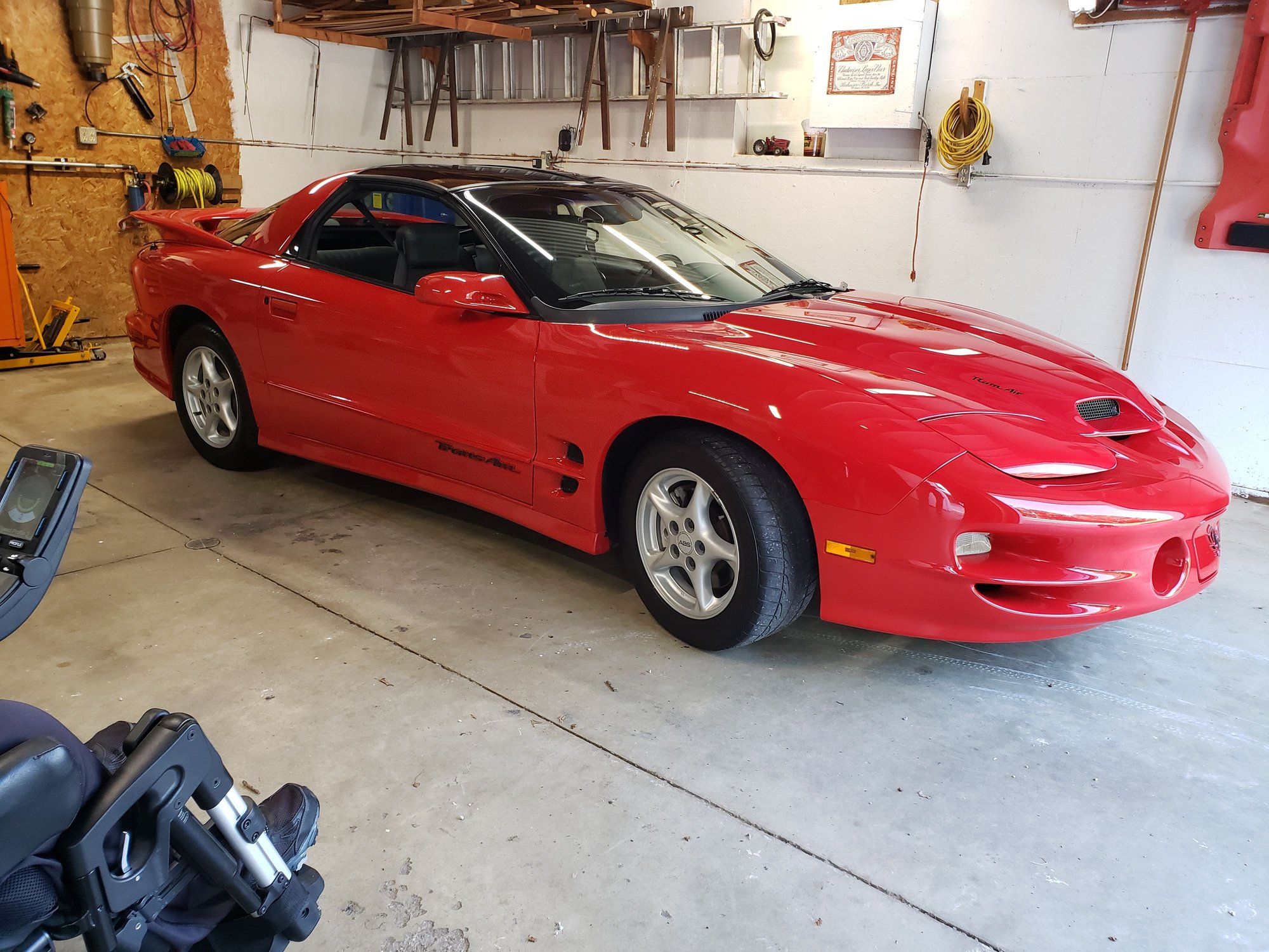

I picked up this 98 T/A automatic 73k original miles, the man I bought it from was the second owner and he had it 18 years, the only thing he done to it was put a WS6 hood on it and changed the rear gears from 3:23 to 3:73 rest is bone stock, the car is mint!
These are my winter plans for the engine
- SSRA Ram air kit with FTP lid and k &n filter
- want to get a set of 243-799 heads and have my machine shop do there magic
- ,All Texas speed parts: Camshaft, lifters, pushrods, rockers, springs and retainers. Long tube headers with 1⅞ tubes y pipe with cats and cat back exhaust system
- LS6 intake, LS6 ported oil pump, timing chain along with the other normal wear and tear stuff
Still not sure about injectors or how I'm going to tune it ANY SUGGESTIONS GREATLY APPRECIATED!
