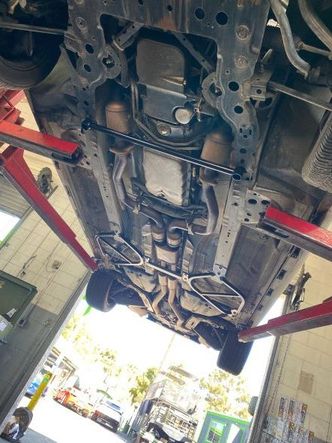

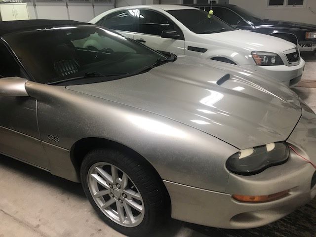

Flyin Miata makes a chassis brace kit even more radical the the MazdaSpeed ones. Fully welded in the car feels like it was carved from one block of steel. Almost as rigid as my insane full frame f bodies.
NOTHING makes a LS Miata handle as great. Amazing control. I have posted some photos of my 98 Camaro where the full frame was fabricated. I'll take so of my 2001 Camaro SS with two inch tubular steel bars welded in and also welded to the pinch weld under the doors. These two F bodied can serve as templates for your Miata mods.
In the back, best handling 7100 pound limo ever, 1996 Fleetwoot 5 foot stretch w 1 1/2" solid F+R sway bars. Koni adj on full hard, 17X8.5" Impala SS wheels and 275/50-17 Nitto 555 G2
Holden Caprice Royale SS
Holden full frame unibody
See post in Introductions: Hey ya all, I'm Elliot. post #9 for fabrication
photo. The oem Miate is as flexible as the oem F body. Doesn't have to stay that way.

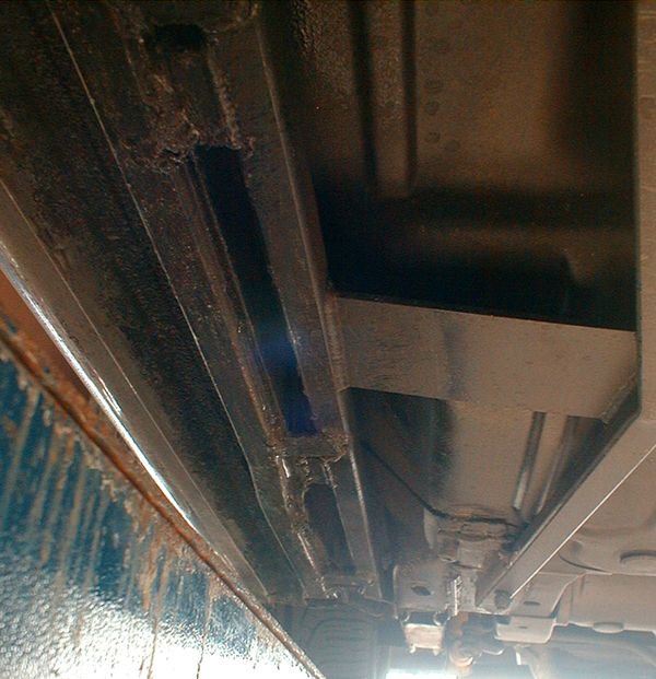

This is a 98 F body but the principles are the same. Find some MazdaSpeed NB photos and just copy what you see. Very cost effective and no way to fail.
These are FM:
The original Miata frame rail reinforcements - and the most effective. – Flyin' Miata (flyinmiata.com)
