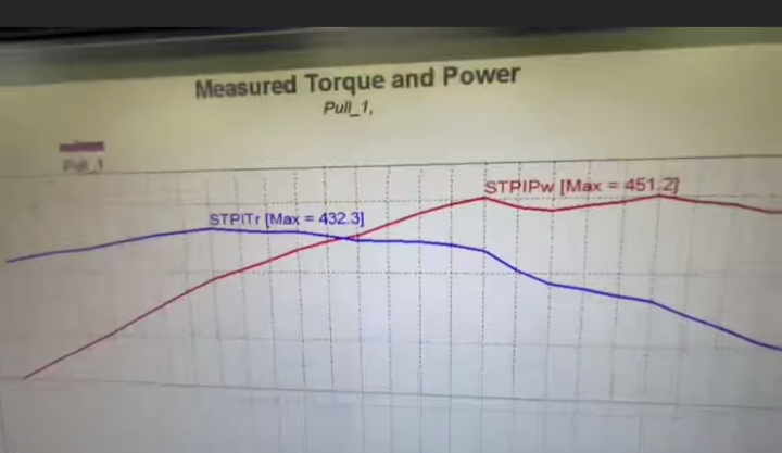

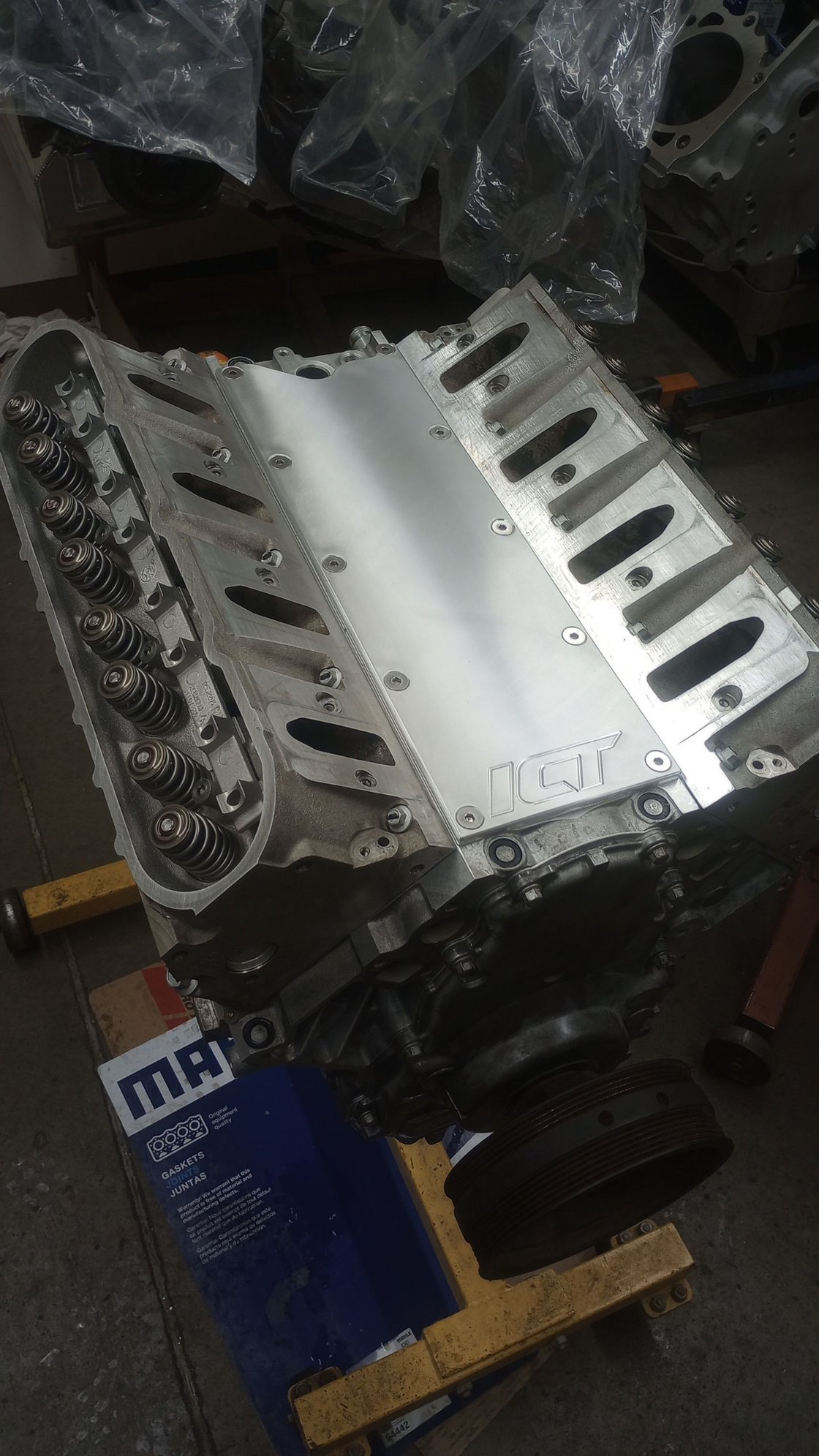

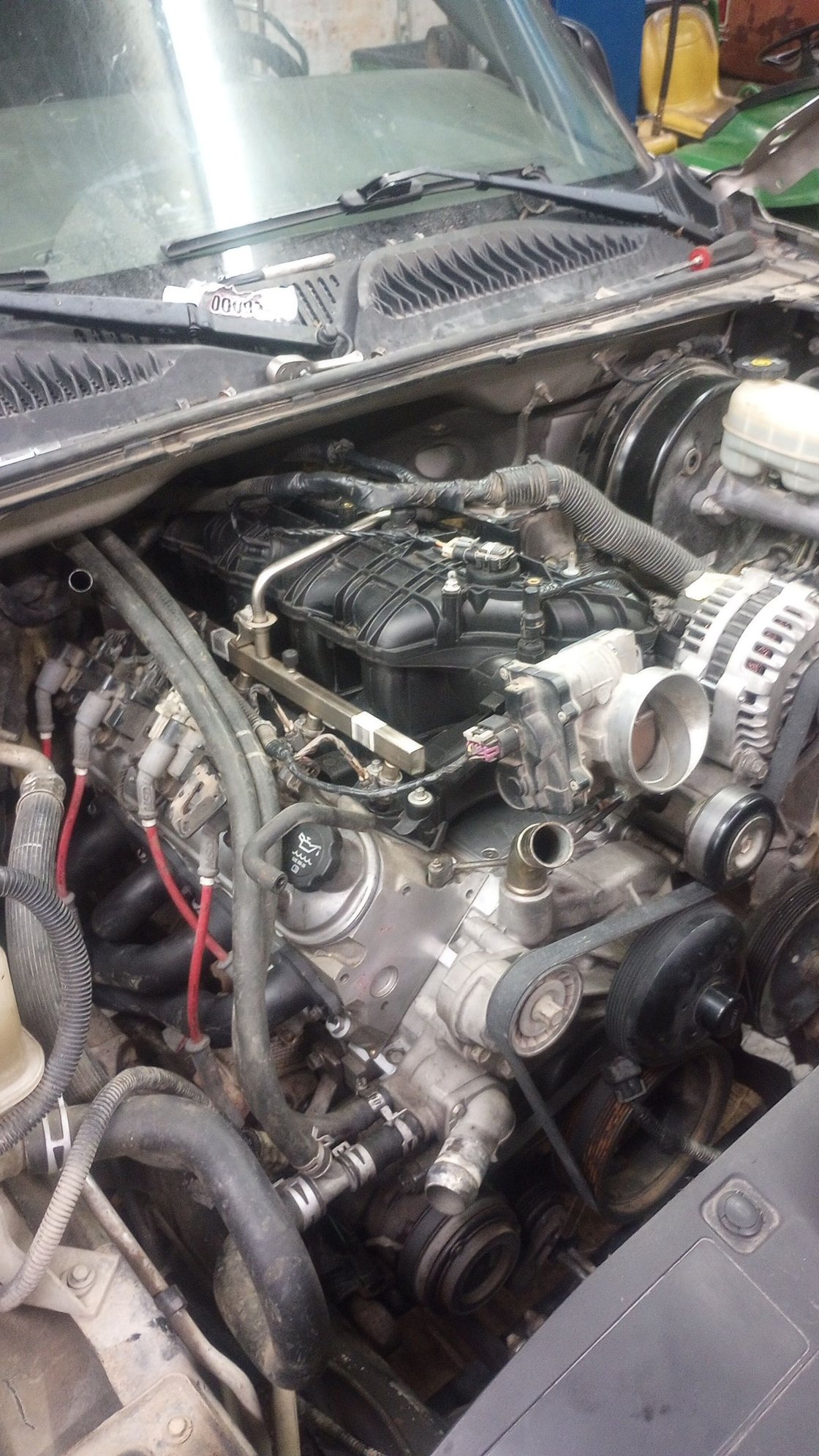

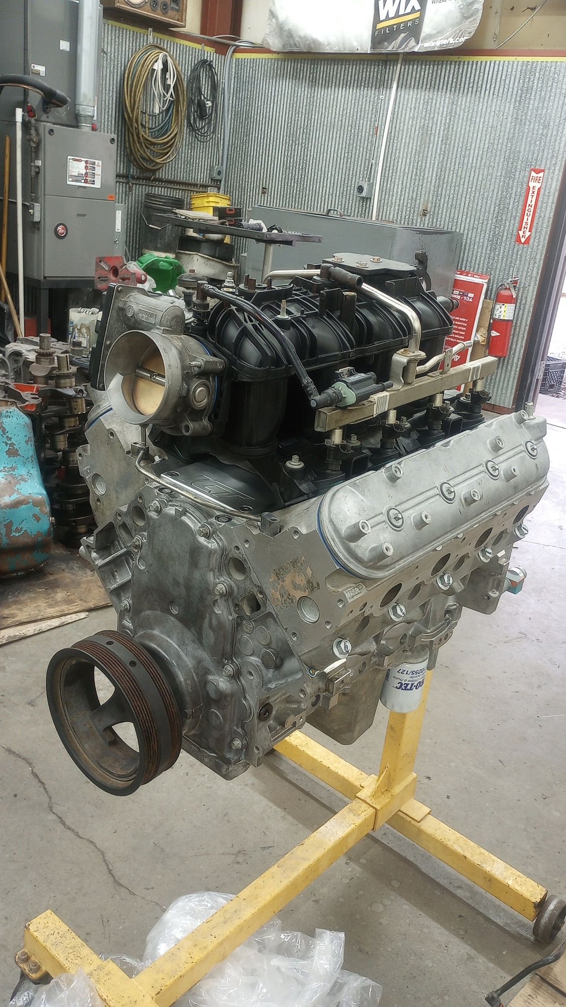

LS1 .012 stock replacement
BTR Stage 2 V2 truck cam 212/218 .553/.553 111LSA
Melling 10295
Overall just a stock rebuild
Owned 02 b4c Camaro fell in love with LS1, had to sell to buy house, itched for LS1 so I found one and decided to build it up for my 2006 Silverado 1500 crew cab z71
Made 450hp/430tq on engine dyno will add pic later
Melling 10295
Made 450hp/430tq Victor Jr and 650 tuned fat on engine dyno will add pic later
