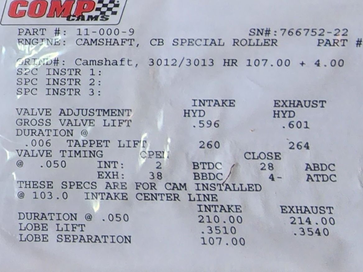

cam spec
cam spec

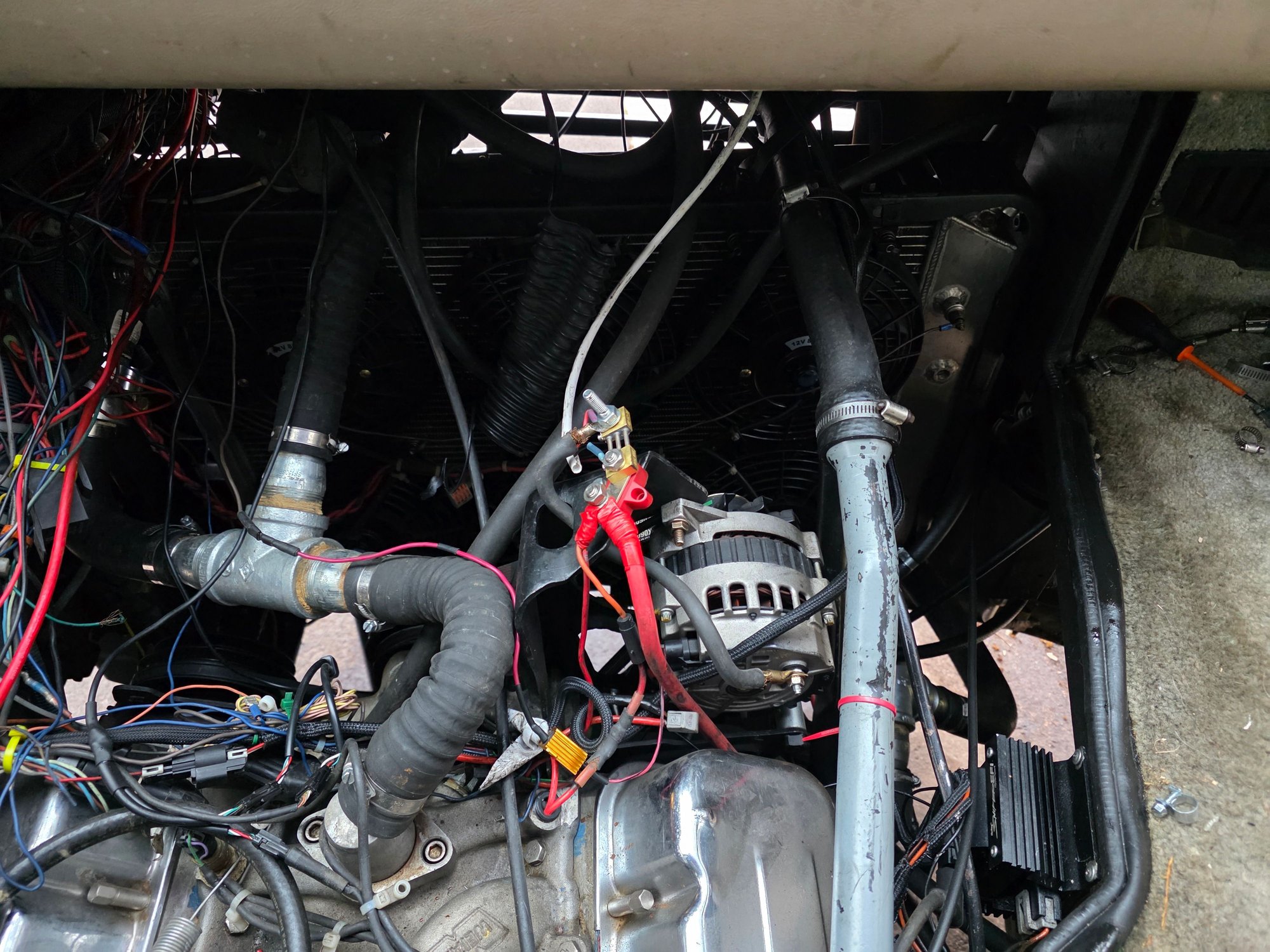

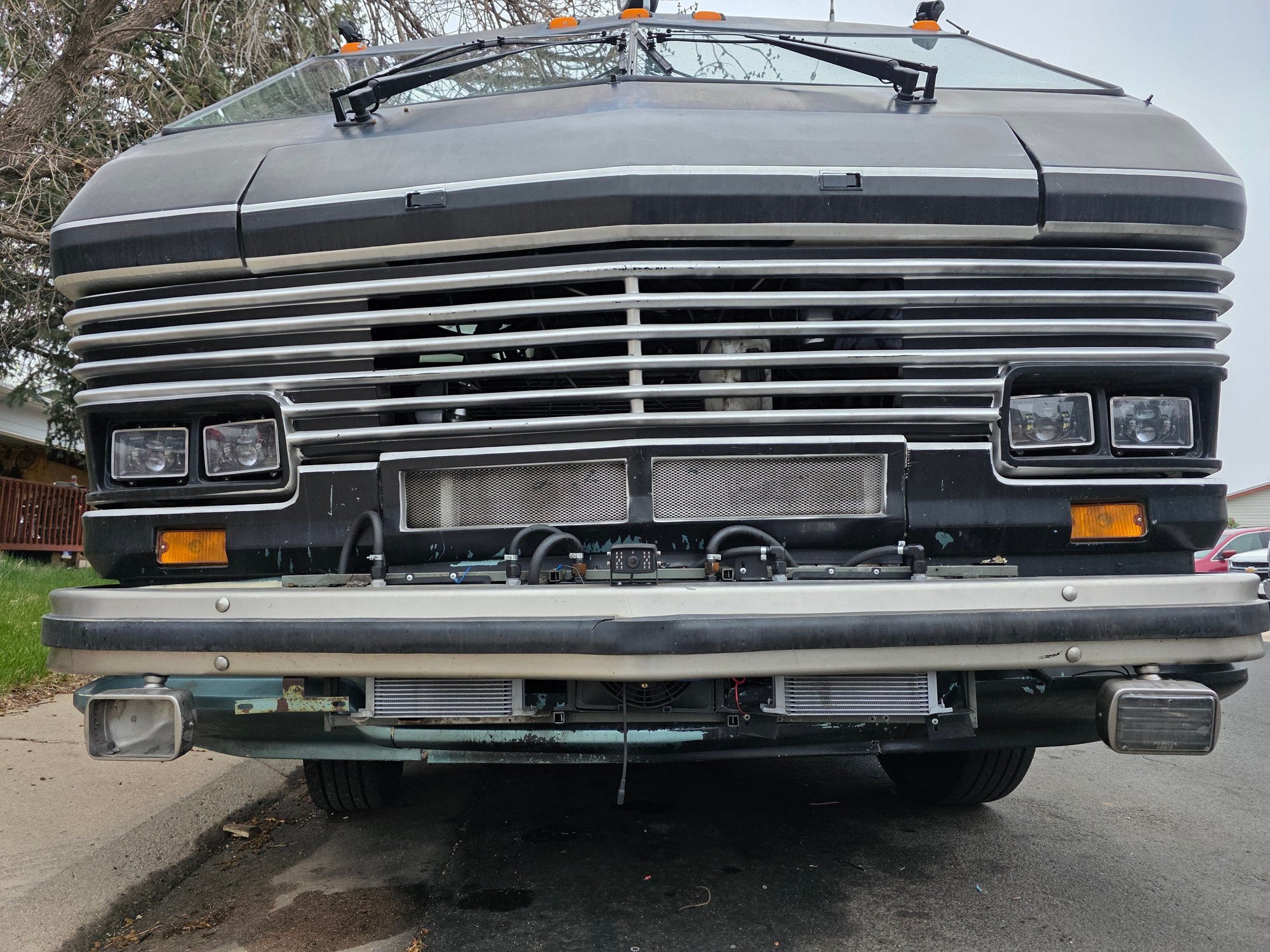

2 grey heat exchangers are transmission, the center is oil. there is an additional smaller transmission exchanger under the air dam. it does a final pass through the primary radiator heat exchanger. i think i am going to bypass the water for summer months.

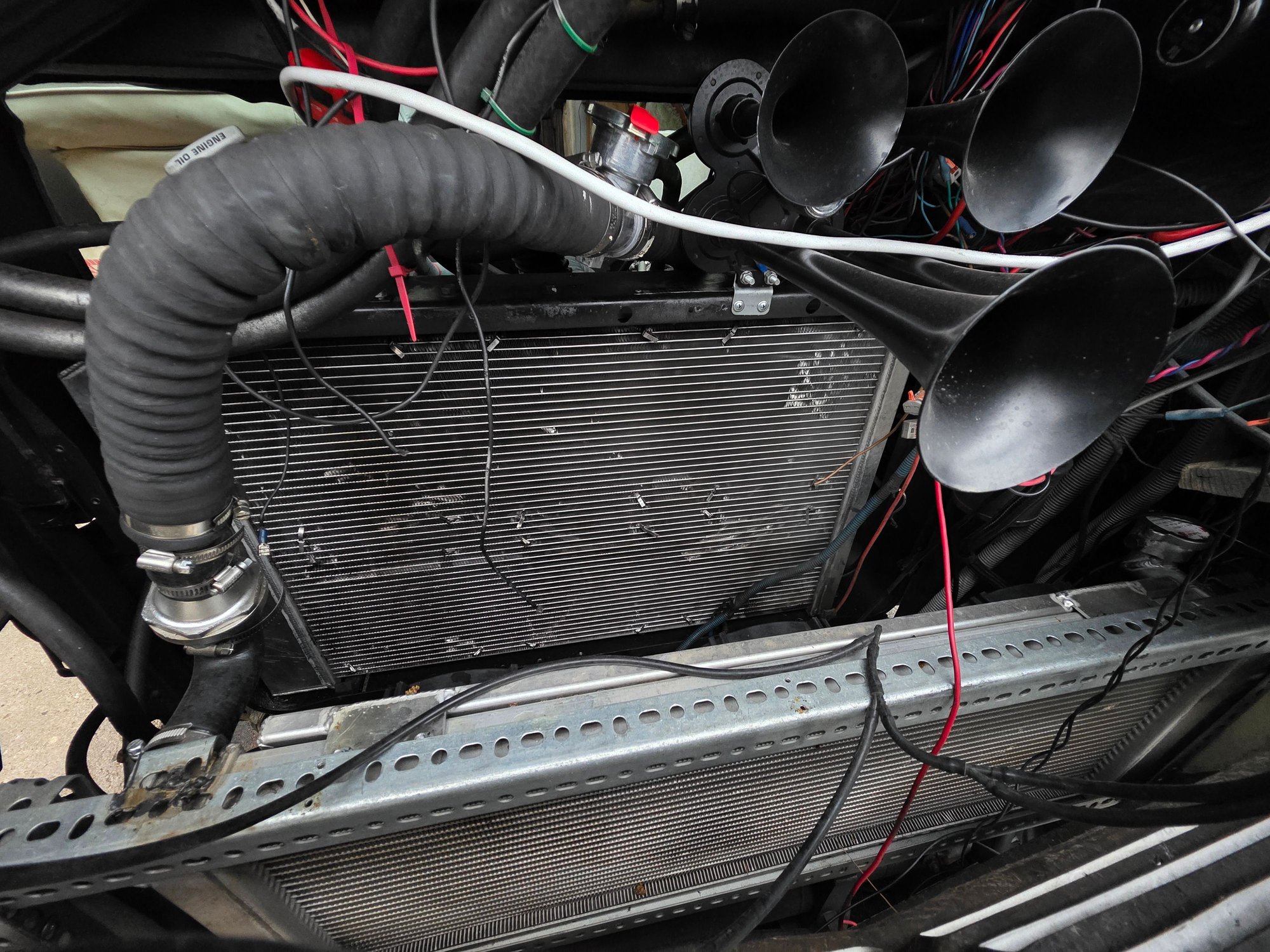

the rear radiator is 5 row all aluminum and is run as the aux at 180f. the front radiator is the primary and opens at 160. it is capped at 24psi.

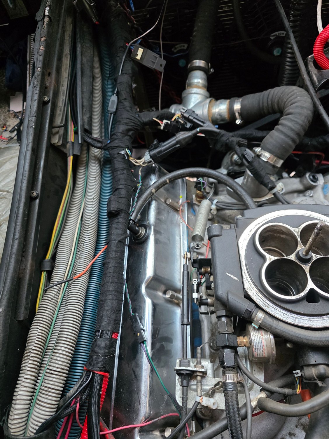

you can see the tee that splits off to my 2 thermostats and radiators.

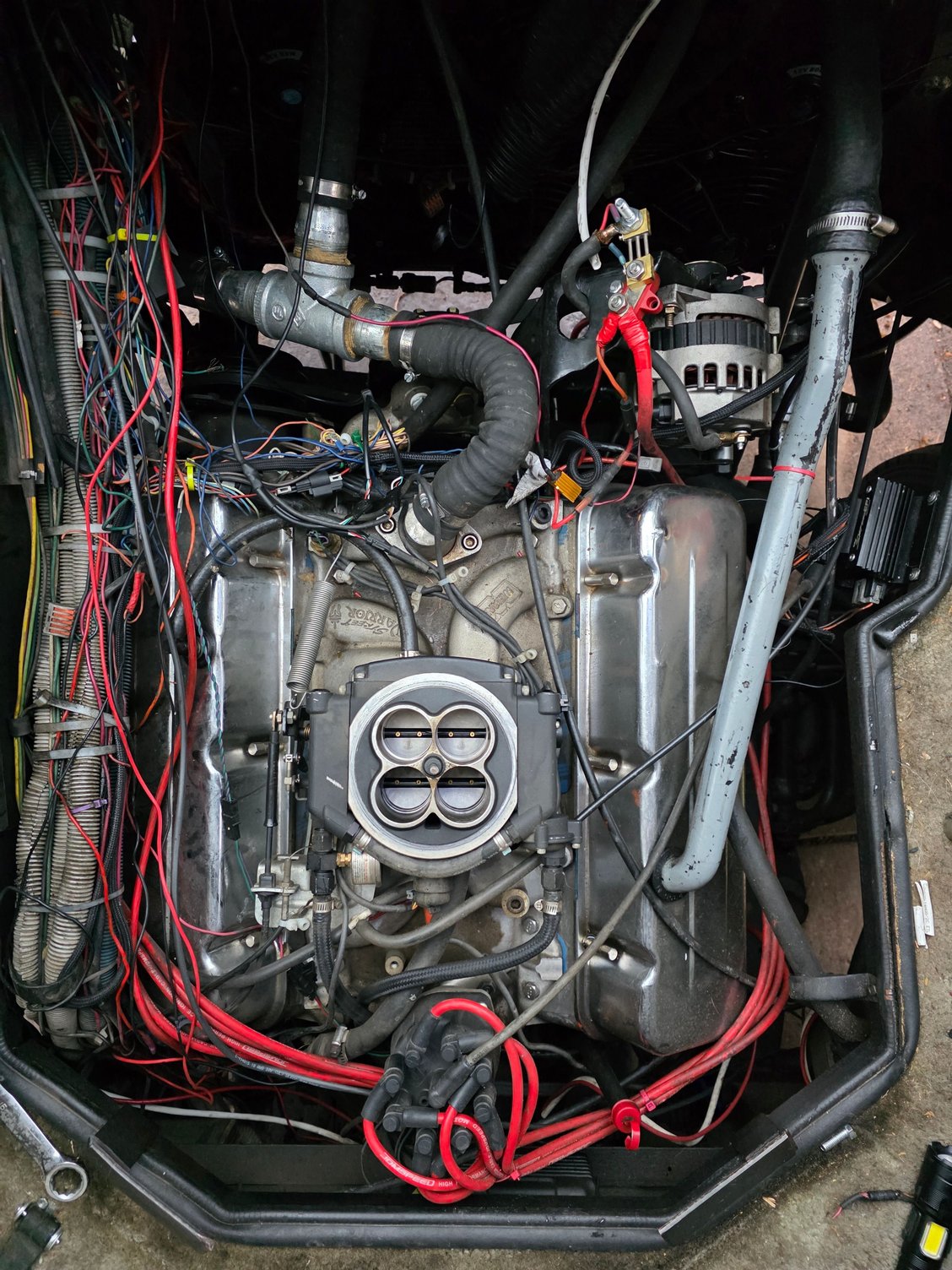

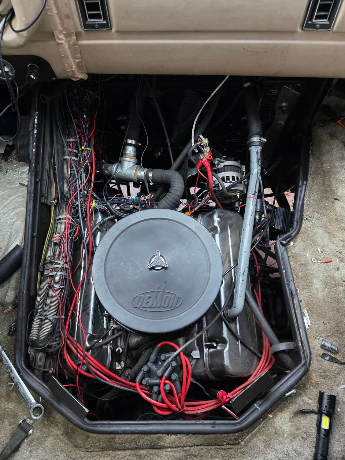

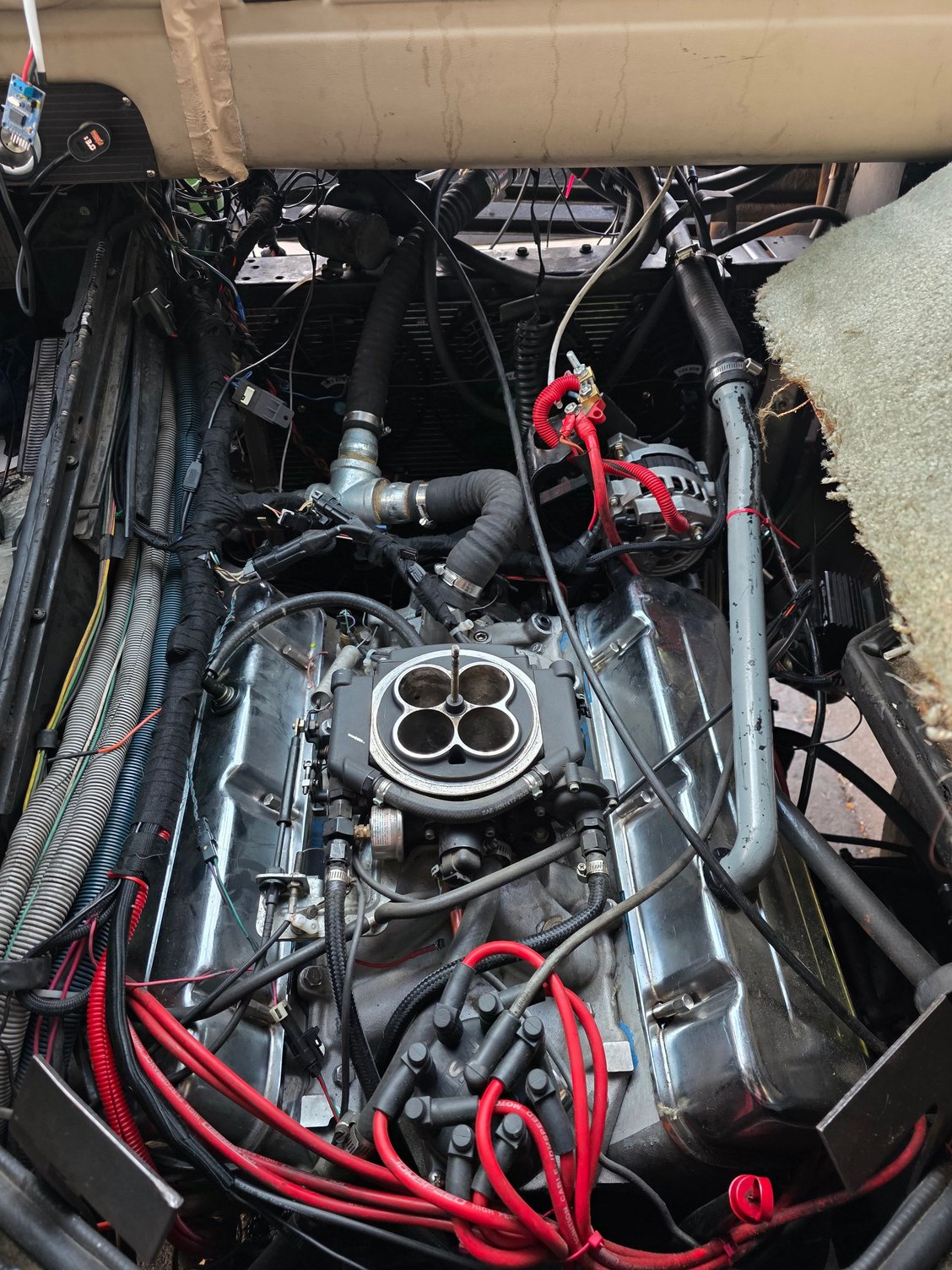

finally dressed my cables.and it still runs!
