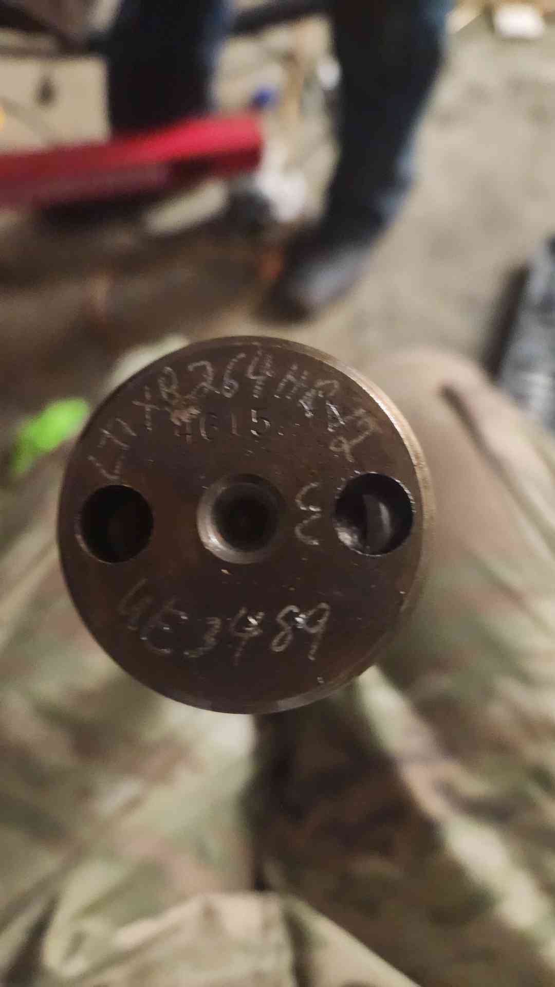

A sidenote I should probably mention, the LT1 came with some sort of comp cars valve/spring/rocker setup as well as what I think is an aftermarket cam of some sort. Here is a pic. Not sure what number to lookup but when I searched them, all of them brought me to texas speed cams and/or comp cars cams. Sorry for it being blurry its my only pic.

This looks to be the cam: https://www.compcams.com/xtreme-ener...oller-sbc.html
With 1.6 rockers, it will be a perfectly serviceable cam for an engine with factory heads and intake. I'd run it.
I highly doubt you are going to find an engine with accessories, plug wires, and such and is ready to drop in and go. Just get the accessory brackets and other items you need.
