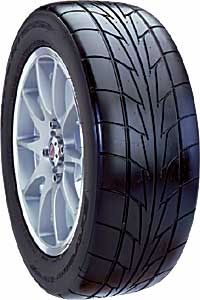

i think i will be going with these. Nitto NT555R 245/45/17
