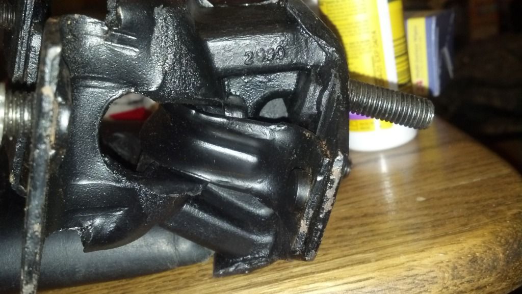

Ordered the rear Motor mount and was shocked at just how weak andcrappy these things are made. OF course theres an easy fix pretty much reinventing it,
to me putting power down at the correct geometry is more important than making **** loads of power first.

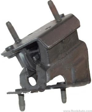

stock pics here
basically it will be filled with high strength polyurethane by the end of this week i should have some finish pictures to share

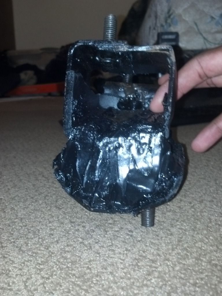

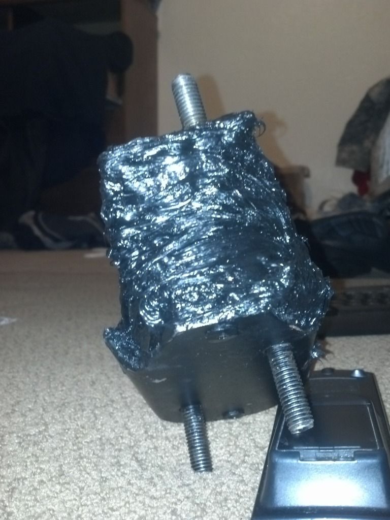

midway through all lower portion is solid poly now working on the upper portion
