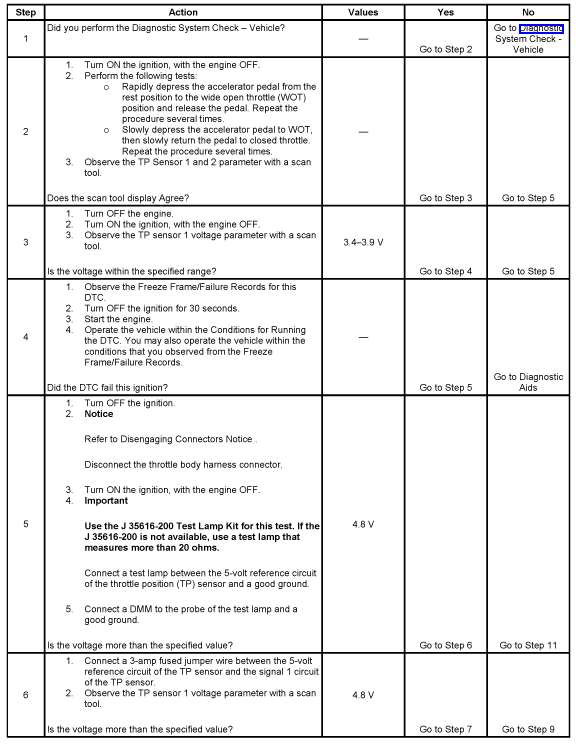

Cleaning the Throttle Body will be useless for this code since they are reading angle and cleaning it wont adjust that at all. However it may of just been a fluke , unplug your battery or reset the code using a scan tool. If it immediately comes back then i would do some more diagnosing/replacing of the throttle body. Some other diagnostics you can do is test the outputs of each sensor and see if they fall into the correct values , or look for dead zones with a multimeter hooked up to confirm that its not a wiring issue to your ECM "unlikley" but not impossible. I usually dont like throwing parts until ive absolutley confirmed its the issue so diagnosing it with a multimeter would be my next step after reseting it and seeing if it returns.

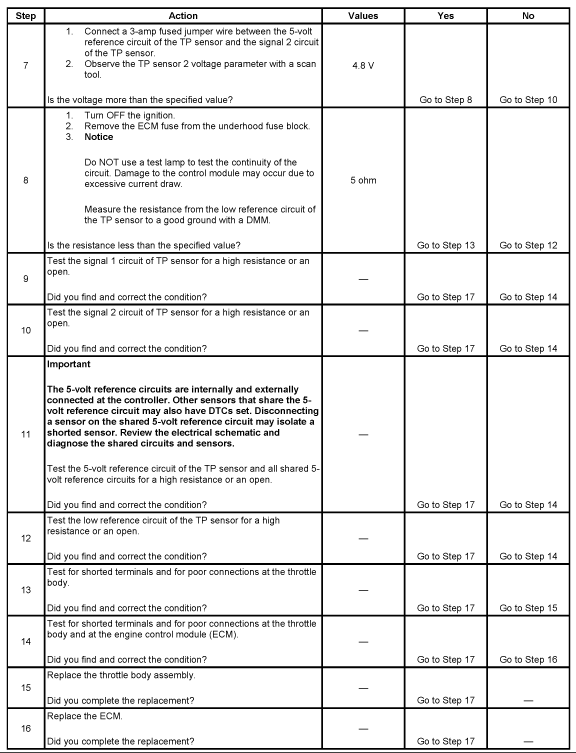

CONDITIONS FOR SETTING THE DTC P0121
The TP sensor 1 disagrees more than 9 percent from TP sensor 2.
The TP sensor 1 disagrees more than 9 percent from the predicted value.
The above conditions are met for less than 1 second .
This means the sensors do not match together like they used to. Sensor 1 is reading "9% variance" from its brother/sister sensor." I would start with reseting it via a scan tool or disconnecting the battery , if it immediately returns then its a very high chance its an issue with one of the sensors not matching the other. Cleaning it will be a waste of time for this issue. If the code returns immediatly , you can triple check it by using a scan tool to see the posistion sensors output and check for deadzones , or use a multimeter to check for deadzones and or strange readings to confirm
