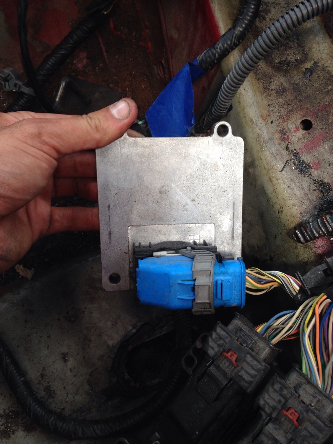

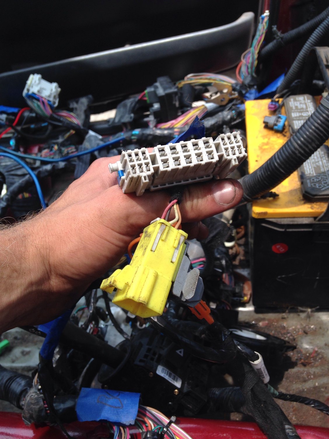

Hooked up as many wiring connections as I can. I can get her to crank but I have no spark. I have 2 connectors that I do not know what they go to, I think one is for ABS and the other I have no clue. Please help me try and find the parts I need. I have about 3 weeks before the drag races and am so close to getting it finished? I just need someone with an LS4 to possibly send some pics of the computers I am missing. Thanks all for the support in my build. Hope yours are going well.
I will put up pics on of the 2 connectors I need help with.

This is right above the tranny and I believe it's to the abs
This one I have no clue and it has an airbag connector a few inches from it.
did you have the apporiate codes deleted for stand alone? Without the bcm it will not get fuel while cranking

No I have not and from what I've seen the bcm and Tcm are both hooked up here are pictures of what I'm talking about
That's the Ecu and tcu but you need someone with hp tuners to delete the security codes etc..
