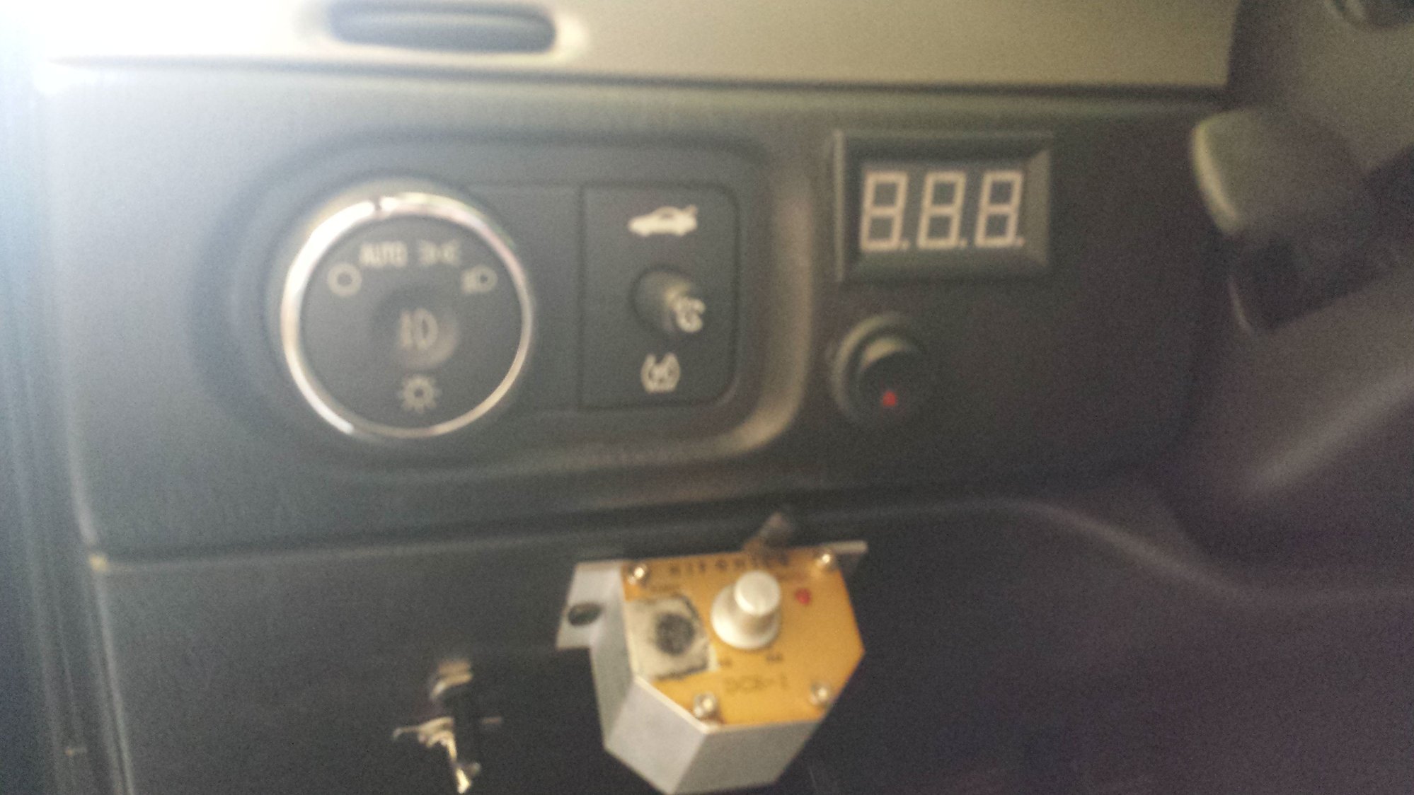

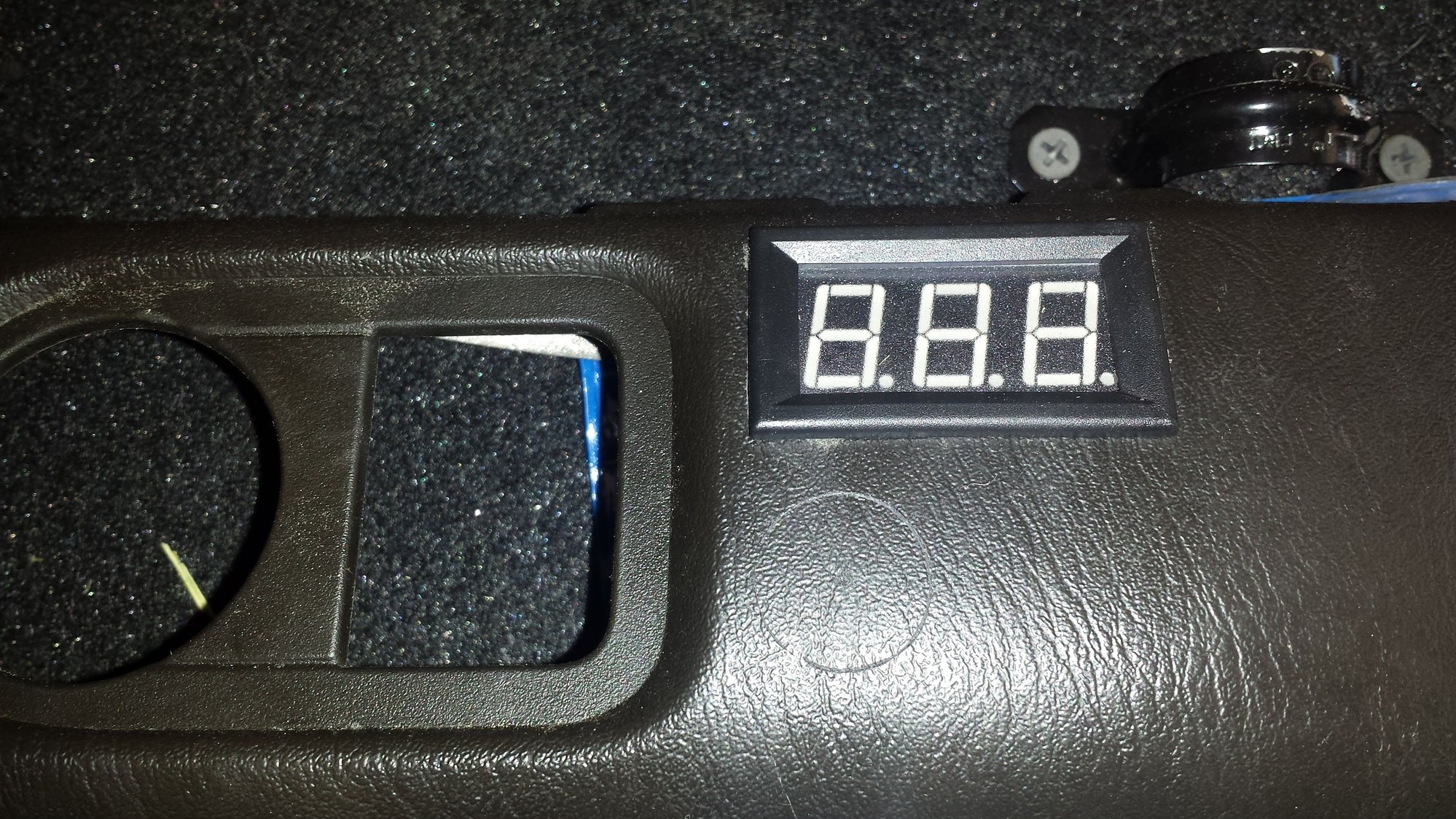

I'm not sure about the gxp, but we don't have a voltage gauge which I find very annoying. So I finally put one in

Mostly for my subs and to see my voltage before starting , but thanks for asking.....
Also having a voltage gauge in dash has helped me diagnose alternator issues on my Cadillacs

just as long as your aware its not uncommon for these cars to charge at 12.7 when in low charge mode. The alternators are variable and charge according to load on the electrical system.
