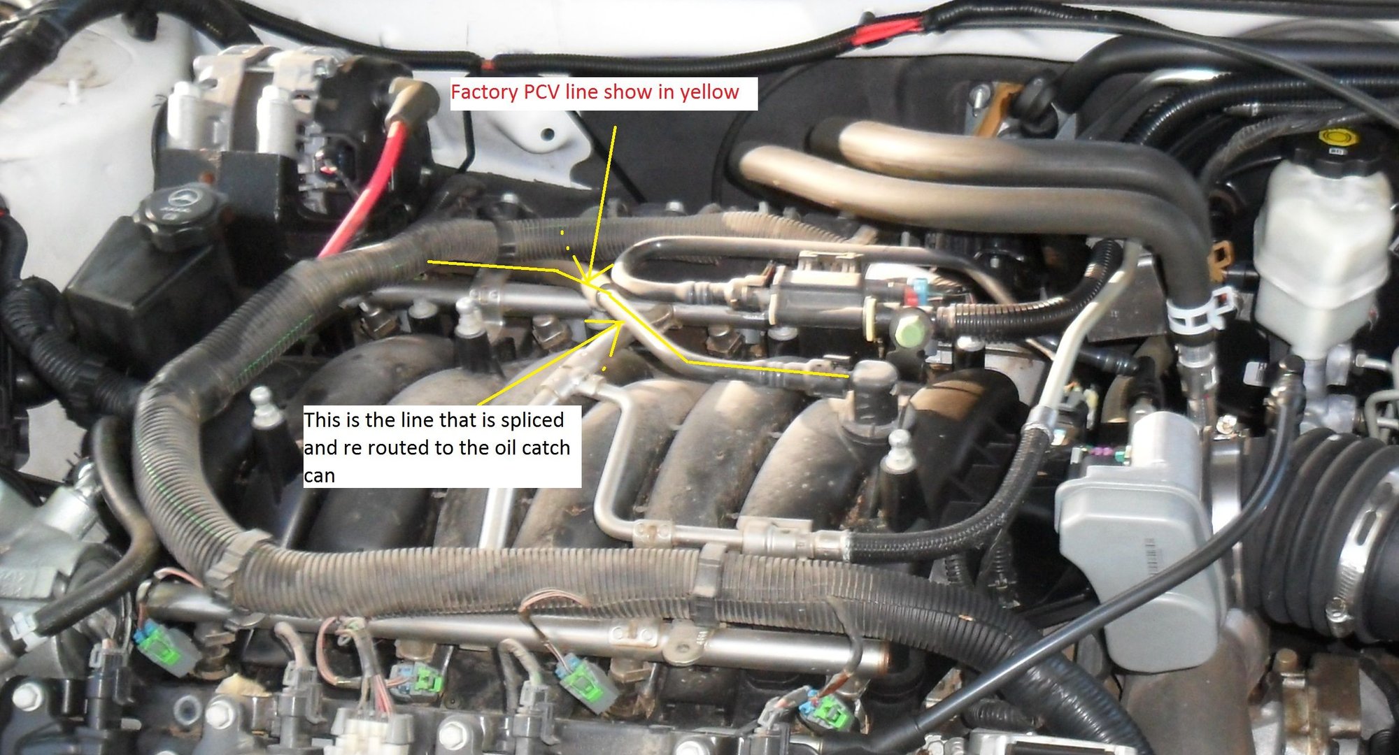

I need some help on where to hook a catch can up on a 2006 GXP. I'm not sure where I need to tie this thing in. Any other pointers would be appreciated.

rear pcv to the can....can back to the intake

Ok. Thanks for the quick response. This is a big help.
