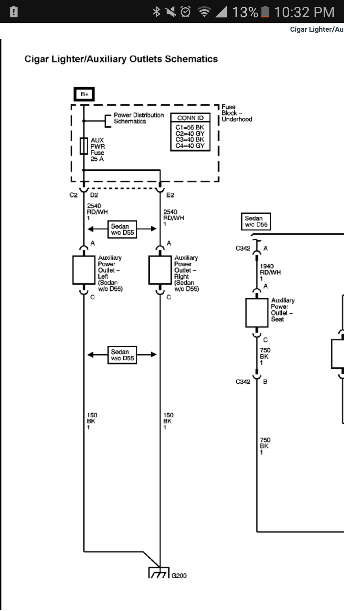

I don't have the answer, but pull the fuse and see what doesn't work . Check seat, steering wheel controls, hvac controls, everything electrical. Maybe Sint3k will save you with one of his fantastic schematics

see,that didn't take long,thanks Sint3k

So I figured it out , with the circuit diagram I realized that I wired my electric cutout to the lighter circuit . I located the switch in the console.
I'll have to look for ignition switch pwr to fix.

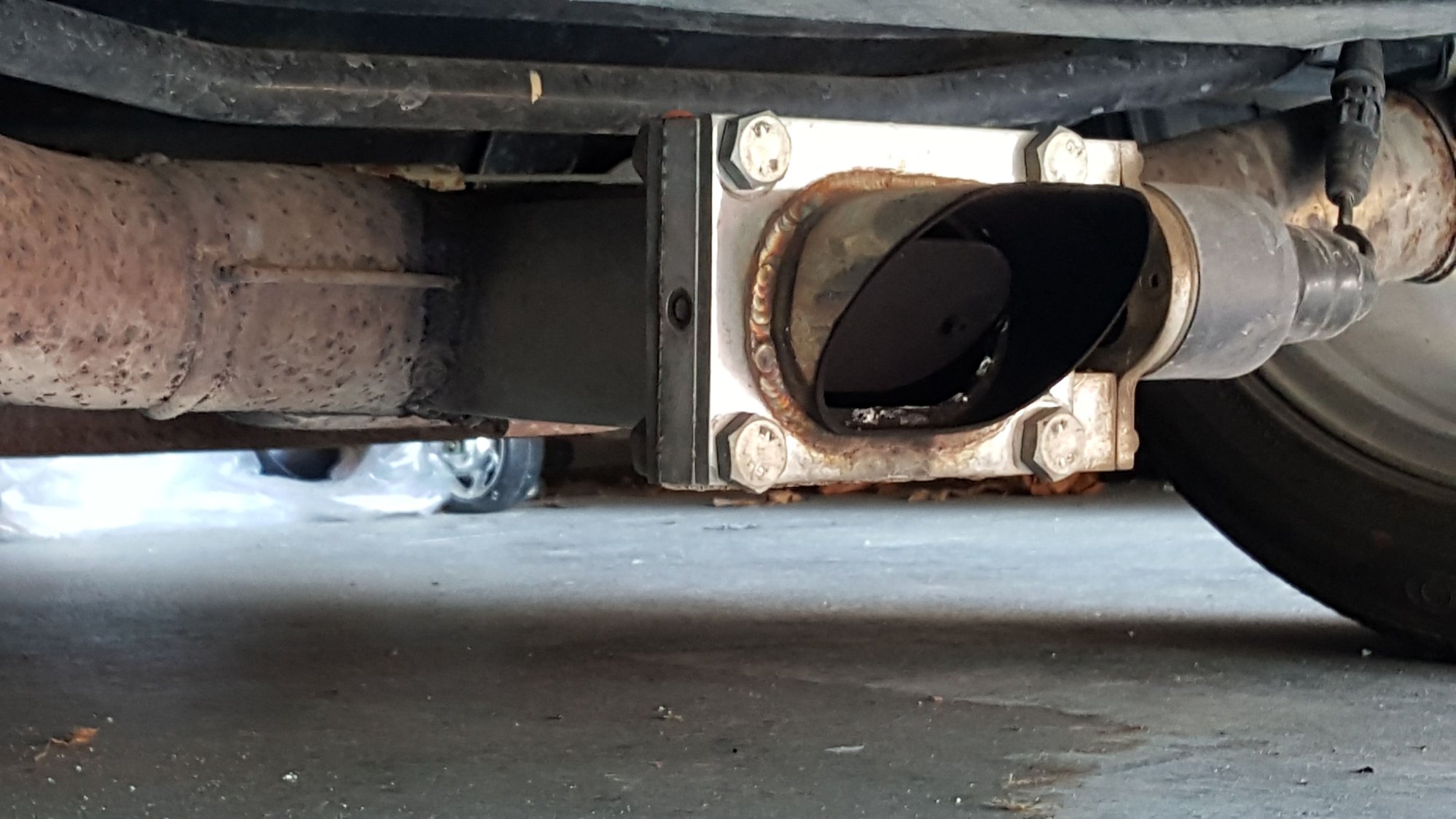

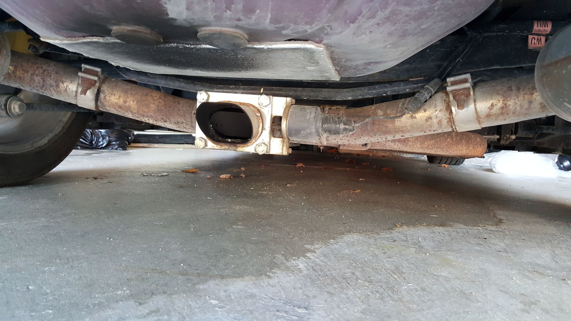

Where did you install the cutout? Pics?
My cutout uses 0 miliamps, and so should yours. Unless it is some automatic one. If you have a draw from a typical switch, then id be concerned about the switch having something wrong internally
Installed at the y as it splits to the mufflers , aims straight back. The race shop that did it had alot of die grinding and some awkward welding to do but did an awesome job. Was almost a figure 8 shape when the hole was cut.

Damn, that thing looks bad *** there. Not real sure that placement is where you would see the most gain from but it is eye candy for sure. Looks like they did a nice install. Is it loud there?
