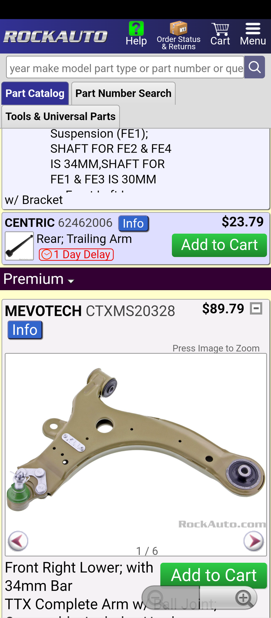

I had done the 34mm front bar years ago, it was a worthwhile upgrade as well. I'm hunting down a clunk in the front now which I think might be coming from the front control arm, I had installed the moog arms and had the moog spherical bushing pressed in. I'm gonna swap them out with these, supposedly much heavier duty.

I've got the front bar but i don't have the proper control arm that has the hole that sticks out so I need to switch over, I might do that and the rear at the same time
