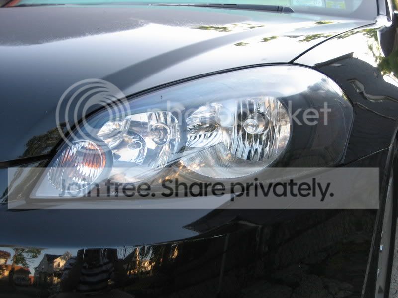

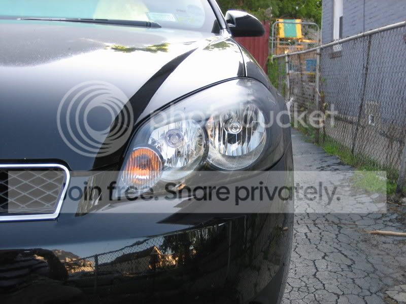

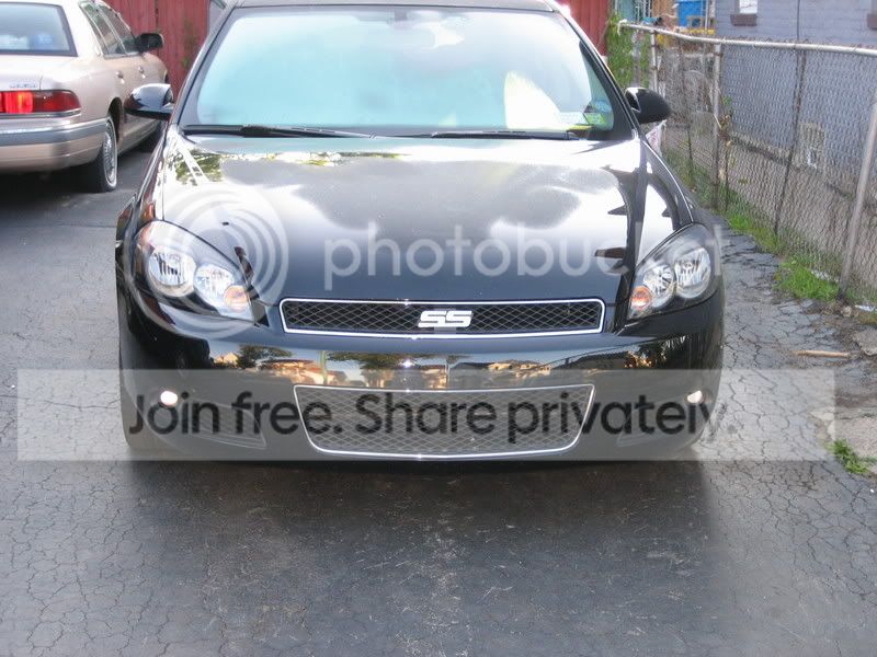

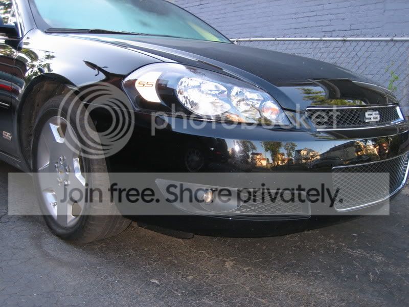

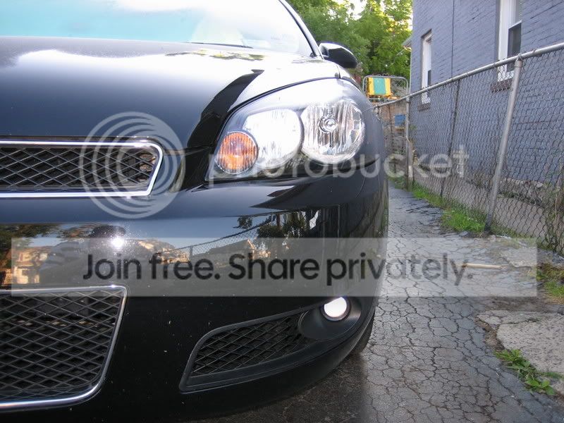

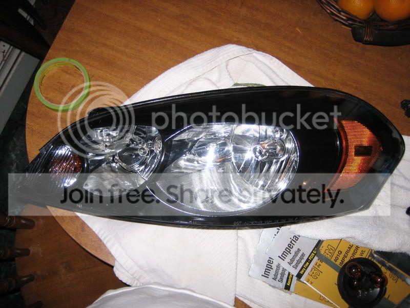

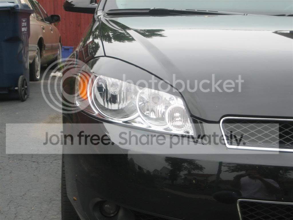

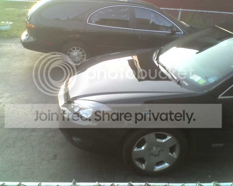

Well, i've been one of the more outspoken critics of GM with the design of the new Impala front end, moreso regarding the big'ole headlights we got. In my quest to change that, i've done a few different things to decrease their "prominence" up front. I tried Vinyl eyelids, which i still like. I've tried tint, which didn't come out so well. I even tried separating the lights to paint the chrome so that they blend into the body more. I think i've found a winner! You decide:
First i tried the eyelids:
Then i tried the tint:
And finally, what i was searching for (don't mind the dirt, condensation and my toes should they show up anywhere in the following pics). I'll admit it takes some getting used to, but in the end it's unique and i'm a happy camper (although the wife hates them...but she hated the eyelids too :roll.

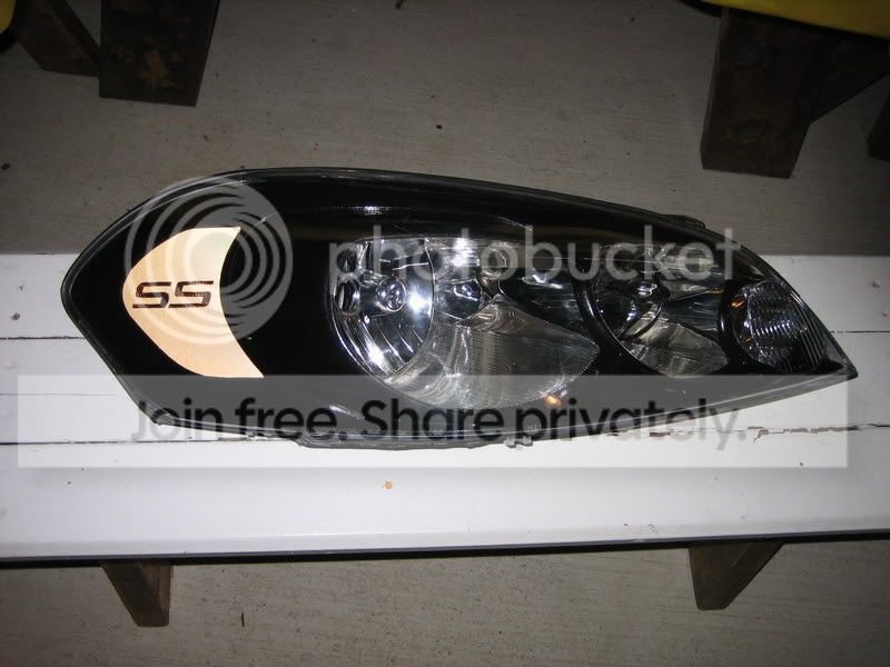

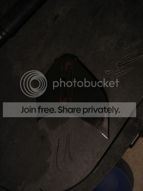

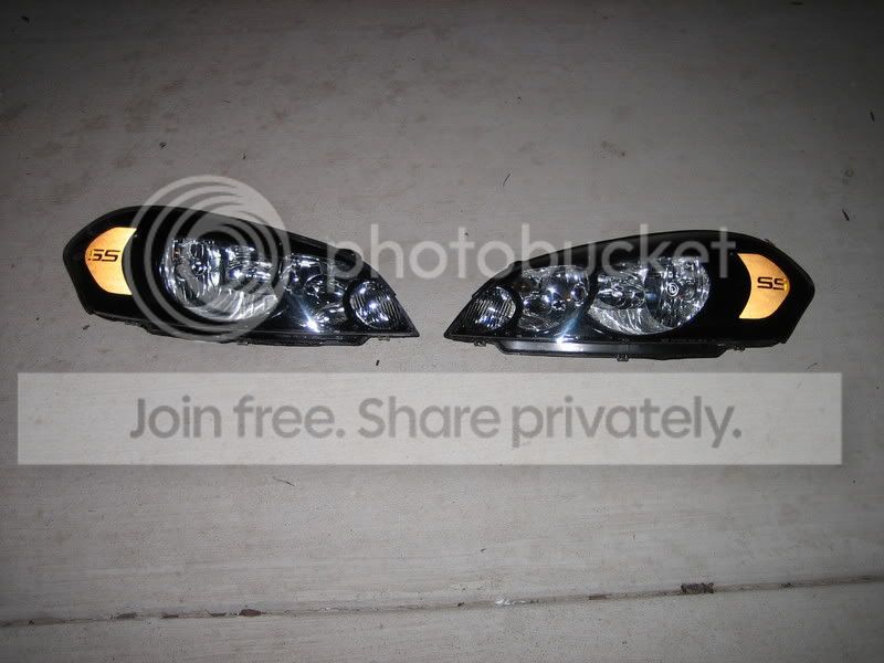

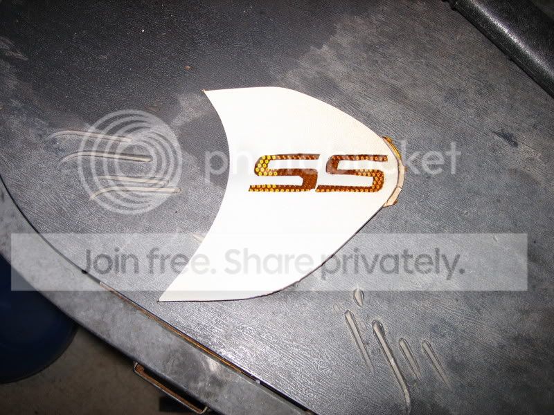

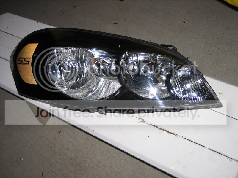

I went over the "splitting" process in the other thread, so i'm not going to go over it again, but i made another unique modification here. I bought some reflective black vinyl and using an "SS" template, i was able to cover the amber reflector with the reflective vinyl and add an illuminated "SS" cutout. I fell asleep and didn't get the nighttime pics i wanted, so i'll do those later. It's pretty freakin sweet IMO...but you be the judge:
To show reflective vinyl example only...i redid this "SS" cutout so that it was centered better for the final version:
I know the "SS" is not perfect, but it's pretty good. There are other imperfections with the headlights too, including some paint imperfections and scratches on the lenses. I used what i had knowing that i'd be tinting the lenses too, so you won't see those issues soon.
I'm going to have them tinted by www.Jonstintedtails.com in Jersey, but now i'm not sure how dark i'm willing to go. I was thinking medium (25% tint), but now i'm leaning towards a light-medium so that you can still see the handywork (roughly 15-20% tint). We'll see, but for now, i'm happy where i am.

Only one setback so far with this project: The reflector on the passenger side is popping out so i'm going to need to split it again and glue it in place. It's not horrible looking, but definitely not something i expected to see such a short time after. Don't know if it warped slightly due to the heat of the oven (last time i did 30min @ 300* and it shriveled up like saran wrap...but this time at 220* for 35min it held shape), or maybe the added thickness of the vinyl & paint on the housing is making it pop. Either way, i'll make the necessary adjustments. Unfortunately, after washing the car i realized that i did quite a good job resealing them...there was absolutely no condensation afterward. I'd hate to break it up for something so miniscule, but that's just me. Hell, it will also offer me the opportunity to touch up the fingerprints in there and to remove the piece of hair

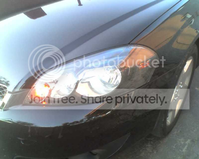

After an entire day, i must say i really, really like them. At first, i second guessed myself. The car looked like it had glasses on. Now, i must agree, i think it looks bada$$! I snapped some nighttime pics with the HIDs reinstalled...pretty nice. I'll post them later.

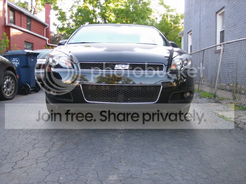

Just kidding. I like the complete tint idea if they would actually look ... well, black and not brown. One of those pictures they look great (I think it is the last one).
I like the last set of pics as well, this one the best though:
You definitely put a lot of work into this.

1. Eyelids i did with vinyl on the outside.
2. VHT went on the outside as well.
