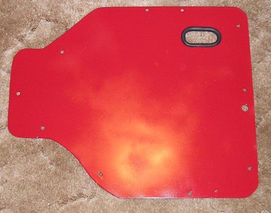

Put a Panel in like I did and you will have all kinds of room.
Panel?

Originally Posted by Quick
Panel?
taking out all the ac blower and **** the big black box and putting a panel to cover the big hole

Panel..
In the car..

me and mike (Black94z28) just did this to my car. you will have to pull all the a/c lines obviously and it helps to pull the dash out to get to the heater core. and then you are going to need a piece of sheet metal to make a panel on the firewall. then I went on to ebay typed in LT1 A/C DELETE pulley and found one for $37 shipped

liking the looks of this... no one makes this panel im guessing?

You can get the panel from BMR. Here's a link to the page...
http://www.bmrfabrication.com/misc.HTM
Just scroll down the page. You can't miss it.

The only thing I have an advantage on compared to that one is that I still have the Heat. That and mine installs from the outside, the BMR one you have to completely remove the HVAC Box.

save your self the time and just go to lowes and get some sheet metal and sheers..pull panel,trace,cut..punch wholes and then run a bead of sealent and bolt in place..it will take all of 10 mins to make and do..a nail and a block of wood is a fast way to make your whole in the aluminum is your dont have a drill press..
