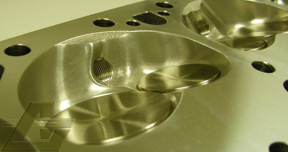

heres a good example of deburring the edges of the combustion chambers.
Those chambers look HUGE.. Is that a LT1 head? And if so, who did them?
Advanced Induction pr0n.

picture of the chamber come from ellwein engines page, they are AI heads..
