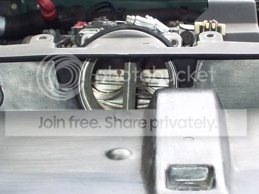

Originally Posted by RamAir95TA
It cracks me up that people think a CAI flows just as good as a WS6 ram air hood and airbox.
Nice pic man, but take a pic of the baffles in the hood and then you'll see the restrictions that make it equal to the CAI. Let me reiterate, I have the Ram Air setup (obviously) and love it, but I'm just stating the facts. Ram Air makes ZERO difference on the Dyno and maybe some real world difference but with variations in track temps, air quality and weather it is very hard to quantify.
