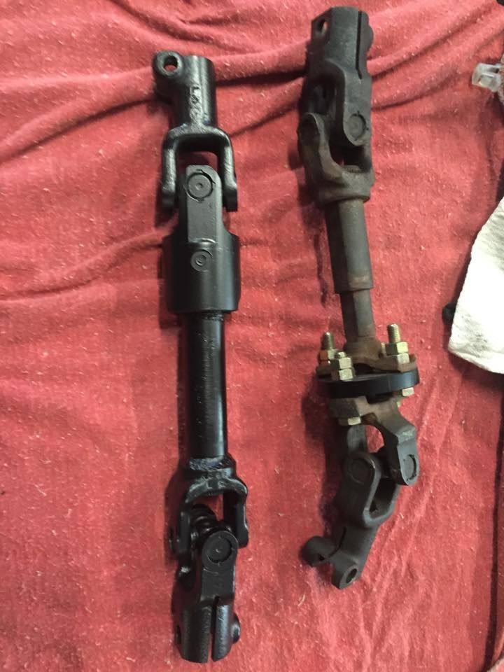

$80 painted and shipped and that's with me getting the shaft.

The welding on that shaft is over kill, all you need is a hammer and punch, takes 5 minutes.
Its just for my peace of mind, but it really didn't have to be welded all around.
Old Jan 5, 2015 | 12:03 PM
94LTZ's Avatar
Joined: Jun 2009
Posts: 750
Not sure how thats for peace of mind, if anything that makes getting in a head on wreck worse since it can't collapse now, using a punch and hammer to push the flares in, re-clock it and flare the ends back out and it will still work like it is supposed to is more of a peace of mind.
There's no such a thing when you're talking about steering components.
Have you done the shaft swap?
I have, but I needed a new steering rack too so I just went with a 98-02 rack. Just saying if you have the option to make something stronger, why not do it? Within reason and budget of course.
Old Jan 6, 2015 | 03:35 PM
94LTZ's Avatar
Joined: Jun 2009
Posts: 750
Because welding it like that is more of a hazard due to it not being able to collapse like I stated before, you have to hammer it off and on and then flare the ends, it has no room to move either way, so your comment has really nothing to stand on except optimism.
Old Jan 6, 2015 | 03:38 PM
nighthawk15's Avatar
Joined: Jul 2007
Posts: 749
From: Spokane, WA
Whoops, missed that, and a fair enough point. Didn't really think about that aspect. Of course, I wouldn't because I'm infallible and would never wreck, duh.
