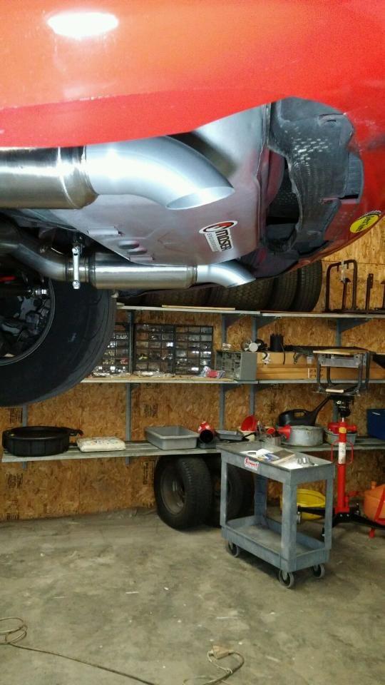

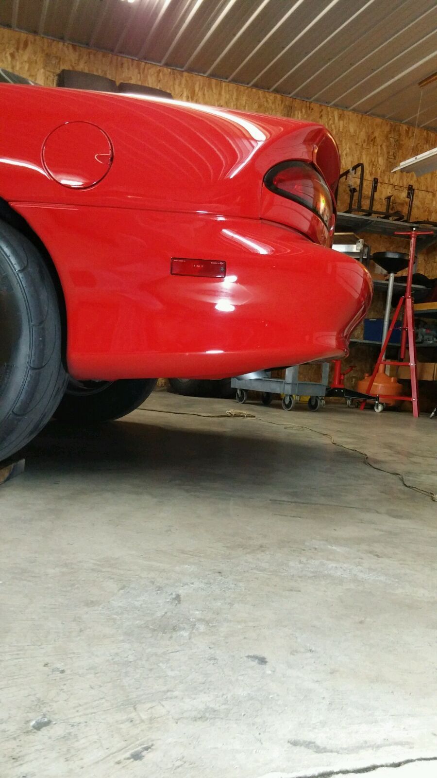

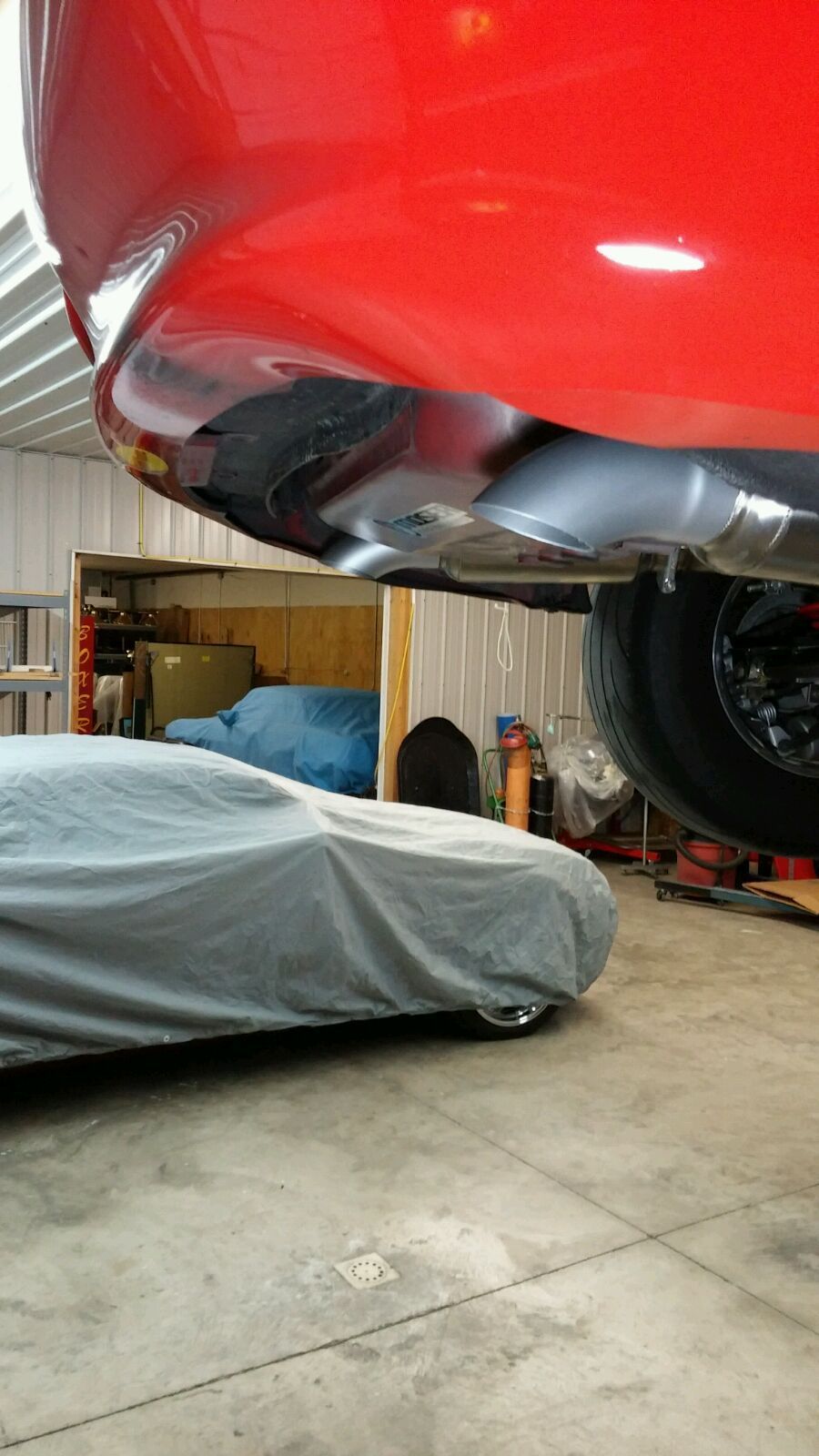

Here are a few pictures of how the exhaust turned out.
Flowmaster Scavenger series turn down painted silver. That is a first gen and fifth gen Camaro under those two car covers.
another under car picture.
Car on the groud. Turn downs are tucked up pretty nice.
