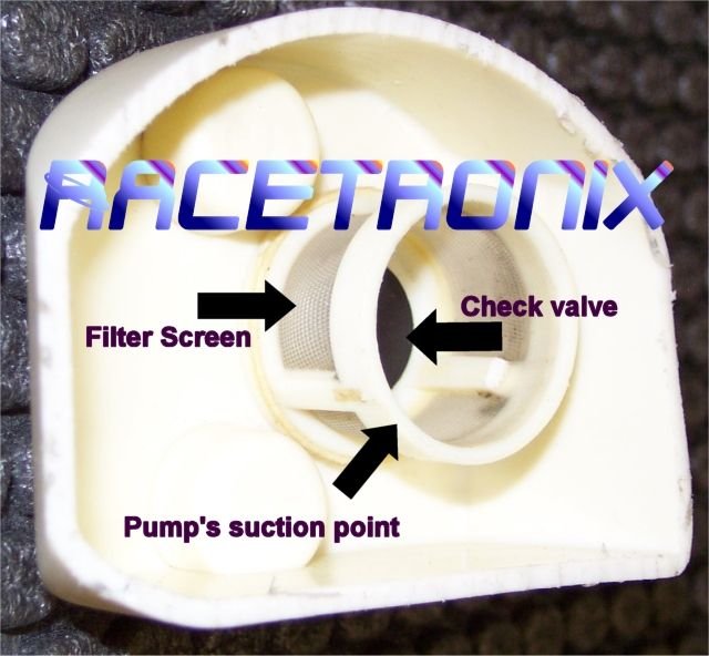

If the pump has been replaced before, or if you know, is the current fuel pump in a bucket, like this:

The LT1 F-body cars have a pump that is inside a plastic fill-bucket. The fill-bucket's inlet and check-valve system in combination with the fuel pump are designed to draw fuel from the bottom of the tank via suction. This keeps the bucket full at all times and the pump fully immersed in fuel regardless of the tank level so that when the tank is low on gas and you are doing some hard cornering or acceleration the pump does not run dry and start aerating (air bubbles) the fuel. This happens as the fuel sloshes from side to side in the tank leaving the center low on fuel. The F-LT1 cars have minimal to no baffling in them. This can cause detonation and possible engine damage. The bucket also allows the car to operate with lower fuel levels in the tank due to its scavenging effect. The bucket can also effect motor cranking time as the priming time is reduced under certain conditions. The return line from the fuel pressure regulator is diverted back into the bucket via a filter sock inside so that the unused fuel also helps keep the bucket full at all times. Keeping the pump constantly immersed in gas within the bucket can extend the pump's life by not allowing it to be exposed to open air. Open air within the tank contains moisture and in time will cause the pump to rust / seize up especially if left to sit for long periods of time without the tank topped-up (i.e. winter storage). The Racetronix pump assembly is modified so that it will seal in the buckets rubber check-valve so that its function is retained.
I don't think the way he checked bleed off is correct. I would have a gauge on the return line, prime the pump, then quickly clamp off the feed line and see what the gauge shows. Obviously flip it around to the feed side and clamp off on either side of the gauge to test the pump bleeding off and the injectors. Using all 3 of these results should tell you what is bad. I'm explaining it poorly but think the principle is obvious. In saying that, the check valve is on the pump side and clamping off the return line would certainly show the pressure bleeding off but doesn't conclude it is the only issue.
