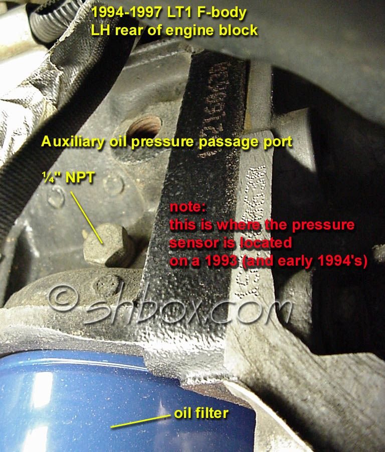

The oil port near oil filter on our LT1. What is the size on this? Thread type?
Use for a turbo?

Will feed a turbo fine.
