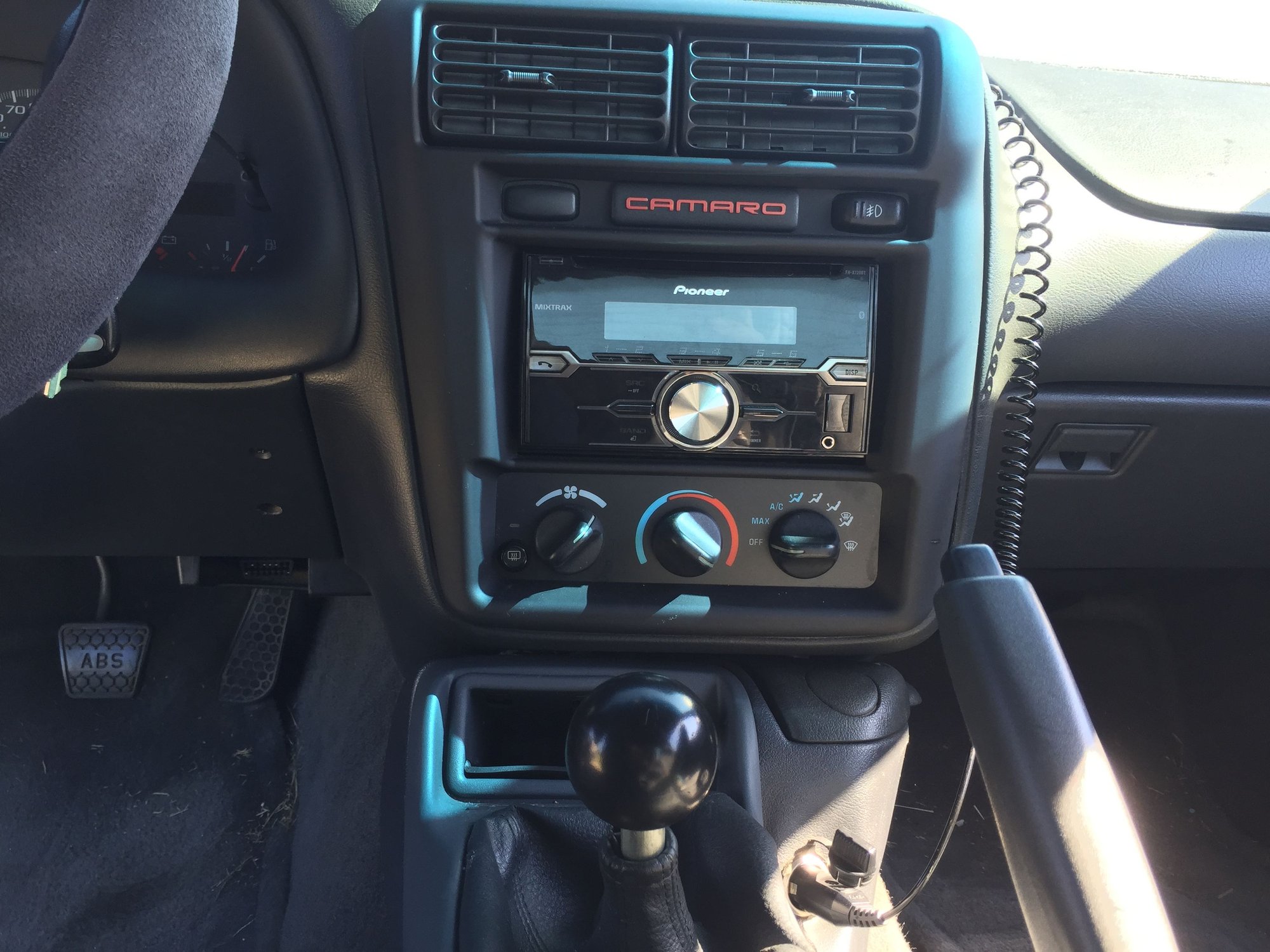

Has anyone ever removed the Factory subs in and just put in regular speakers? I already replaced the door speakers with some kickers, as well as the two smaller speakers in the back with kickers, and have a single sub box in the trunk, sounds pretty good. Was wandering if running speakers where the subs are at (back seat area) would just be overkill? I'm working with a Pioneer X720BT, so far all the speakers are matched to the radios RMS output etc.. soldered connections everywhere, factory amp removed from the spare tire area.. just looking for even better sound!
