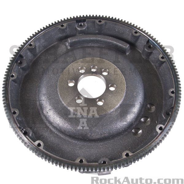

As stated in stock form the LT1/4 is internally balanced in the front and externally in the back via flywheel or flexplate. The "balancer"/pulley is a damper and has no heavy side.

What could go wrong with an unbalanced assembly? Too much stress on the crankshaft?
motor would shake like a dog shi*ting razor blades
a stock LT1 FW has a cast in weight ( and then is drilled in various places to whatever balance specs GM has for the internal balanced motor)
If your FW is neutral (zero) balanced I would think this would be a problem with a stock LT1 rotating assembly. LT1 are rear, externalal balanced motors. Front damper is neutral balanced
pic of stock LT1 FW
pic of stock LT1 FW
Nobody seemed to catch that he was keeping the stock flexplate (with counter weight) in addition to the zero balanced flywheel. He'll be fine.
