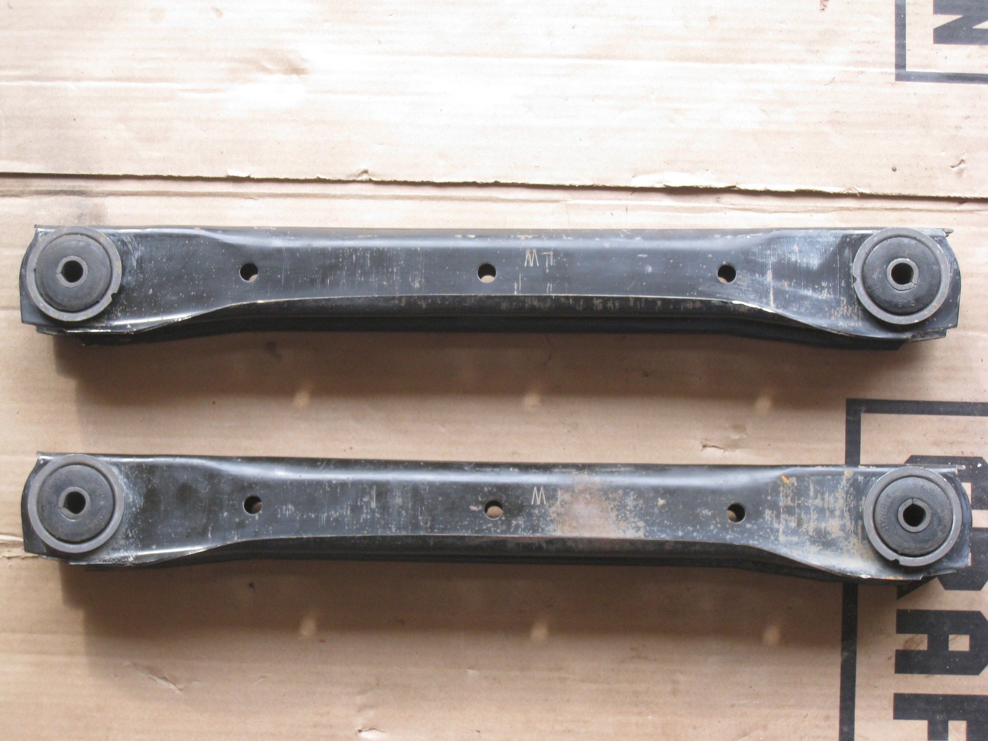

You can be super cheap and do like i did. Take the arms off and get some flat plate and weld it your stock arms to box them in. Don't need to run full beads just short 1 inch beads every few inches, knock your old bushings out, new ones in and you're good to go. FYI the stock lower arms are the same ones gm has used forever across many platforms.
We did this mod to my brothers 1980 g-body wagon 8 years ago and he has since upgraded his whole suspension set up and I had his laying around the shop. Tossed em on and and after a few pre and post butt dyno burn outs, the car isn't as sloppy in it's launches. I know there can always be better, but for the price of some bushings and your time if you can weld, it's a cheap and easy mod.
Here is some pictures of the arms I boxed and used.

With how cheap the UMI pieces are @ $90, and how quick and easy they are to drop-in install, I don't really see a reason to be messing around with replacing bushings and modding stock LCAs unless you are on a super tight budget. Alldata shows like 3hrs of labor but if it takes you more then an hour from jacking the car to putting away your tools I'd be surprised. Can install them faster then some CAIs.
Buy the time you buy new poly bushings, plate stock, and have them welded you're probably damn near the price of the direct replacement aftermarket LCAs with no hassle. If you're stock height and not looking to spend the cash you can skip the relocation brackets for now.
