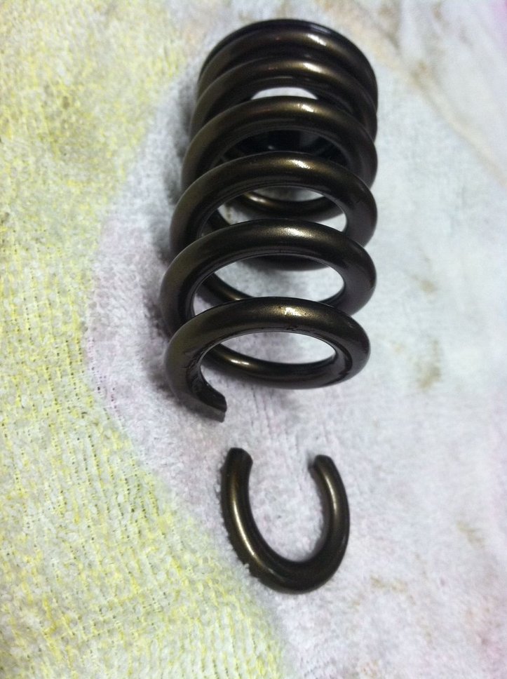

Originally Posted by Vicious95Z28
I personally like the Comp 26918 (or PAC equivalent), .
The 918's have about the highest fail rate of any spring used on the LT1. Lloyd stopped installing them years ago. Typically a failed spring, breaking, takes out the motor or minimally the valve and piston involved. The bee hive (918) is a single spring so when it breaks, unlike a dual spring, carnage is the result. Any valve spring is a wear item especially running a aftermarket cam with aggressive lobes so they should be checked every 5k mi and at 20k mi replaced....if they don't break first

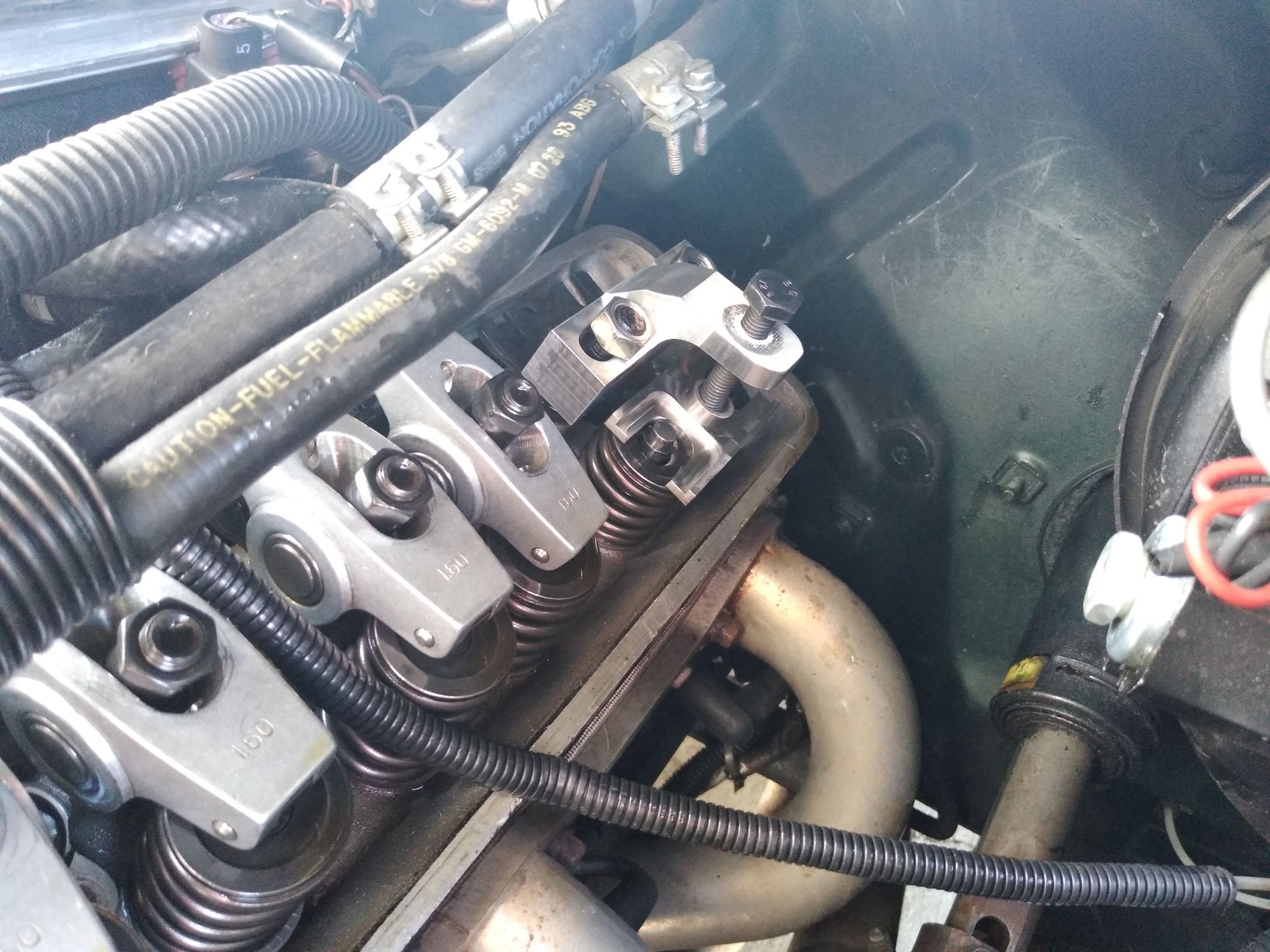

Ruken's Avatar
Joined: Jun 2015
Posts: 246
From: Avon, IN
These are what I have, and I love them. Great set of Rockers, second season with them on. Still look brand new when I pulled my Valve Cover off today.

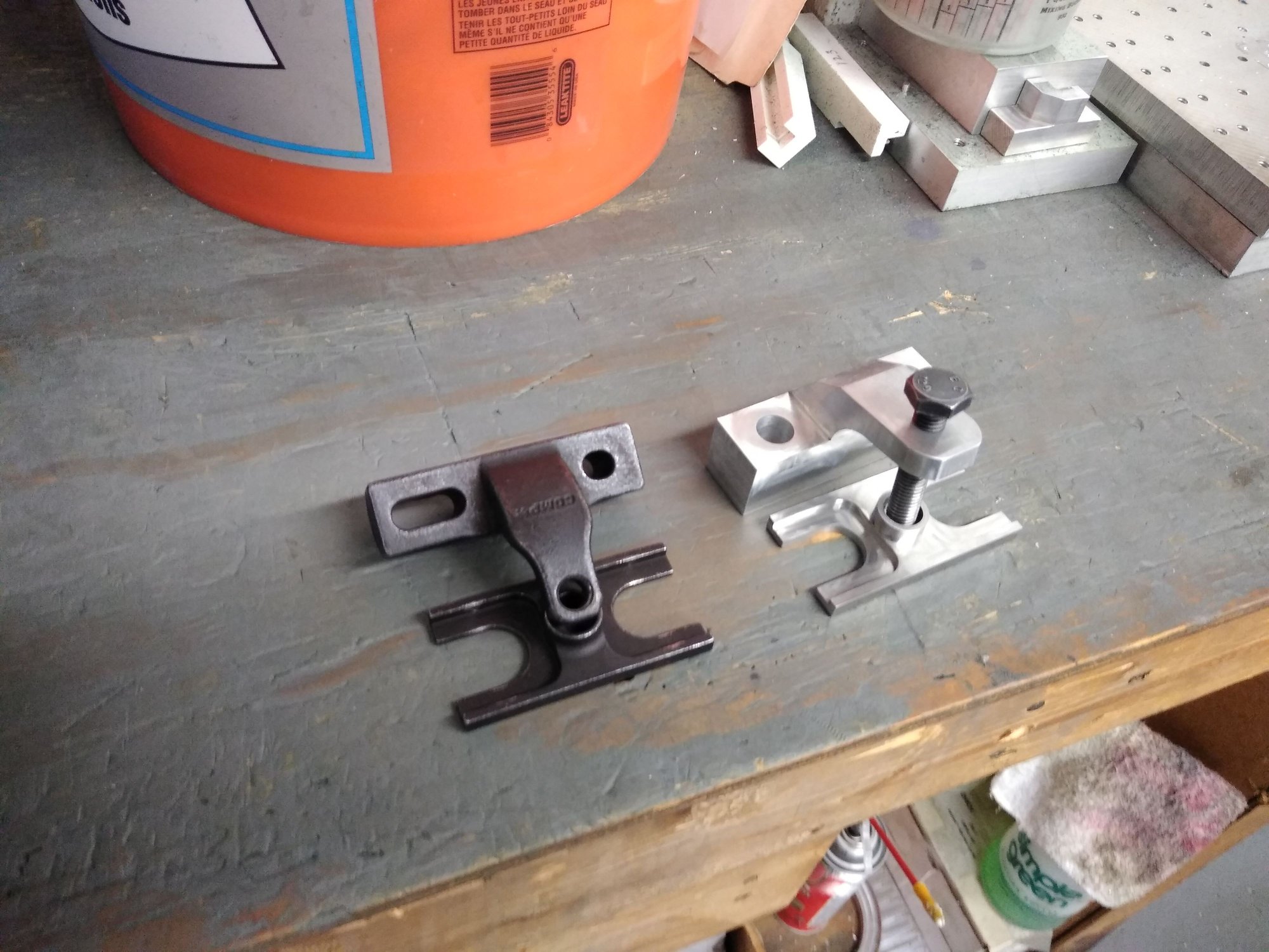

Originally Posted by myltwon
I like the added safety of a dual coil spring, but traditional spring compressors don't work with a **** on them unless the motor is out of the car.
The exploding wallet $ Crane valve spring tool is plug & play with motor in car. There is/was a "clone" of it on ebay IIRC "Tims Tool"
Old Feb 27, 2020 | 01:18 PM
  #33
myltwon's Avatar
Joined: Jul 2004
Posts: 2,965
Likes: 7
From: Palm Harbor, FL
Yeah I borrowed my friend's then made my own based off of it.
Old Feb 27, 2020 | 10:42 PM
  #34
Ruken's Avatar
Joined: Jun 2015
Posts: 246
From: Avon, IN
Nice, I made one similar. Not as nice as yours but its functional. And works a crap ton better on dual valve springs then that cheap crap you get at the parts stores.

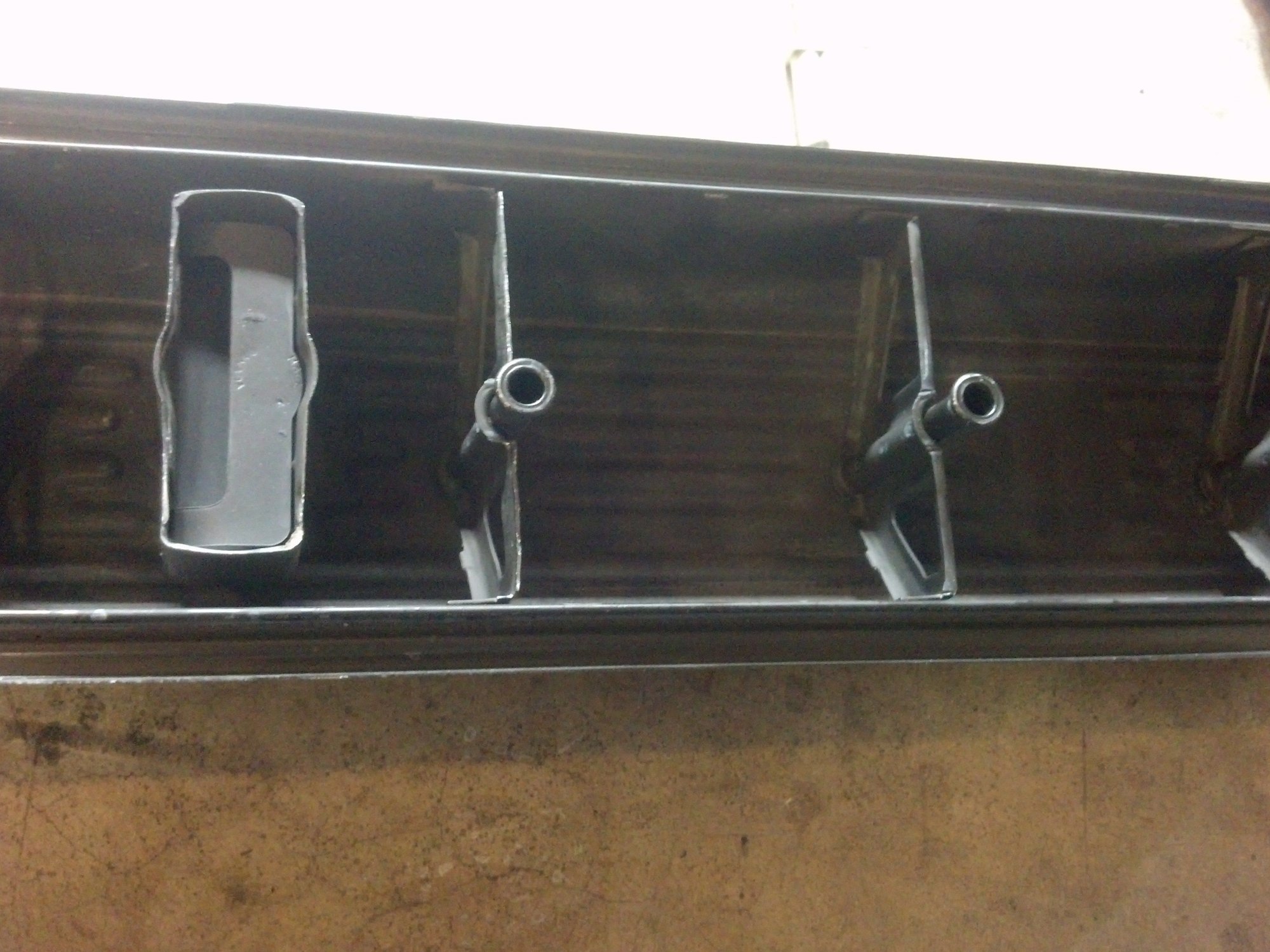

maybe your chrome ones will be fine. It's not the height, its the webbing at each center bolt hole
On stock VC you just Dremal off as shown in pic on intake side of VC
I was able to cut even less off with my Comp Pro Magnums. I could swear I'd already posted this.
The one on the left is trimmed, the rest of the trusses are untouched. I felt this was a good way to keep adequate tension on the VC gasket.
Old Mar 19, 2020 | 10:02 AM
  #37
SS RRR's Avatar
Village Troll
Joined: Oct 2002
Posts: 11,111
Likes: 596
From: Jackstandican
I've always used a pair of vice grips and straightened out the lip instead of cutting the support.
Old Mar 19, 2020 | 10:13 AM
  #38
Supercharged111's Avatar
Joined: Dec 2015
Posts: 930
Likes: 152
From: MI
Well ****, that's an even better way to do it.
Old Mar 19, 2020 | 10:27 AM
  #39
SS RRR's Avatar
Village Troll
Joined: Oct 2002
Posts: 11,111
Likes: 596
From: Jackstandican
Just know that in doing so the tubes connected to the supports for the VC bolts may become distorted and not line up with bolt holes in the head, however not far off the mark. Takes a little bit of fandangling to get them bolted onto the head.
Old Mar 19, 2020 | 10:29 AM
  #40
Joined: Dec 2015
Posts: 930
Likes: 152
From: MI
Hadn't thought about that. Cutting them didn't skew the tubes any FWIW. I used a Dremel cutoff wheel.
