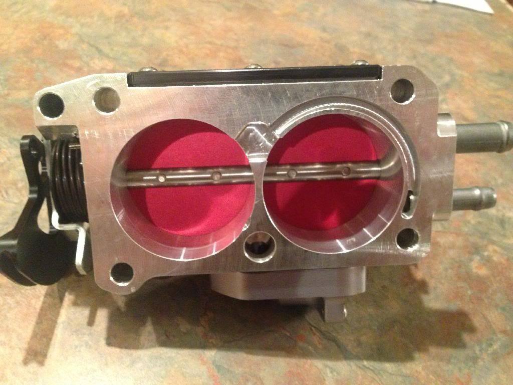

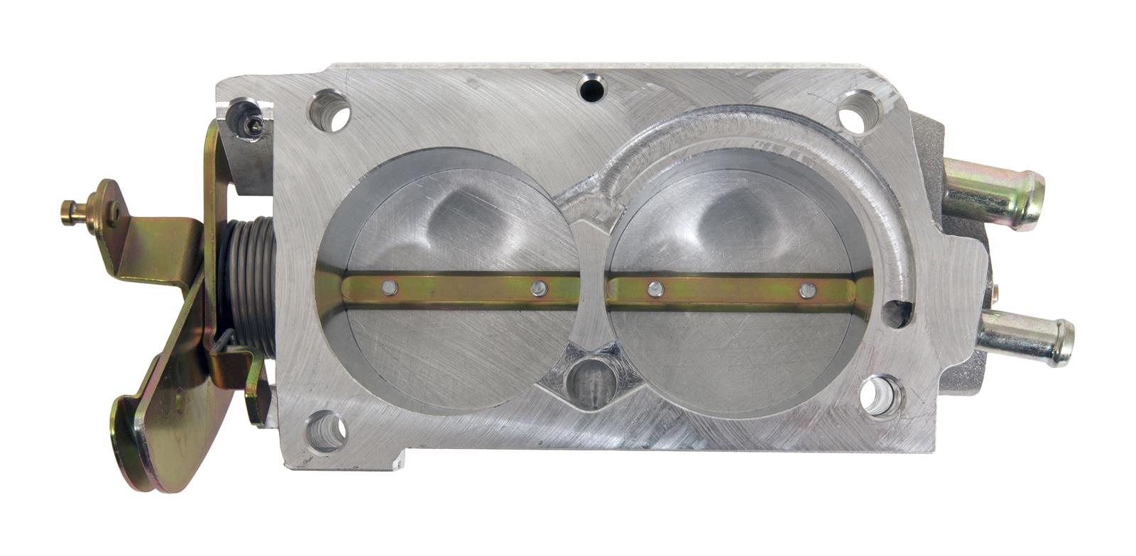

Notice how the IAC passages are on this Holley vs BBK. The BBK IAC is connected directly to the plenum while the Holley is sealed off like stock. The BBK style is more likely to give you split BLMs.
Downside of the Holley is that there is no stopper and pushing the gas pedal all the way down will put the TPS voltage out of bounds. I have one and had to make a stopper to prevent it from opening beyond 100%.

Good pictures. Thank You.
It's odd Holley doesn't have a stop...it's actually quite stupid if you can potentially damage your TPS with no mechanical hard stop.
Is that shared passage with the plenum the reason I read people inserting a brass tube to seal that area off? And or enlarging the hole by small increments after looking at IAC counts?

Yeah, it was pretty annoying too because it would send the TPS to 5v+ and throw a code at WOT. And yes, that's why people insert a brass tube or make inserts to separate the IAC passages from the plenum. Some throttle bodies can also be used for L98s which don't have dedicated IAC ports like the LT1.
I had to drill up to the next size with my Holley to get enough idle air with my h/c 383. You can crack the throttle blades open rather doing this but it will only make idle splits worse. I managed to get the Holley to close/open without sticking by doing some light filing to the butterfly edges and careful assembly. It was a lot more work than I anticipated for something that costs over $400 but it did reduce my idle split down to about 8-10 units although there's still room for improvement.
My BBK has a sealed IAC passage, but I've had it for a number of years. In any case, regardless of brand, it's an undesirable design feature.

I don't think I was clear. There should be an IAC passage for sure, but there should also be a hole in the indention on the bottom center of the TB that goes through the TB front to back. i just don't remember the diameter. It is critical you do not oversize that hole or it could lead to idle issues.

Understood. I agree with the small hole inside the passage. My clarification is with the need for the additional milling joining the IAC hole with both TB holes:
Sealed passage (preferred?? drilling hole may be required)
Additional milling (not preferred and needs brass tube insert?? drilling hole may be required)

I don't think so. I don't think mine is:
Not my pic.
If I'm not mistaken, the IAC hole seats with a port on the manifold that is then plumbed to each intake runner. Not 100% positive on that.
