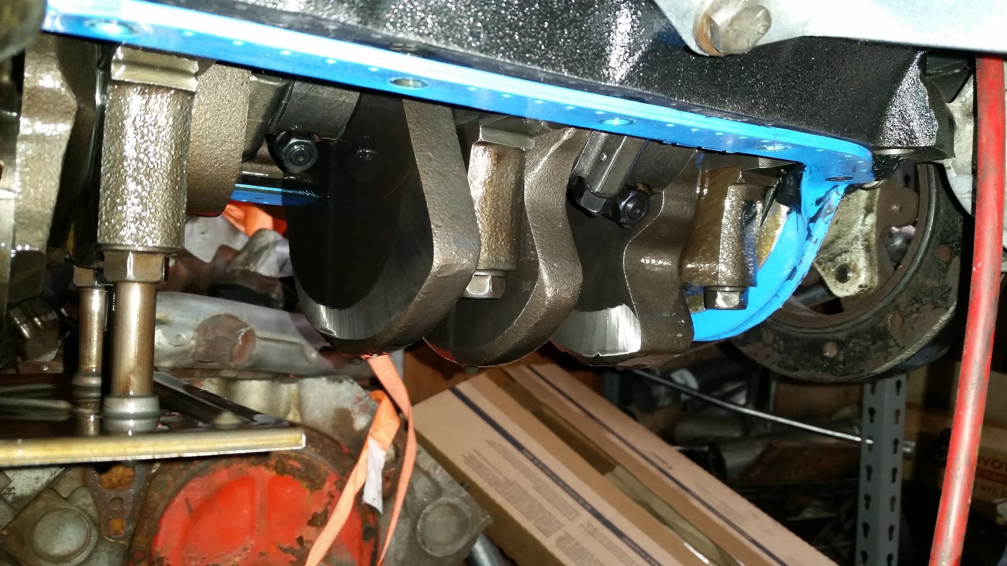

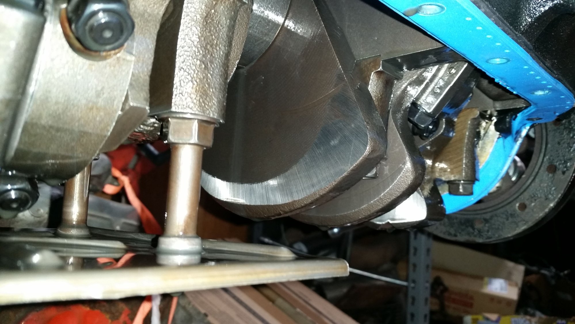

Got the engine on the stand and atleast got the pan off to take a look at the bottom end. The engine was even still warm from running it about two hours before. Lol. Is the crank supposed to look like this? This looks mighty fresh to me and would explain why the oil looks like candy paint. Also I did notice the noise changed pitch as I put the clutch in and out. So what's yall's diagnosis? Thrust bearings?

Rotatng the engine over by hand leads me to believe this may be normal. I don't see anything it could contact. Tomorrow night I'll pull it down to the bare short block and have a closer look.

Were those makes on the counterweights when the engine was built?
And judging by the fact that the noise went away when you pushed the clutch in, I would guess thrust bearings.

I honestly can't' remember if those mark were there or not.

You're talking about the crank counter weights? Pretty sure those are there from when the rotating assy. was balanced? As far as the cam bearing, it's possible it was not installed properly and/or oil starved.
