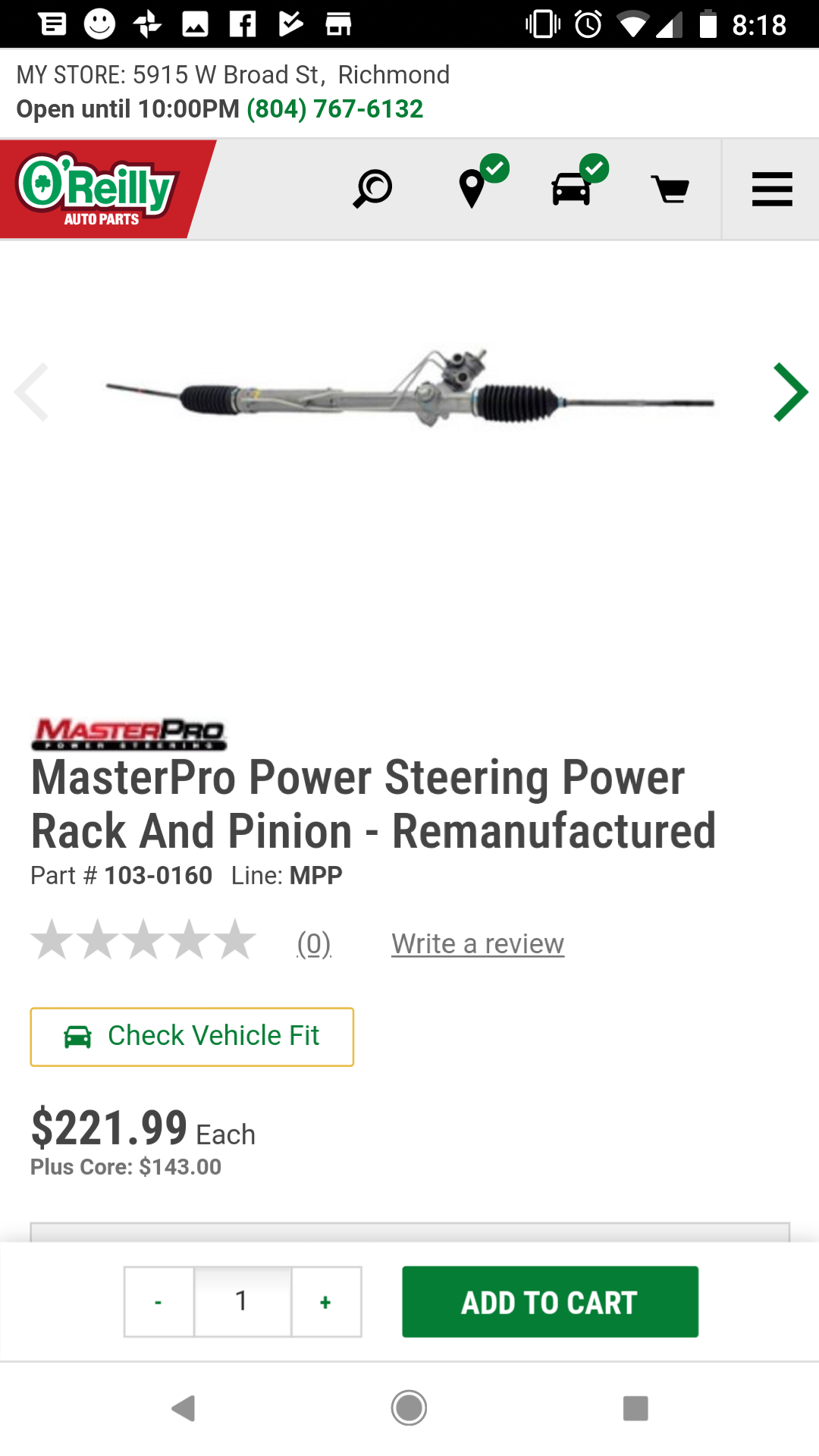

This is the part installed the angle looks like it's for a V8 but I cannot be sure because my car isn't driving yet LOL
Thank you all! I bought this one: https://www.oreillyauto.com/detail/b/masterpro-power-steering-4355/suspension---steering-16778/power-steering-16478/rack---pinion-complete-unit-12584/8d7b332a633f/masterpro-power-steering-power-rack-and-pinion-remanufactured/1030160/4507534/2000/chevrolet/camaro?q=Rack+&pos=1.
Idk if it's a V8 or V6 tho.

I set my vehicle to a 1996 Z28 and clicked on the same brand.....the part number below the name is 103-0134 vs 103-0160...so I think they are different. Have a look at this...
https://ls1tech.com/forums/lt1-lt4-m...nion-swap.html
Post #6 shows you a good picture of the angle difference between the two...but it appears that you may can use it, if you don't have headers that interfere with it.

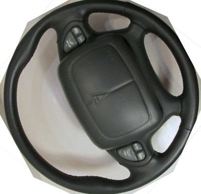

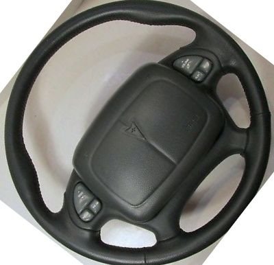

I just had the steering rack in my 1997 Formula replaced due to leaks beyond repair. I ended up with that same part number for 103-0134 (for 93-97) which specifies 2 5/16 turns lock-to-lock, same as the 103-0160 for 98+. However, for some reason, feels like I have to steer more to get the same steering angle as before (moving the wheel further left or right).
I no longer have my original steering rack cause they needed it for the core charge refund.
Should I have gone with a different brand or part number? Or do I live with it and eventually get used to it?
Old rack (steer all the way left)
New rack (steer all the way left)
