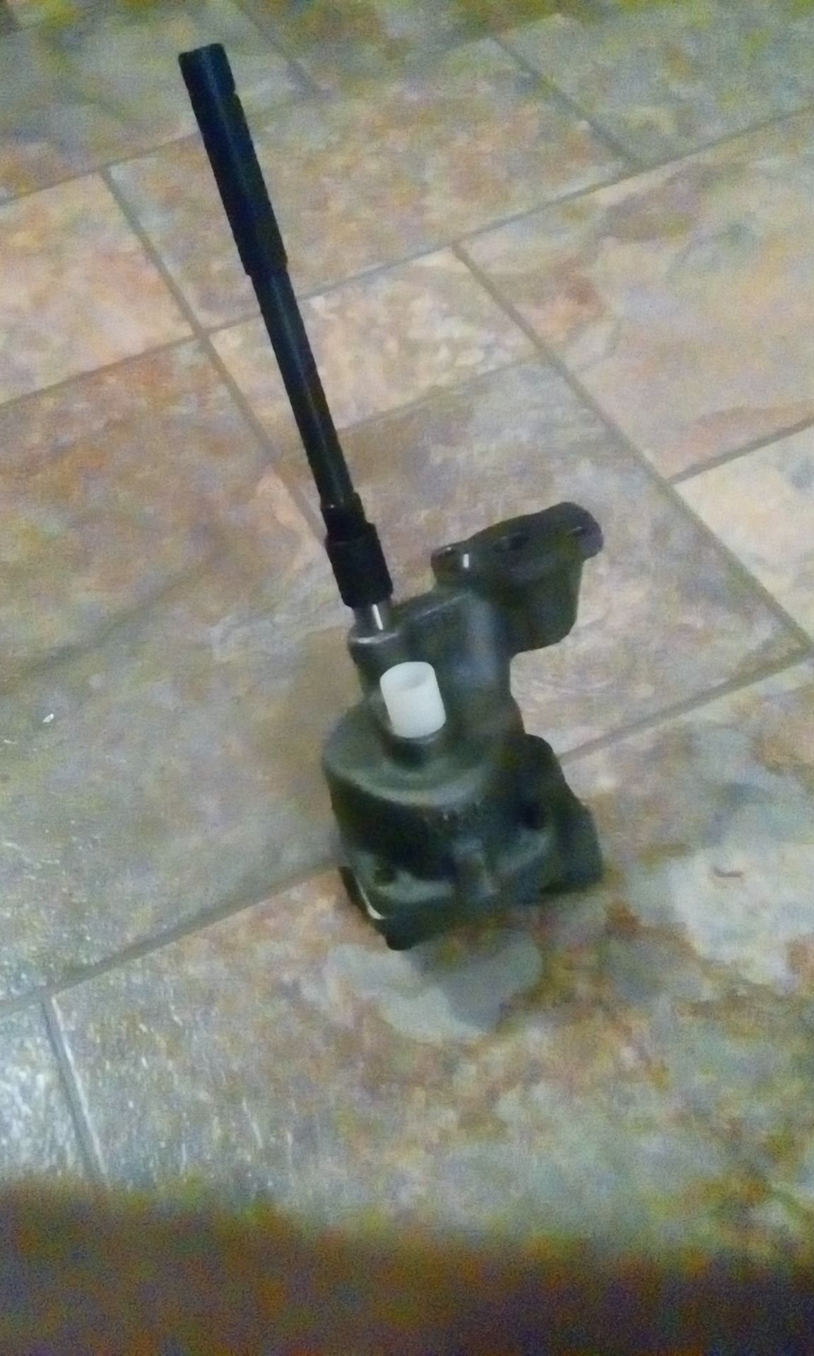

Okay guys my theory with my engine the lt1 oil pump gear drive lost all the teeth and the metal got into the rear main bearing and spun putting a groove in my block, cap, and fusing my bearing to the crank. Now before you go after me I made a bad trade on this car it was not running and I thought opti because it would turn over at times and not fire, so I found the oil pump is a melling m55hv oil pump and from everyone's experience and research the gear drives do not like high volume oil pumps, I'm building a new engine for the car I ordered a forged 383 stroker short block and I'm buying all new parts to put it together. Here are my questions. I bought a melling m55 standard to go back in so there will be no added stress to the gear drive.
1. The nylon bushing that came with my m55 is it needed and where does it go?
I can see a nylon bushing on my m55hv but the shaft seems to be the same diameter all the way up my new m55 has a female adapter end that is larger than the shaft.
2. Do I need a oil pump gasket because I don't believe my kit came with a gasket. If so what does it look like or could someone please point me to a part number. I'm thinking this is a stupid question because I'm leaning towards it needing a o ring seal or a gasket but would love the confirmation.
Thank you to any and all advice ahead of time it is much appreciated.
I have attached two pics the m55hv(old) in the fine China plastic plate and my new m55.
The m55hv old
New m55

The oil pump drive gear on the cam was eaten up? If so, that's not necessarily due to the HV pump. Loads of us are running them with zero issues. Just make sure you have the proper drive-gear on the cam and you'll be fine. I'd wager a guess that your M55HV is just fine. Pull it apart and check... That said, your new pump came with the proper drive shaft with a steel retaining collar in place of the nylon one. You also do not need a gasket between the pump and the main-cap. Make sure you set the proper pickup depth in your install.

You can fashion your own metal hold-down tab if you want, but a fat washer that's ground for clearance against the block will work fine too. What most people do is over-torque the plastic housing which causes them to crack and fail. There are lots of folks spinning a properly balanced LT1 well beyond 6200. Regarding the gear on the cam, tell whoever is grinding the cam for you that you want the hardened oil pump gear. I know Comp and Bullet will accommodate this request. I think all of Comp's gears are hardened, but I could be wrong....

You won't. If standard bearing clearances are used then a standard volume pump is all you need. However for higher RPM a high pressure spring can be used. There are pumps that already have this feature, but I can't remember which one. Something worth looking into.

If we are talking about the gear that is held on with one small bolt under intake manifold that went bad, new replacements are available for about $75-$80 at dealership parts counter. Maybe cheaper elsewhere. That gear mesh is to the cam gear which ideally is a "melonized" gear. Billet cam gears can wear a stock factory oil pump drive gear
"Often" 383 builds are made with "slightly" wider bearing clearances typically with a cam combination that will see higher than stock RPM operating conditions (6k+ RPM) with the aftermarket tune it has. In these motors a HV oil pump is advised. Pic below is a 90+k mi stock oil pump gear in my 383. No wear issues due to a HV pump.
Motors with stock bearing clearances should not run a HV pump, just install a "high pressure" spring in a standard volume pump
On the oil pump drive gear the top is plastic and aged it gets more brittle than when new and can easily crack if to much TQ is put on the small bolt. Even stock TQ can crack a old gear assembly so just hand tight and use some blue loc tite. You can also use a larger flat washer under the small bolt head to distribute the load more over the plastic top. There are metal "caps" I have seen for these oil pump drive gears that will also help.
Get a one piece oil pump drive shaft if the oil pump does not come with one. The plastic collar on the stock drive shaft gets brittle with age and on re-install can crack (and you can't see that when you install it easily) and when it breaks..no more oil pressure. ARP and Miloden make them for around $10

My recommendation:
Melling Select 10554 pump (std vol, 3/4" inlet. Should come with Melling IS-55E shaft with metal coupler and 70# pink spring). If it does not come with the shaft, get one. Not expensive. Don't use the plastic/nylon coupler on the shaft. The pic of your M55 pump looks like it has the shaft with metal coupler, so may not be needed. The select series pumps have a stronger casting than the regular M series that have been somewhat prone to cracking.
