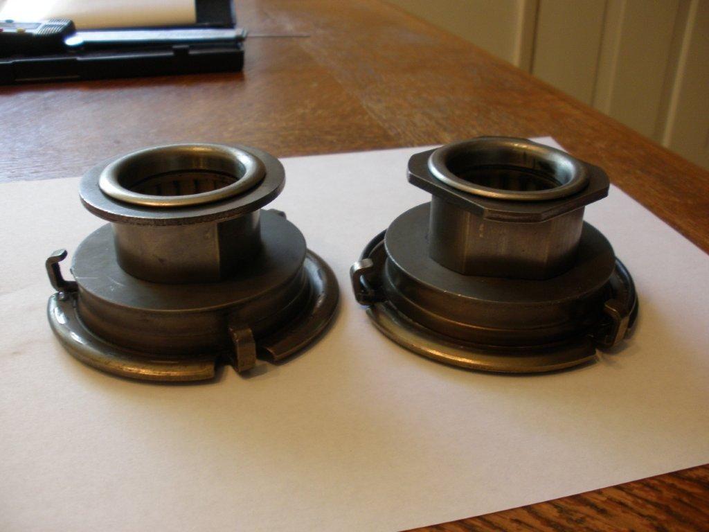

well in attempting to add pics to my response it wiped out 2 and all the text
so the "LT4" TO bearing is a square top one which is thicker than the LT1 and has a square shaft the fork goes on vs the round one with one pointed side the LT1 has

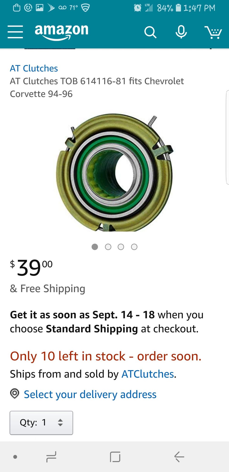

I see spec sells them for $82. Or i could buy that lt4 for $39?

if it has the thicker "square" top that is the one to get

The centerforce N1401 is for a 94-96 vette. It is squared, this matches the one in your pic. This will work on a 96 z28?

Yes it will work in your 96Z
https://www.jegs.com/i/Centerforce/183/N1401/10002/-1
I have the square top in my 96 Impala
