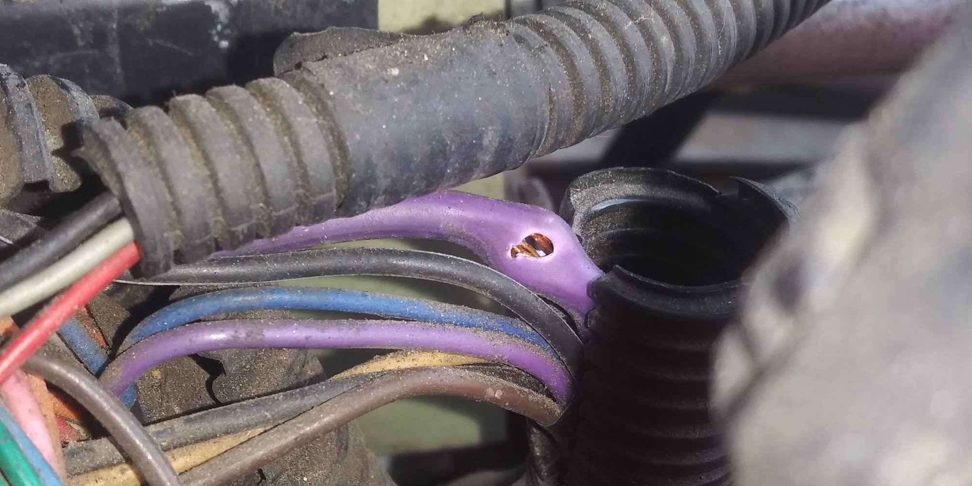

So I was looking at wires near the pcm and bam look what I stumble upon. What you guys think ?

Hard to say. A schematic may help you figure out what that's to. Could be someone trying to tap that wire for a signal or power. I do know there is a purple wire that goes to the starter solenoid. Maybe some sort of remote start bullshit. Who knows....
Your right it does lead to the starter. But there is another purple wire that also leads to the starter as well. Because besides the long cranks it still start so I don't think it's affecting that component, I could be wrong thought.
