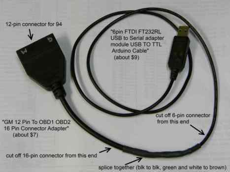

Is there any difference between a OBD2 connection to USB for a 1995 LT1 Camaro vs one for a 96-97 or newer? I know my 95 is OBD1 but has the OBD2 connector. Are the outputs for each pin different than the actual OBD2 cars?

OBD-II has an additional connection on pin 2 of the DLC, otherwise the same.
http://shbox.com/1/DLC_wiring.jpg

95 has a obd2 style connector but its obd1. if your trying to read codes or datalog/you have to make or buy a cable and use a program like scan9495.
