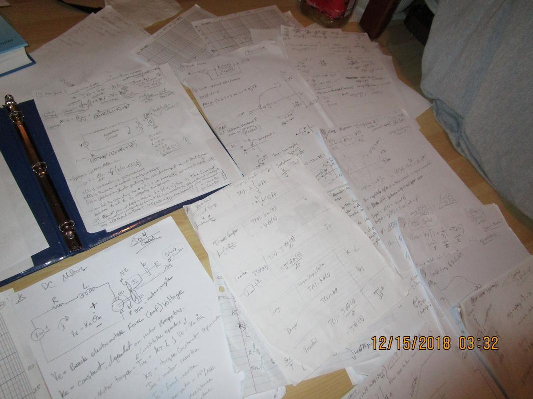

there are (perhaps hundreds) of models on the internet:
https://www.mathworks.com/videos/mod...ain-68822.html
If you sit down with paper to create a model of something simple it can be dramatic:
To actually "do" anything rapidly enough you will want to simulate a model using a computer, and adjust variables over time under various conditions.
In a controls course we created equation like above and used it to simulate several different electrical motors, then measured their frequency response and other details while adjusting it to be more comparable to a real electric motor we also had to measure from. The simulation can come very close to the real thing and then by examining phase and amplitude (Bode plot will show peak resonance and other behaviors) it becomes possible to dampen or accentuate the response of a dynamical system, by controlling it to fall within that range. For example my professor had an electric jellyfish and there was a peak resonance at some specific operating frequency, so they programmed a micocontroller to keep it operating in that range to take advantage of the additional energy that was available to move the robot. They were only able to find that peak area because of the simulation model though. For example if you design a whole car without these models it will have all kinds of vibration issues to deal with, and not just in the engine/drivetrain, there are resonances in any dynamic system such as exhaust/intake gas flow which is how engineers choose runner length in intake manifolds and header length for racing at specific operating frequencies (rpm) without empirical testing (but it still usually requires testing and re-evaluation, its just the first test is much closer to 'finished' hopefully)
Engines are remarkably simple compared to most other machines I've glimpsed. Even if knowing everything about engines seems like it will be insignificant and practically useless in the vast majority of other machine encounters. Even an airplane seems basic, I would switch to them because its just a light car with wings.
