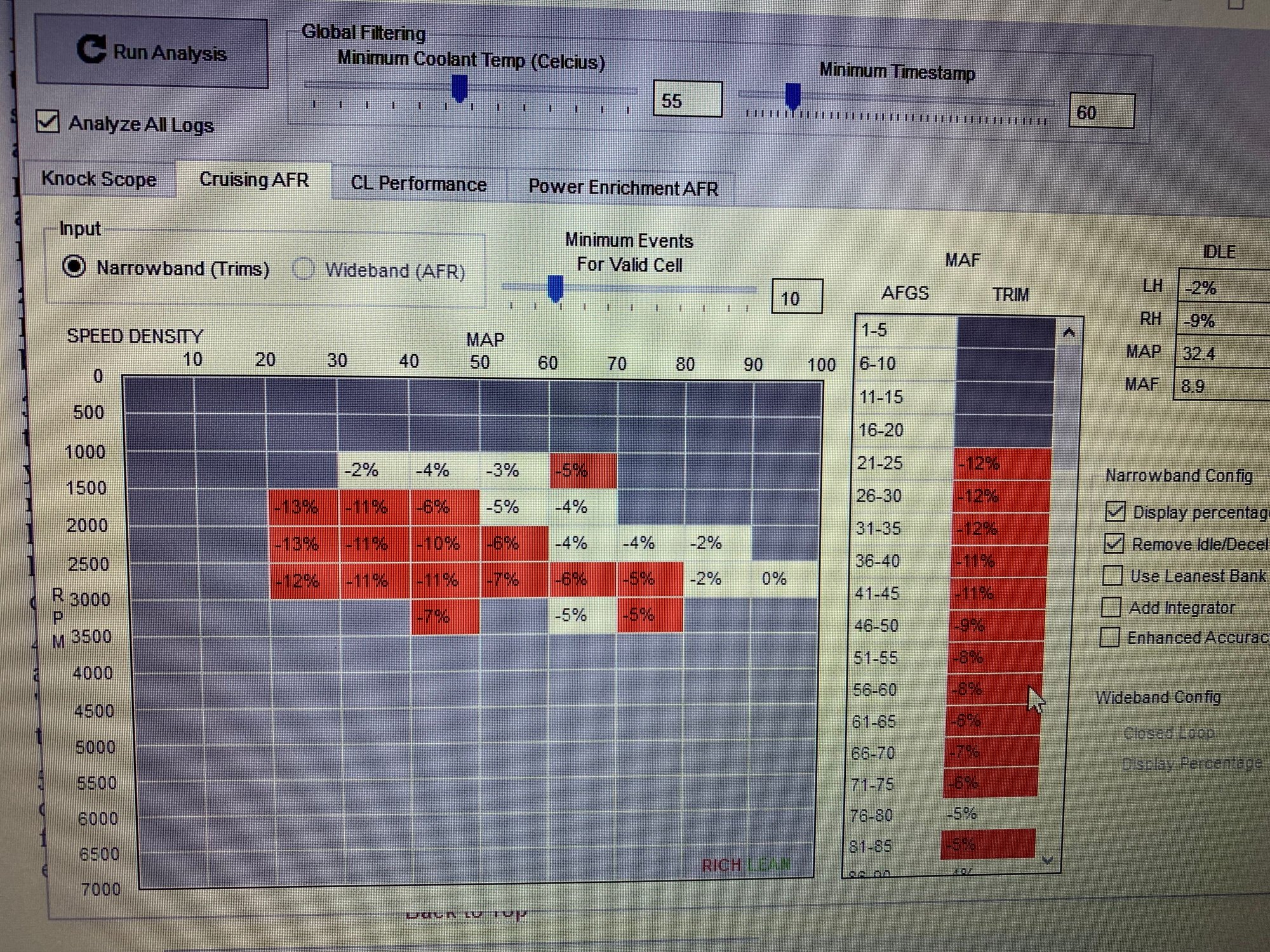

EEHack says it runs rich. Tuner on here says my bin is not accounting for the after market ram air for the MAF

BLM Cells 3 and 7 are very rich and need to be tuned . Do you have a copy of your tune that you can attach?

adjusted your MAF in the tune to clean up the Rich conditions from the log you posted. Flash this tune and then log again and post the new log file.

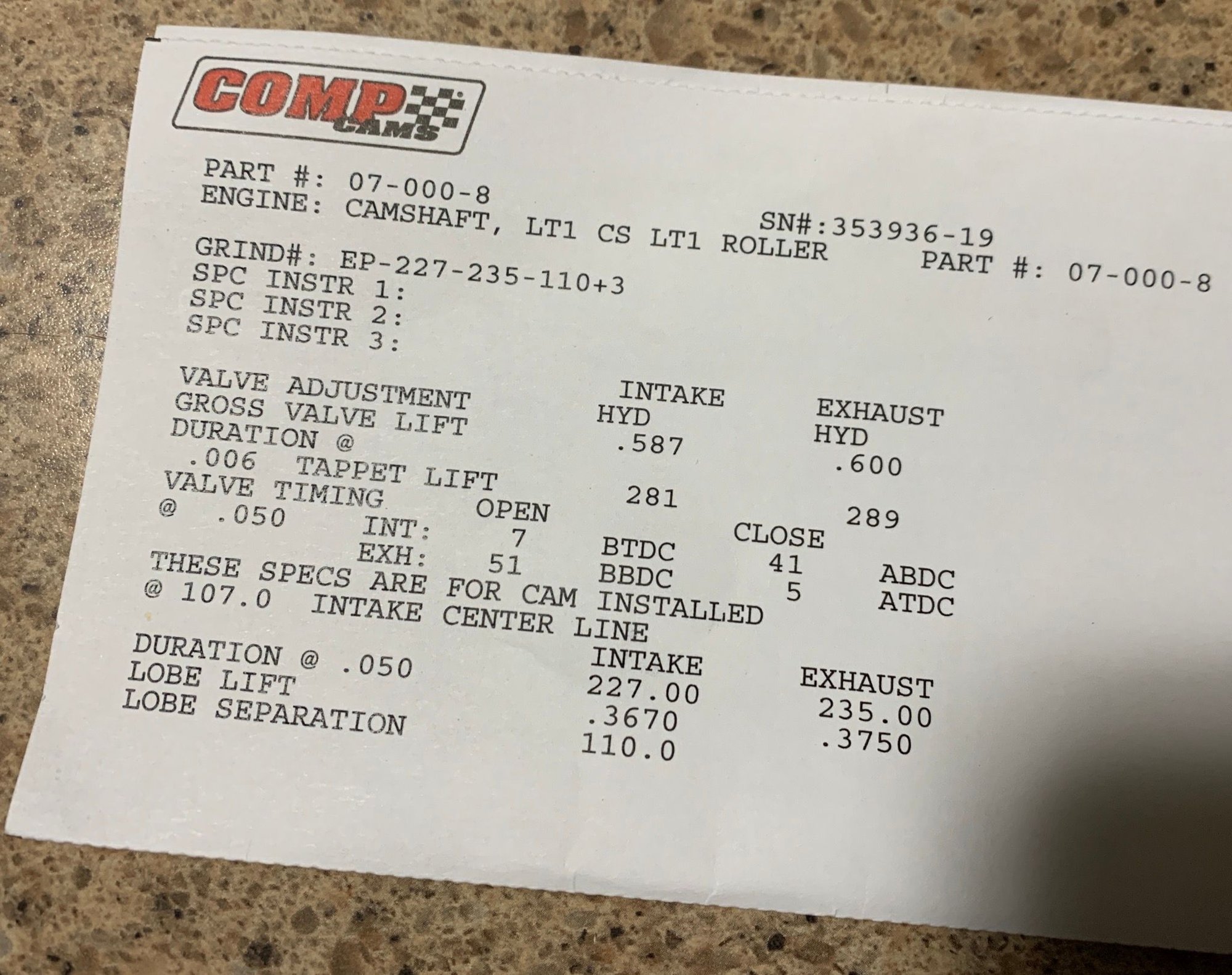

Forgot to mention also have a new cam from LE with 1.52 RR. Does anyone know why so much fuel is being dumped so quickly? Still waiting on one of my retunes from my tuner...
