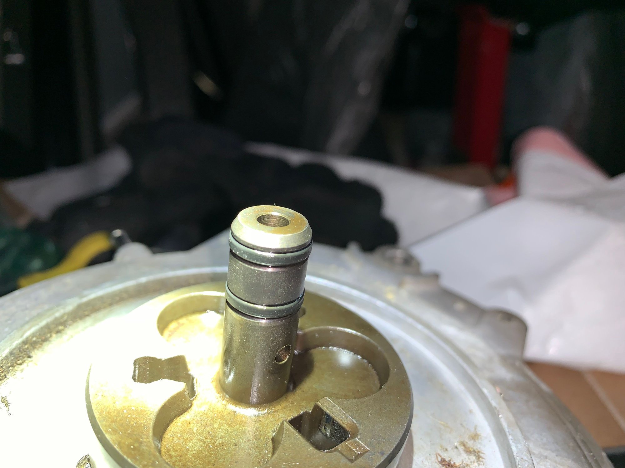

Shaft is solid. O rings appear to be made of metal. They are squared off and solid. Got a new kit on the way, the rockauto one you linked *****. Thanks! Got some locktite blue for the bolts too.
Old Sep 6, 2019 | 10:03 AM
BALLSS's Avatar
Joined: Apr 2008
Posts: 4,985
Likes: 113
Unless you can find new O rings for the shaft, leave those alone. Yeah they are flattened but they are not broken. They don't seal anything, just "stabilize" the shaft in the cam
